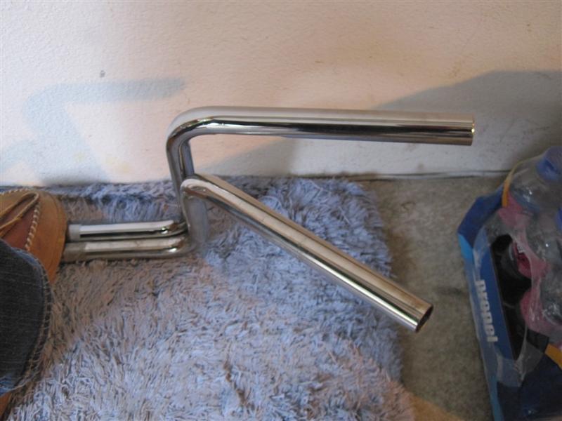

I finally got some Klock Werks Ergo Up bars installed. When I was contemplating their purchase, I had always heard that they offer a more relaxed wrist position, but since that is not a standard bar measurement, I didn’t really know what that really meant. The purpose of this post is to try to help/show others out there who may also wonder about that.
Feel free to skip the discussion if you want (and just jump to the pics), however for some I thought that a thought “framework” may be useful.
My bar replacement priorities were:
1. Relax the wrist position (“tingling” or loss of circulation to finger tips after a while)
2. Raise the bars, (shoulder/neck strain after about 150 miles) but keep my hands below the fairing height
3. Bring them back a bit (~ ˝ “) just for comfort
Based on these things, I chose the Ergo Ups, hearing that they’d generally meet the relaxed and up (about 2”) and I assumed that I could just orient them back as desired – so far that’s worked out.
I concluded based on relative measurements (but with some “eyeballing” as well) that the stock bars on my Ultra had a wrist compression of about 3 ˝” over the useable length of the grip. I’m refraining from using the term “pull back” as that is a standard measurement that means something else. The first picture, with the red marks on my square shows how I measured – front of each end of the grip to the fairing reference.
The second picture is for reference of how I made the measurements from a different angle, and also shows my base line for height measurement – the mark on the painters tape that then lines up to the hole in the vertical of the square.
The third picture compares the Ergo Up (closest to wall) with the stock bars (front). Sorry no measurements here, I just couldn’t balance that much stuff.
The fourth picture shows the Ergo Ups installed. The red marks (stock) are still there for reference, and the black marks show the relative position of the bars/grips. You can see that I pulled the bars back ˝” as desired. My take is that the Ergo Ups’ wrist compression is about 1” over the useable length of the grip, so “relaxing my grip” by about 2 ˝” as compared to stock. On the vertical scale, you’ll see that they raised the bar position about 1 ˝” from the stock position – I knowingly sacrificed some height to get the ˝” pull back.
On the pictures, if someone can make them appear in the post rather than as thumbnails, it may be easier for others; I just don’t know how to do that…Thanks.
FWIW, I did not need to change any cables. Throttle and brake were fine as they were (re-shaped the brake line carefully a bit). The clutch cable may have been OK through the fairing, but I was more comfortable re-routing it as a precautionary measure, but it’s still stock length. It’s now routed below the radio (similar to the brake line on the other side).
I can’t provide a ride report yet – I still need to make some final tweaks and tightening then put the fairing back on, but I thought I’d send this info out in advance of that. I intend to get a few hundred miles in this weekend if the weather isn’t too terrible, and will follow up with those who may subscribe.
Finally (for now), if you like these bars, I suggest you be very patient. Based on my experience, it seems to me like the MO for the vendor is to not to have anything in stock (to any of their distributors as well), then they order some from the manufacturer to fill most back orders, then they’re NIS (not in stock) again for several months. This makes for a 3-4 month desire-to-delivery timeframe.
Attached Thumbnails Ergo Up, reference pics-img_3524-medium-.jpg   Ergo Up, reference pics-img_3526-medium-.jpg   Ergo Up, reference pics-img_3529-medium-.jpg   Ergo Up, reference pics-img_3531-medium-.jpg
