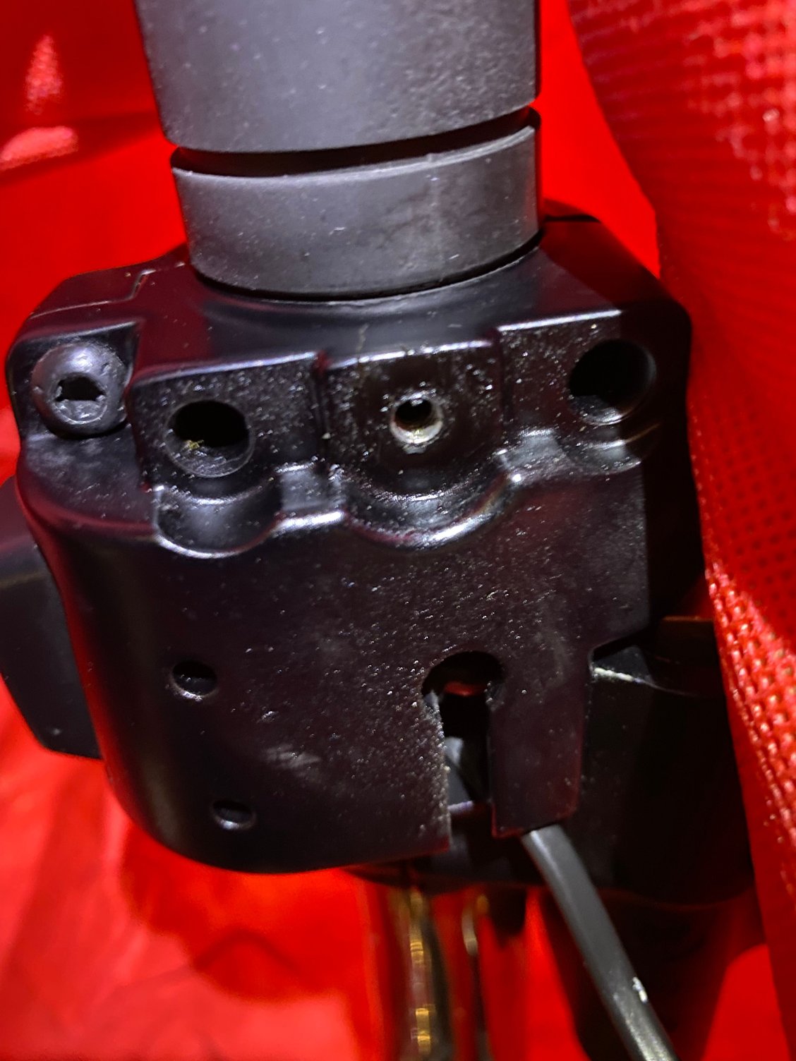

This is how it actually looks on my Fatboy 2016.

Looks like you have the correct hole for the screw, but I can't tell if it's threaded....
You could buy the parts for like $10.00, and see if they can work... but you may need to tap that hole...
