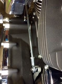

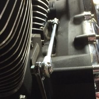

It looks like the 1/4" spacer is becoming a thing. I also did mine tonight after getting a set today from the local ACE.
This is what I used, Hillman P/N 943066:
An this is what it looks like installed:
With a nice improvement in the angle and alignment:
I might have considered using both 1/4" spacers if I could have found a 1/4' longer fastener but that was not readily available. This will be fine.
