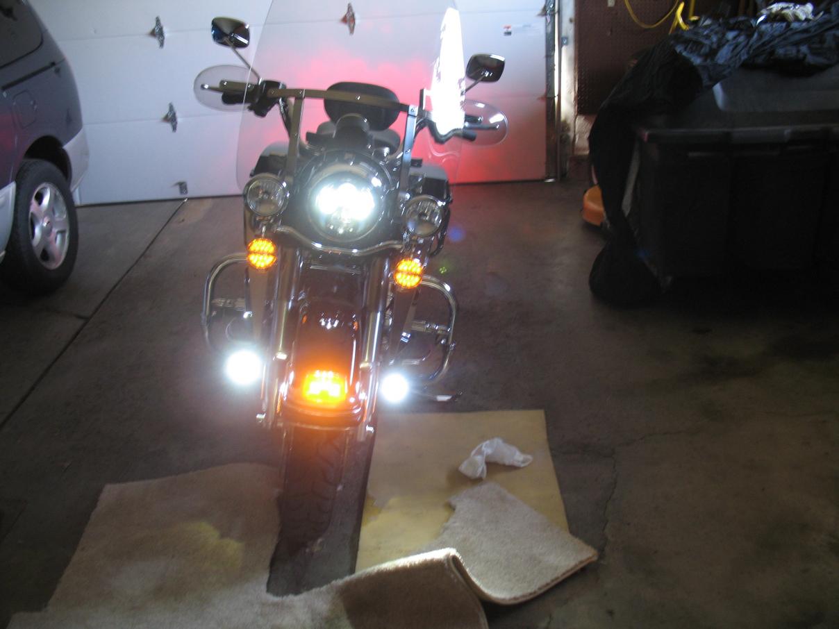

I have the caliper mounted moto lights and the HD LED set up. Yeah, there's a horizon there on turns and what not. But that's the only time I think about the fact that I'm on a bike at night....I simply no longer even think about not having good vision. And that's really huge. The horizontal beam never bothered me. Included is a pic with the motos with their LED's installed. No aux LED's when this pic was taken.
