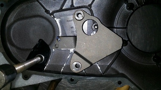

I added the Compensaver oiling tray to my 2014 SE compensator this winter. I also did the JIMS trapdoor to stiffen up the transmission. Hopefully this will be a bulletproof driveline setup for my 124" StreetGlide.

I'm wondering if anyone has lost a comp after installing a Compensaver oiling tray? If they have then its another crap shoot and more money spent hoping to be one of the ones that get lucky with it and not having to buy another Comp.
$129 is very temping, did you have to grind any of the primary cover inner fins like there pictures show?

yes

Not sure what CompenSaver your using? I see the web site:
http://www.compensaver.com/
That sell for $129.
And the GMR compensaver that for some reason I can't see the pictures, and theres is $399.
Are these the same thing?
Old May 14, 2014 | 08:08 AM
x1rider's Avatar
x1rider
Posts: 269
Likes: 5
The one I have is the cheaper one for the 2014 comps, the more expensive one is for the older comps and it includes more hardware. Mine is just an oiling tray.
