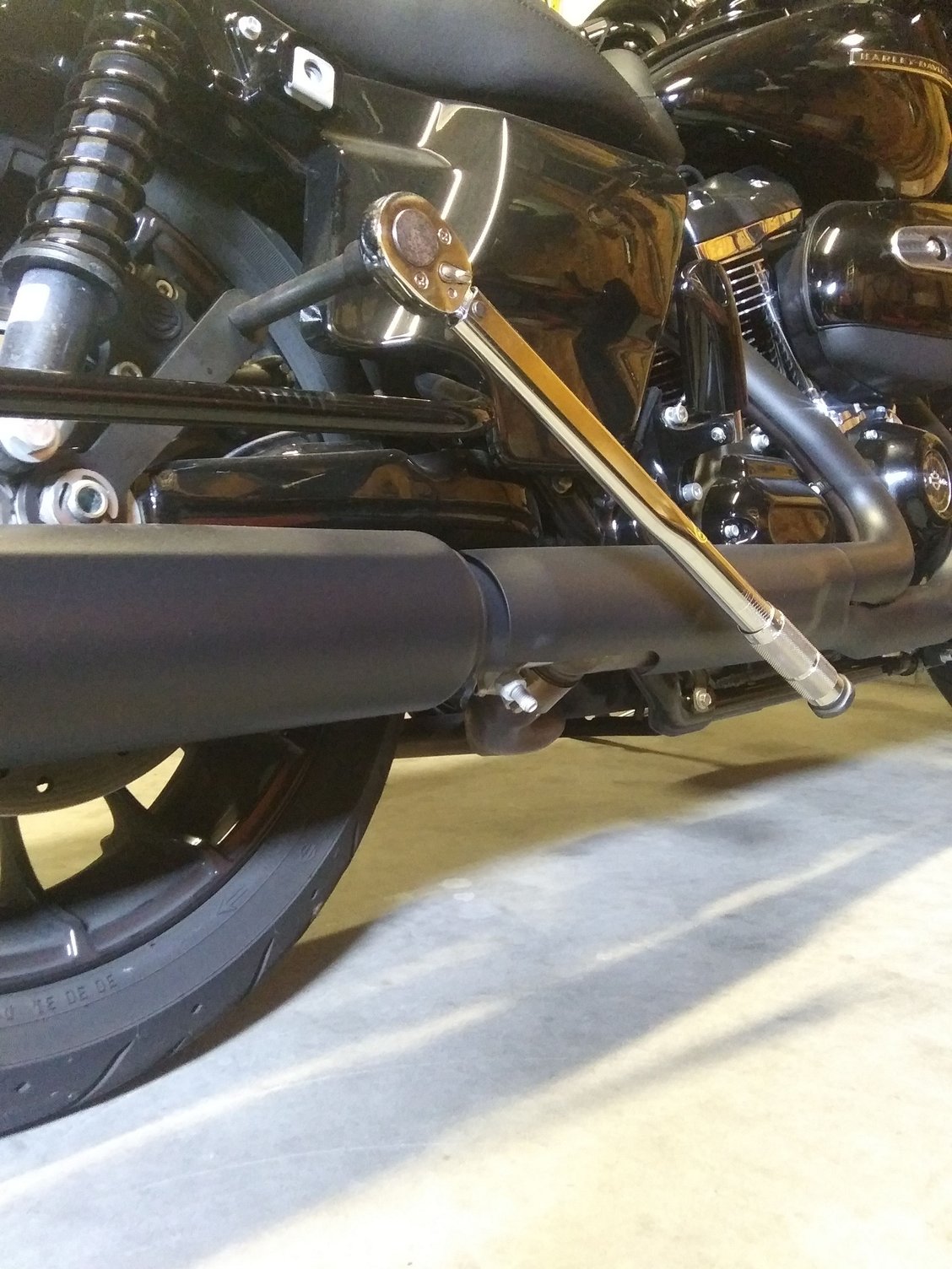

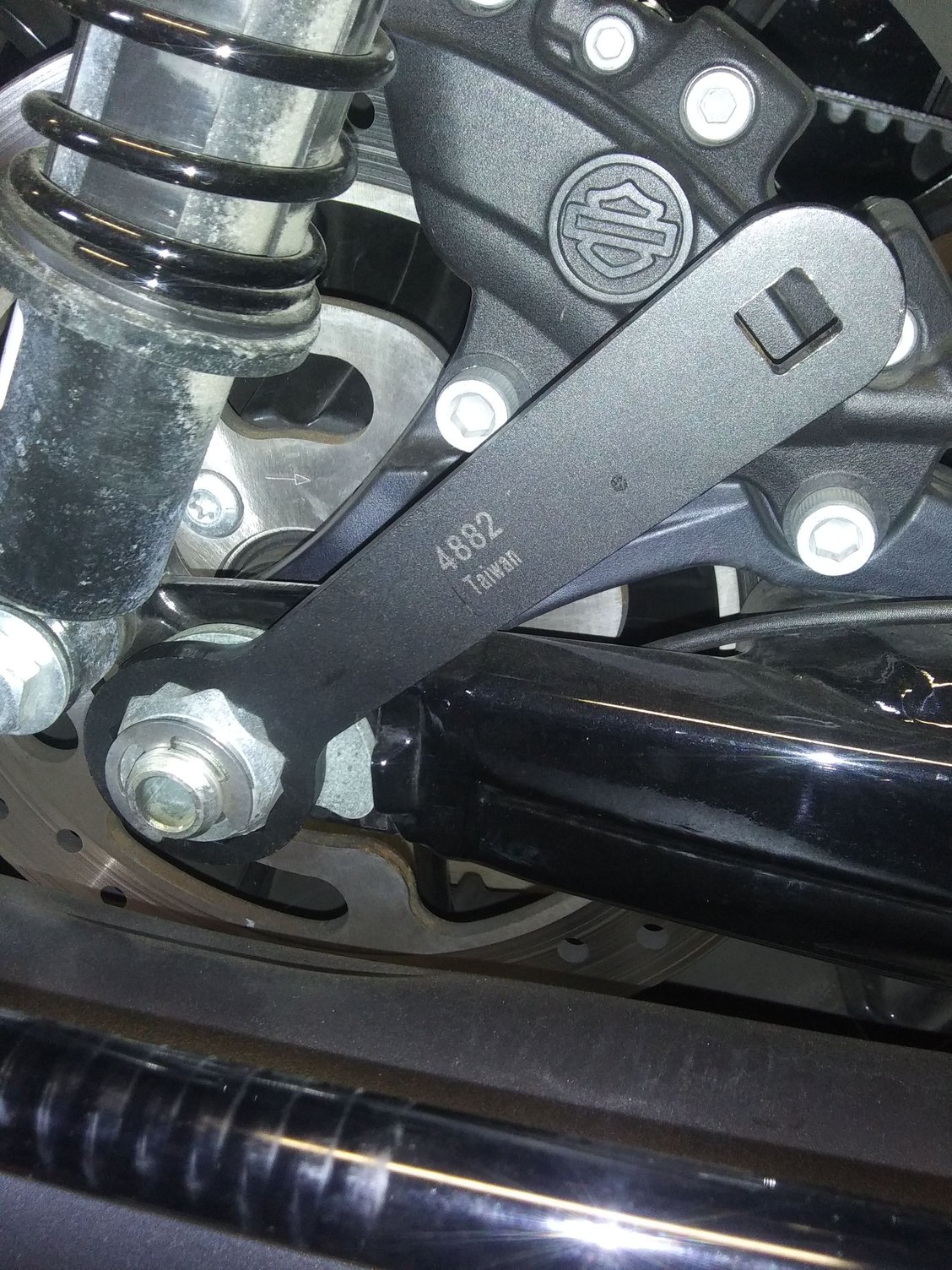

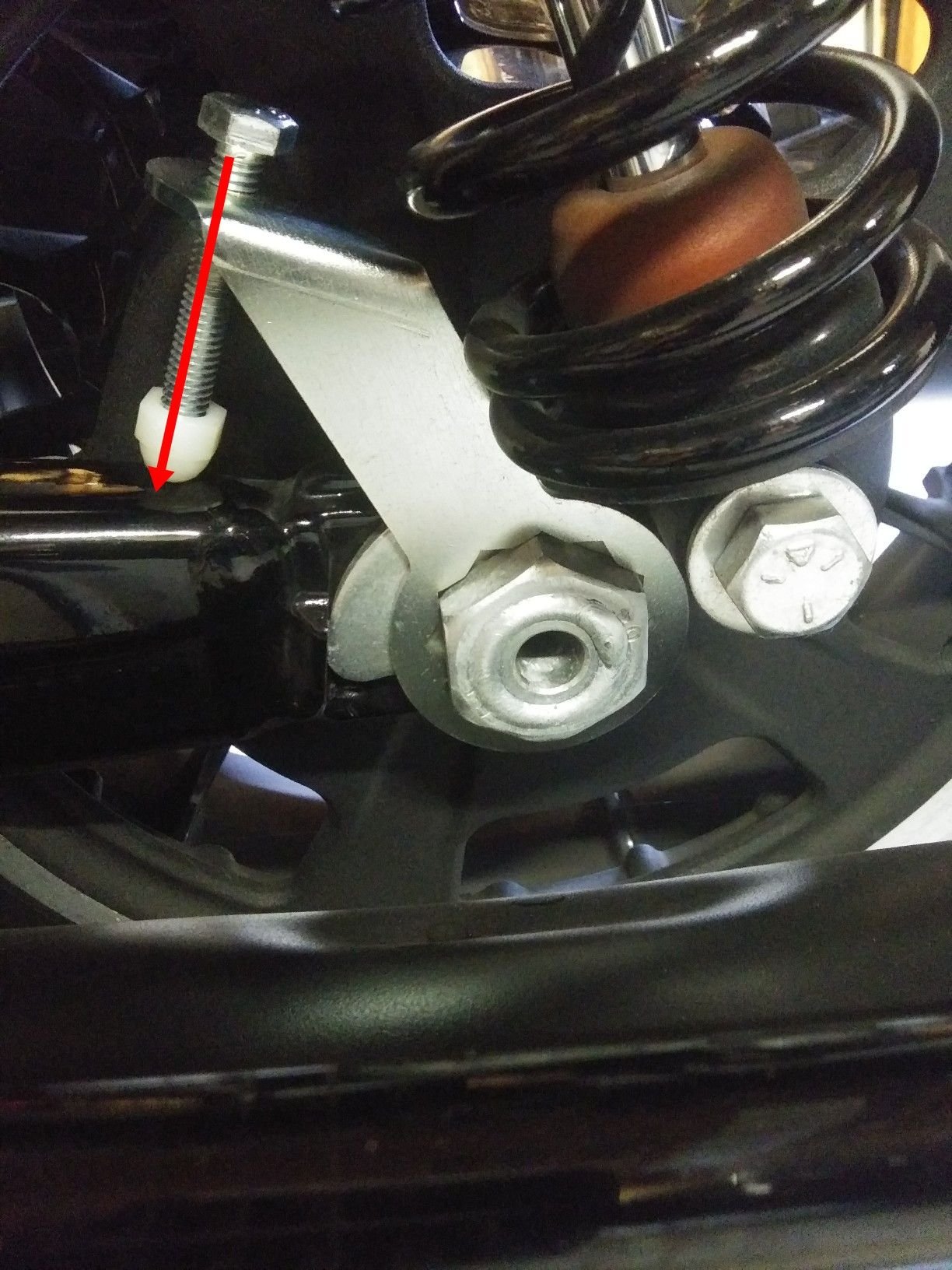

I use Jim's 3rd hand tool to hold the weld nut stationary.
A torque adapter on the cone nut will eliminate muffler removal.
Final torque is achieved while standing on the right side of the bike.
Helper stays in the kitchen making sandwiches.

Originally Posted by GregGillette
Looks to just slip over is all...no magic but maybe useful.
Yes, it fits over the weld nut the same way a 36MM 12 point box end wrench would. The "3rd hand" is the bolt that holds the tool, and weld nut stationary. The bolt is screwed down until the nylon acorn nut firmly contacts the top of the swingarm.
I was taught to use two hands on a torque wrench, one on the handle, the other supporting the head. The 3rd hand tool allows both hands to be used while torquing the cone nut. All from a comfortable standing position on the right side of the bike.
