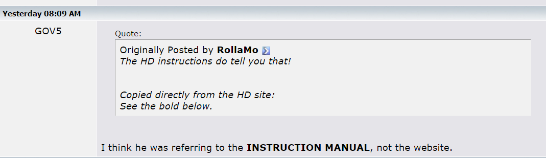

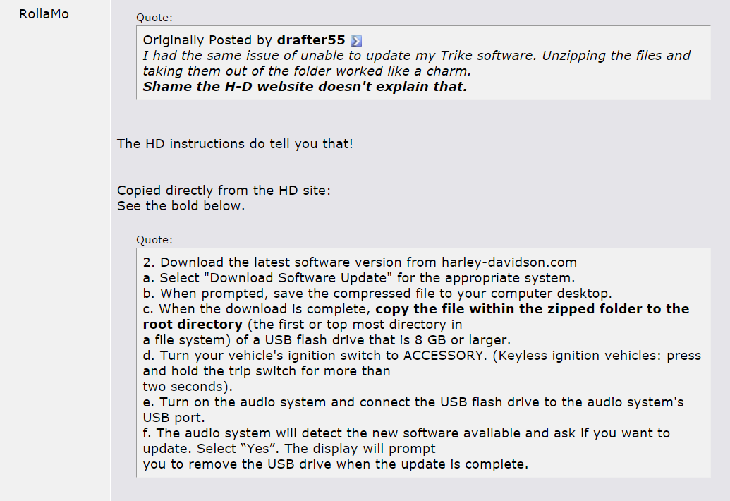

Originally Posted by GOV5
"I ran into a snag while trying to update my system AFTER I read the instructions in the owner's manual. "
This was the quote. Maybe YOU should learn how to read a little better too!
I stand by my statement. There's nothing wrong with my reading comprehension.
This was the post:
It very clearly says Shame the H-D website doesn't explain that.
And you respond:
You clearly didn't comprehend that post by RollaMo because the quote he was responding to was IN HIS POST. When the guy says "Shame the H-D website doesn't explain that." there's no way you could actually believe the post you made saying "I think he was referring to the instructional manual" unless you do have a reading comprehension problem.
