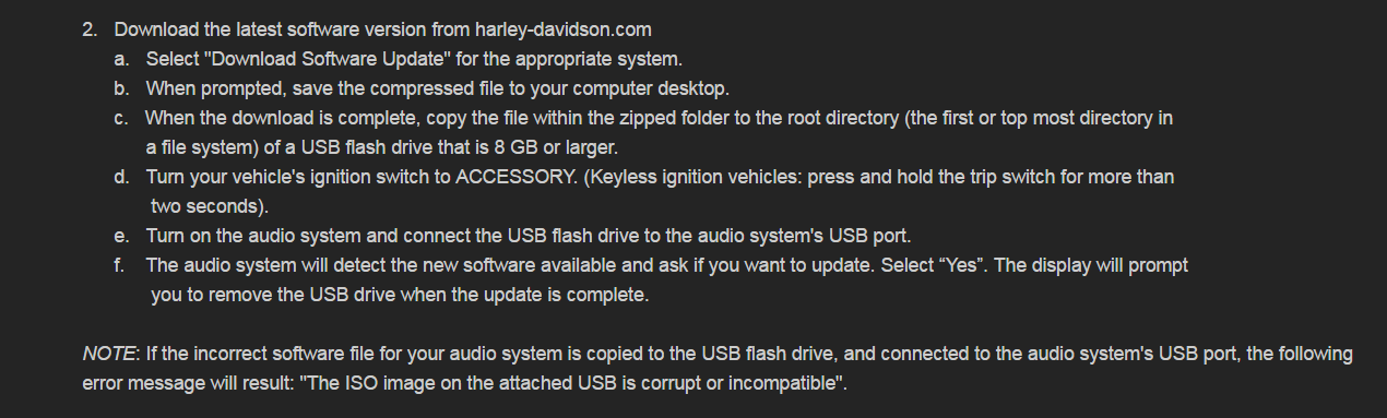

I downloaded the new software to my desktop, then moved it to my Sandisk 32GB flash drive. When I took the USB flash drive to the bike and plugged it in, turned the radio system on, and got a message saying "No playable media found". I guess that is why the "MEDIA" was never highlighted as an option on the selection screen.
Any ideas on what is wrong? Could it be that the connection plug on my bike is bAD?

You obviously DID NOT READ THE INSTRUCTIONS. See item 2c:
Yes, I read it. I guess I'm just not as "
techie" as the rest of you here.
You have to unzip the compressed file and copy the selection to the flash drive. I didn't do that, so it wouldn't work when I loaded the "zipped" file to my USB stick.

I am here to tell you that those instructions aren't even close!
I took my bike into the Harley Dealer today and one of the techs that takes care of me did the upgrade. You can't believe how many steps he had to go through! Then he rebooted the system like you do with a PC to get all the downloads to take.
I repeat, those instructions on the website SUCK!, and are completely lacking in info that it takes to do a proper upgrade. That's the reason so many here are having issues with their "upgrade".

I guess you could expect some sarcasm, when you tell everyone here, that the instructions are wrong.....most of us did the update, without issue. I admit that I too, had an issue the first time, but went back and followed the instructions and it worked great!
My guess is you didn't format the USB stick, after you initially copied the whole file to the disc. As for the dealer, my guess would be that they have a USB drive that the file is downloaded on and only need to plug it in to any bike to update (maybe two, one for standard and one for CVO). I didn't do a reset, but the system seems to be operating as it is supposed to.
