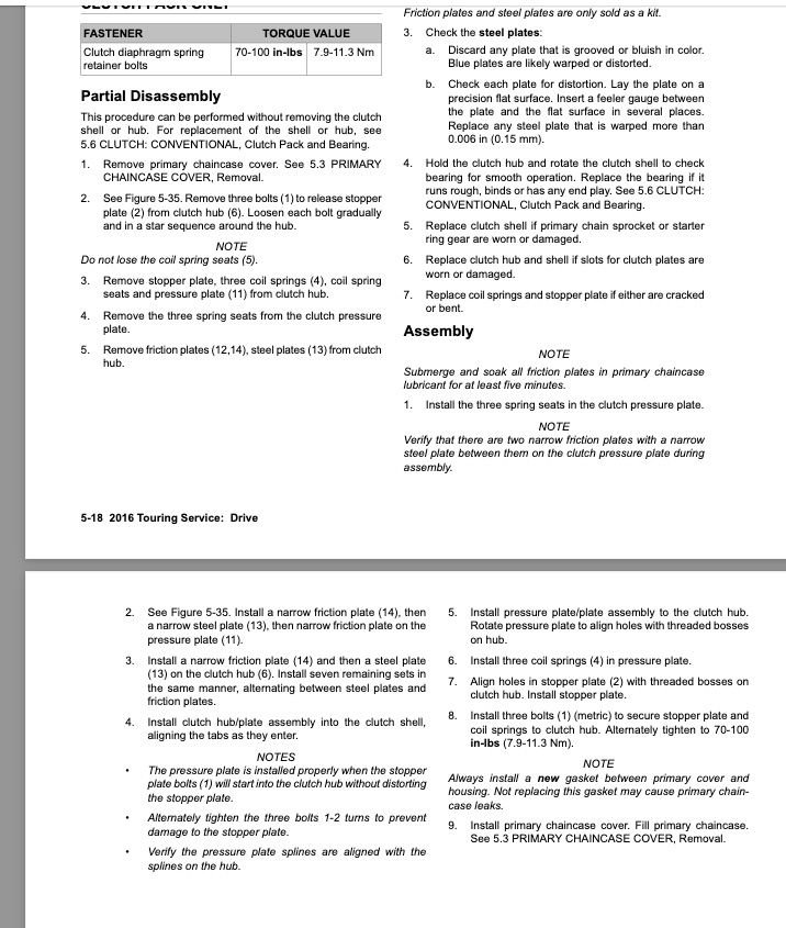

Hello, I have looked EVERYWHERE!!! Including my Owners Manual.. Im looking for the torque specs for the 3 bolts holding the springs in the clutch.. Its a 2016 ElectraGlide Ultra Limited Low... Any amd all help is appreciated..

It's in your factory service manual.
71-106 in-lbs

Two questions for you ...
1st how do i change my user name lol..
2nd Do you have the clutch plate order for same bike? I know it starts with the small friction playte but it has another one or two as well...
I dont have a service manual and Im having to wait for it to get to HD...
Thanks inadvance for any and all help...

Look at the order of every clutch ring as you assemble it. Some very fine details ya need to observe.
i just got back from a ride on it.. Thanks for info Everyone... I knew it went in a certain order but damn this was crazy lol
