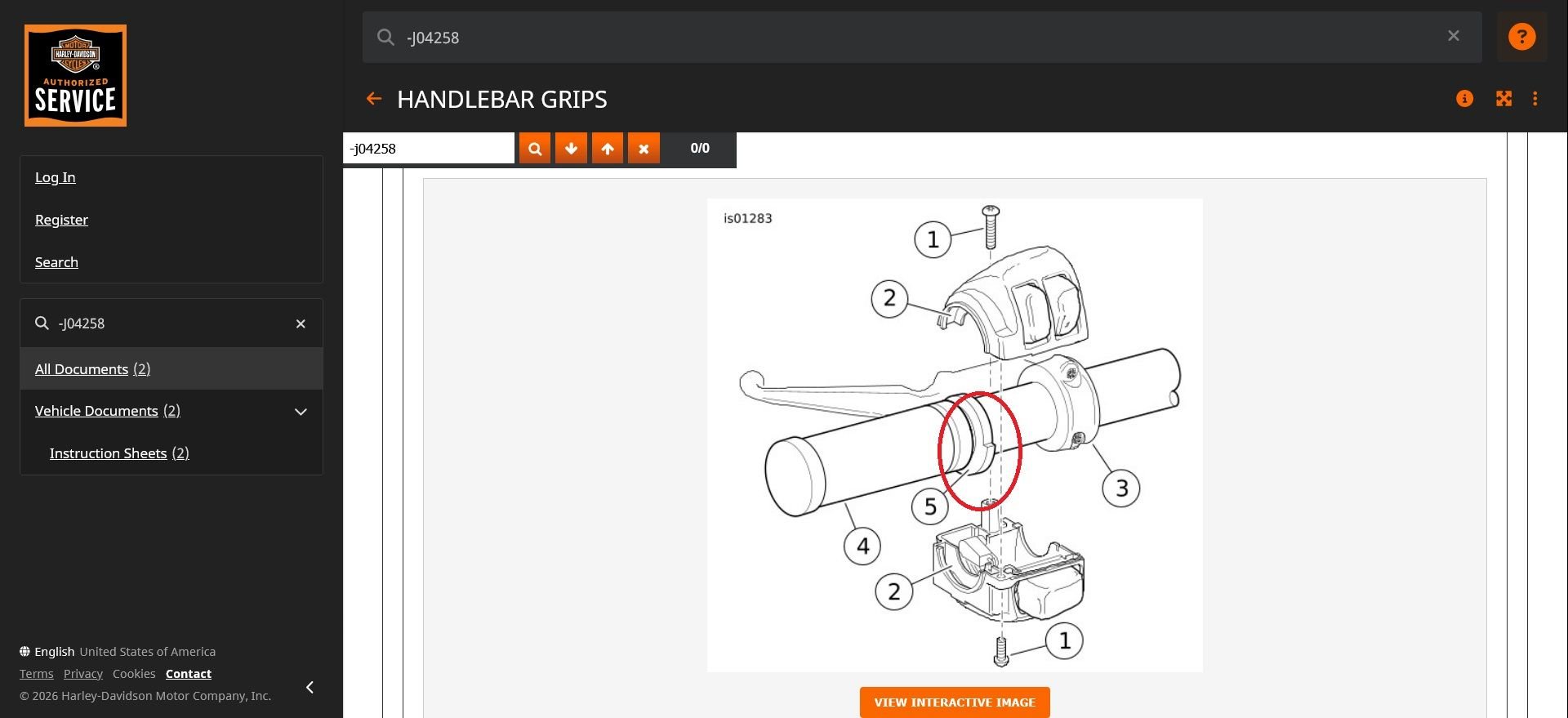

Did you index the grip in the housing? There is a locater on the grip that holds the grip in only one spot so it wont rotate on the bar.

Thanks, Jake. Yeah, when installing the left grip, it won’t seat properly unless you align the tab/notch correctly. It wouldn’t lock under the housing unless it’s indexed correctly. Thanks for the exploded view, I appreciate that!
