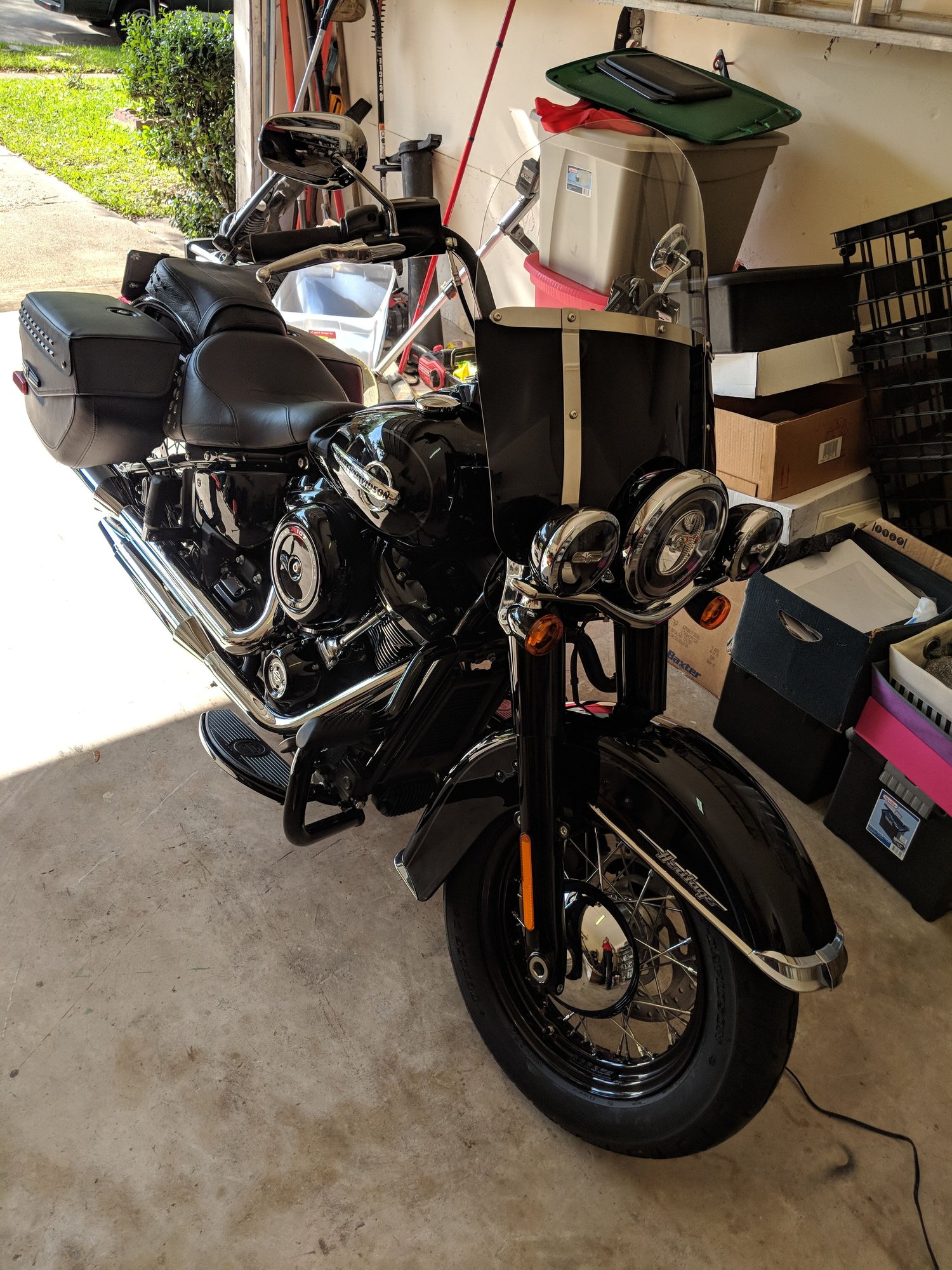

Just added an engine guard for my 107. Looks a lot better than I thought it would and the extra foot position is really nice. I'm looking for suggestions on getting a passenger and driver's back rest.
