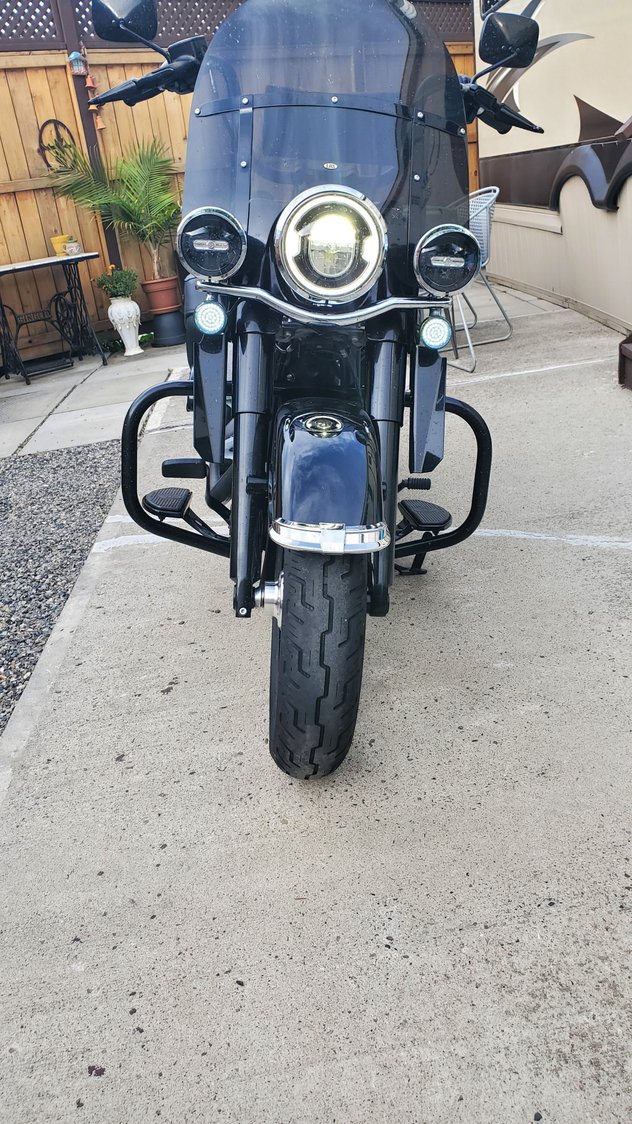

Never mind the bugs. If i wash it, it will just get dirty again.

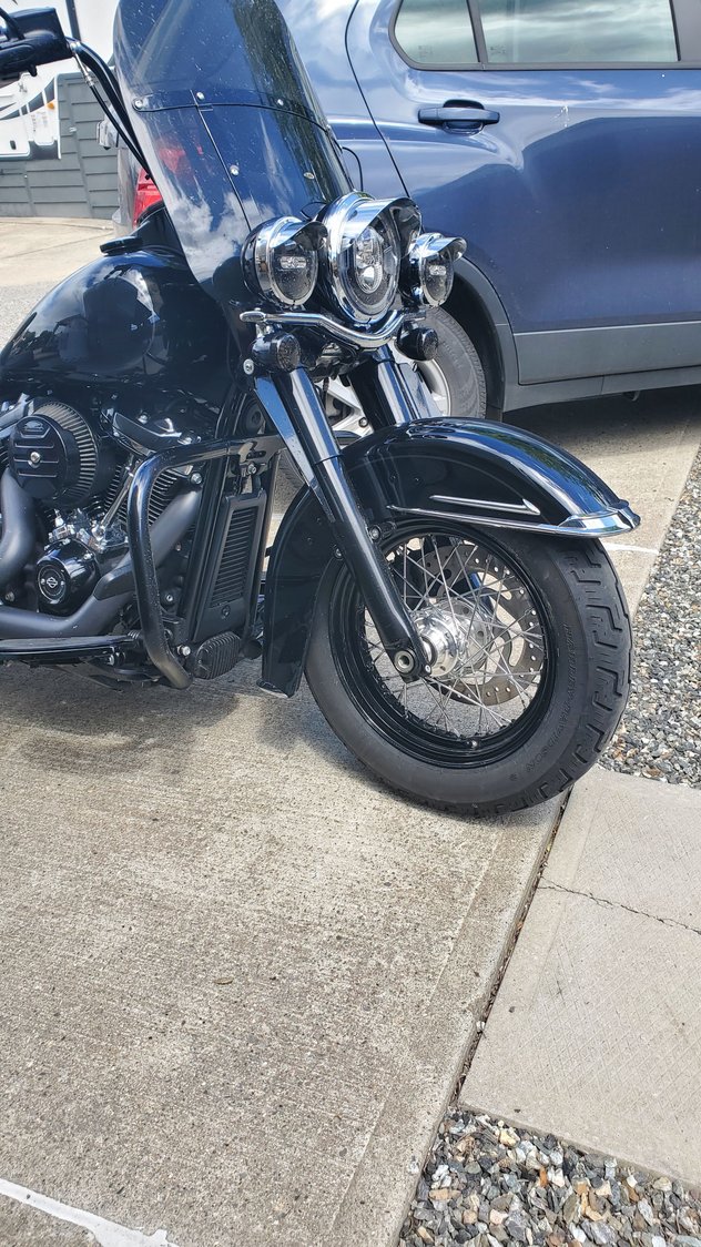

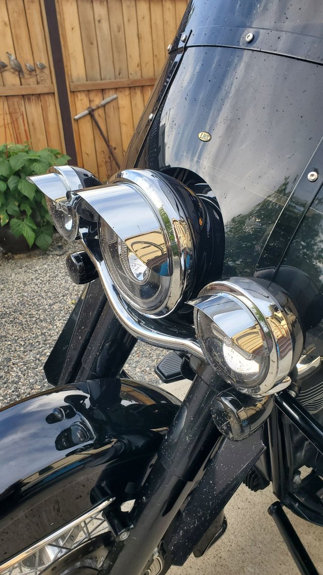

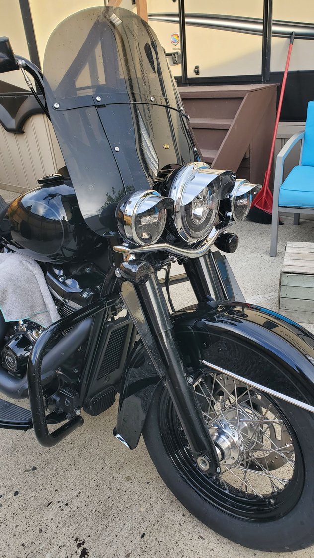

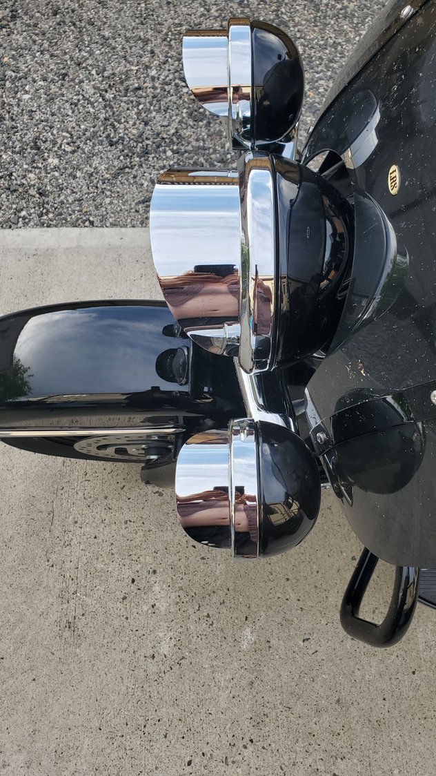

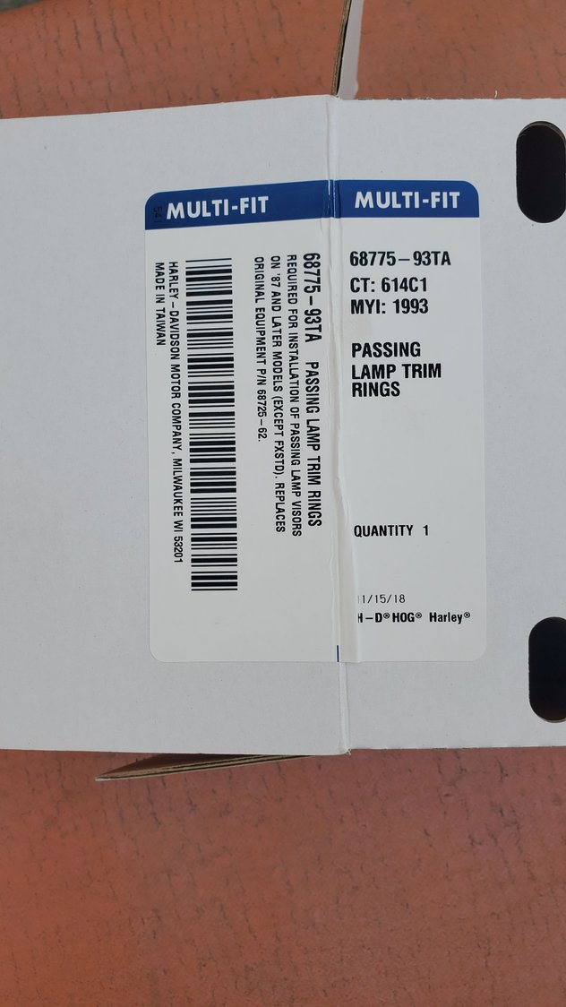

Headlight visor fits just fine, but you need the passing lamp trim rings.
Old Jul 17, 2020 | 08:38 AM
  #2413
Hlgsn1's Avatar
Hlgsn1
Joined: Mar 2019
Posts: 416
Likes: 148
From: BC
Then pick your favorite visor with this shape.

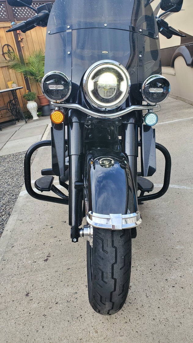

Default Sigz Black Label Edition.
Rouge Rider Industries l.e.d. signal lights.
No halo like the other guys...lol
Great product. Great customer service.
Nice to find a little company that cares these days.
Not affiliated in any way. Just a happy customer.

Originally Posted by Burbur2
can you share some info about visor installation? I would like to do same modification just dont know from which model these visors are and how difficult it was to install it.
All visors are pretty much of a muchness, though buying HD ones gives you the opportunity to pay twice the price of ones from Custom Chrome. The size of the headlamp (7" for Heritage and the size of the passing lamps) is the only real difference between any of them.
To fit them remove the chrome trim ring around the headlamp, the rings are split and have a screw and nut at the bottom that clamp the ring to the headlamp shell. Insert the visor from the rear of the chrome ring, replace trim ring and re tighten the screw. That's it, well, that's nearly it. With the Heritage you need to get the passing lamp bar out of the way to get to the headlight trim, 2 allen screws if I remember correctly.
The radius of the visor is greater than the lamp trim it's mean't to fit around so as you tighten the trim screw it clamps the visor in place. The little lip on the rear stops the visor from escaping out of the front of the trim.

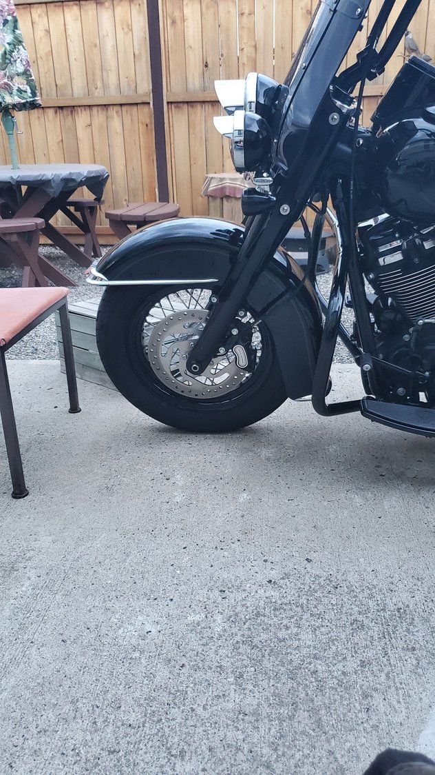

Originally Posted by Hlgsn1
Took off the Chinese stick on Heritage sign. Came off easy. Left a few holes, will see if they whistle. If no might leave it.
had these top spears laying around for a few years. Guess now is the time.

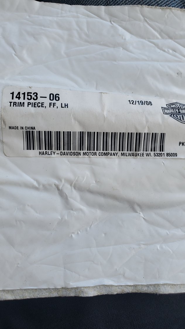

Also made in China....hmmmmm
one is made in China , the other is made in Taiwan . the quality of the part might be the same , but the countries are not .

Been parts from all over for a long time.....as long as it works.
the push nuts for it is out of Canada.😊

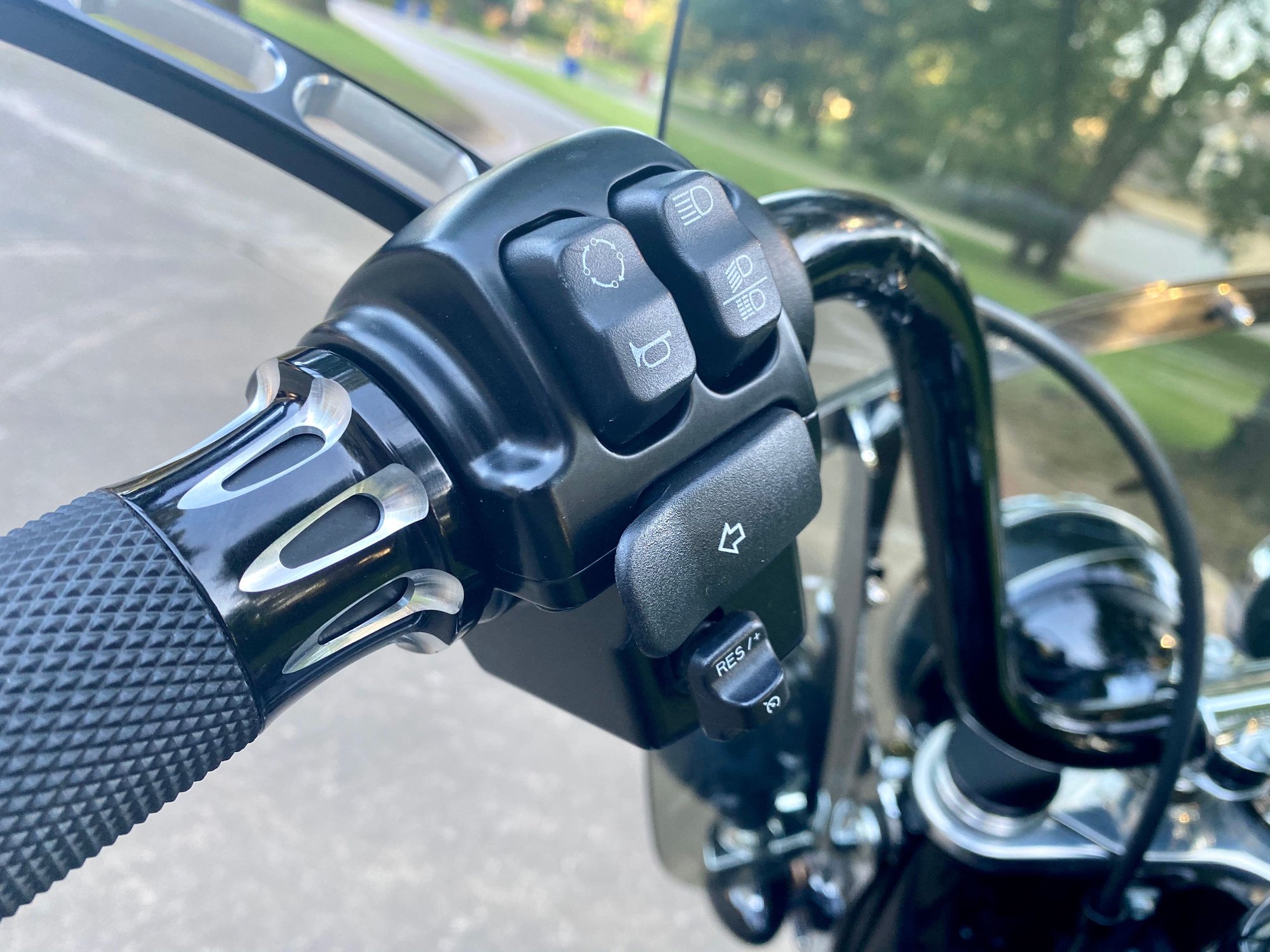

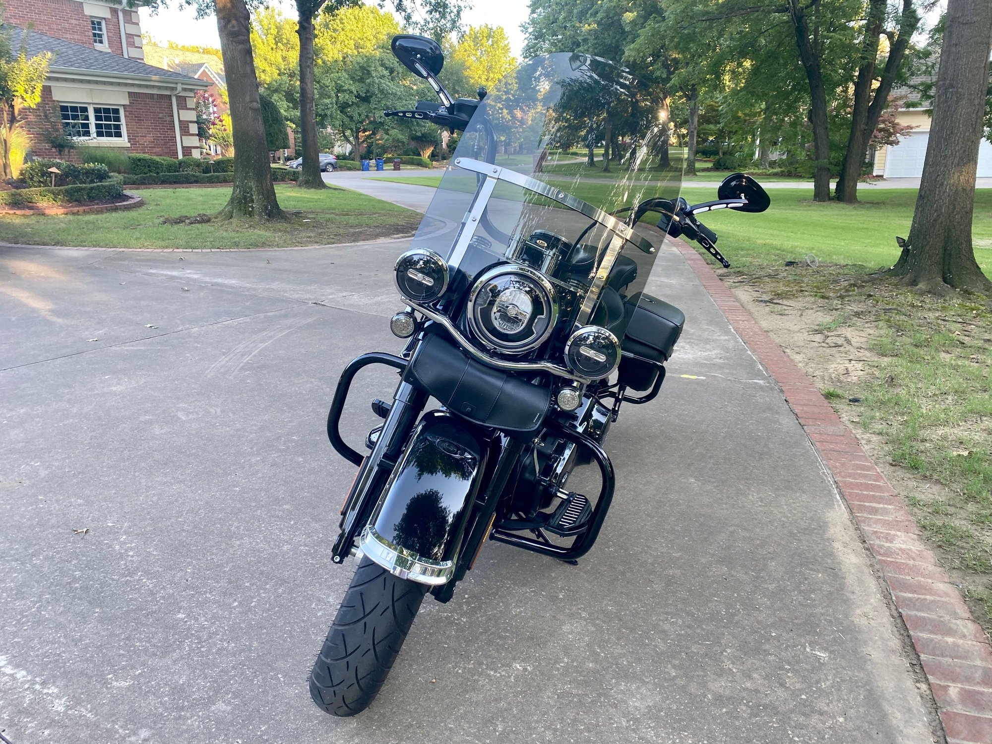

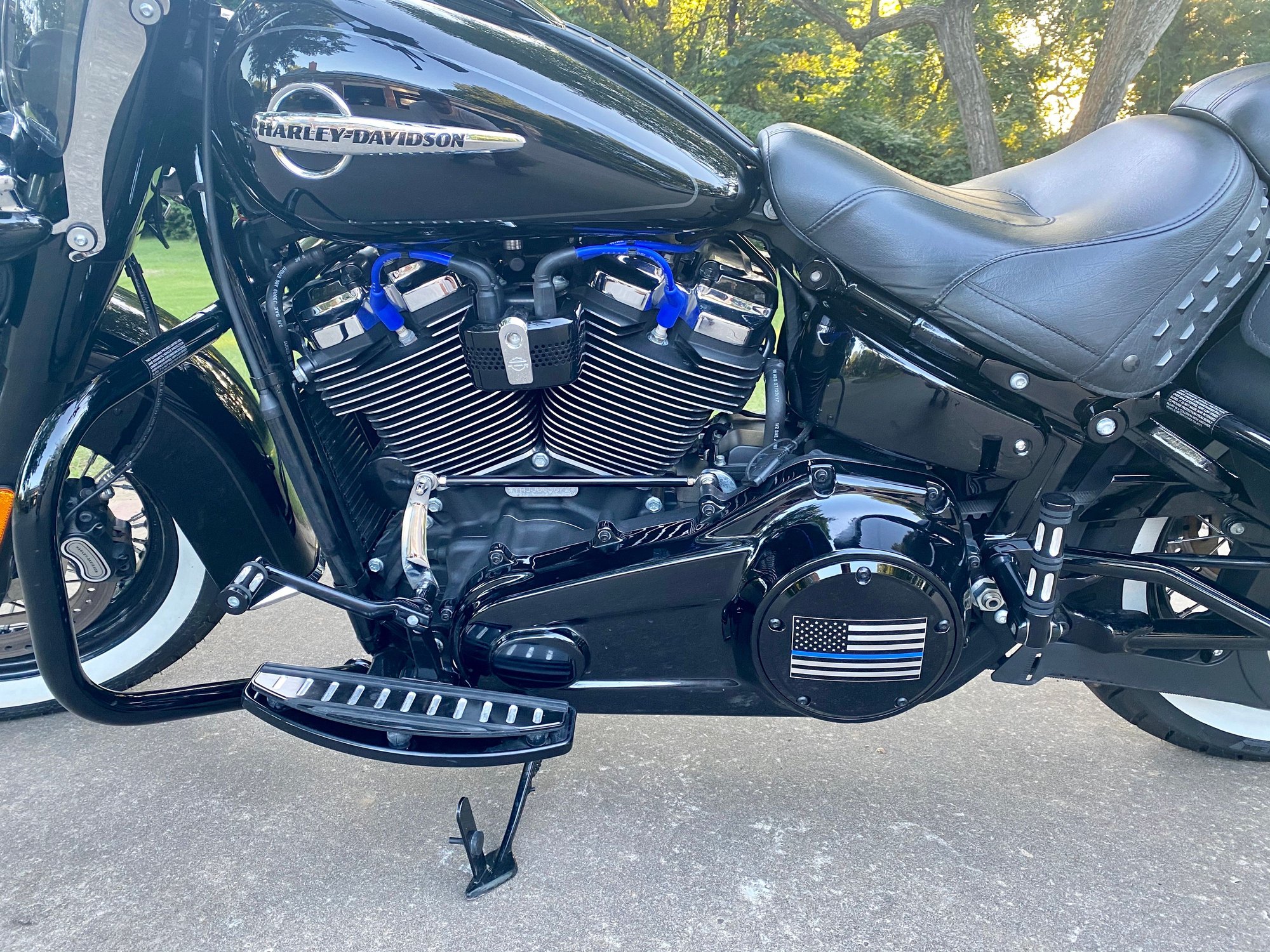

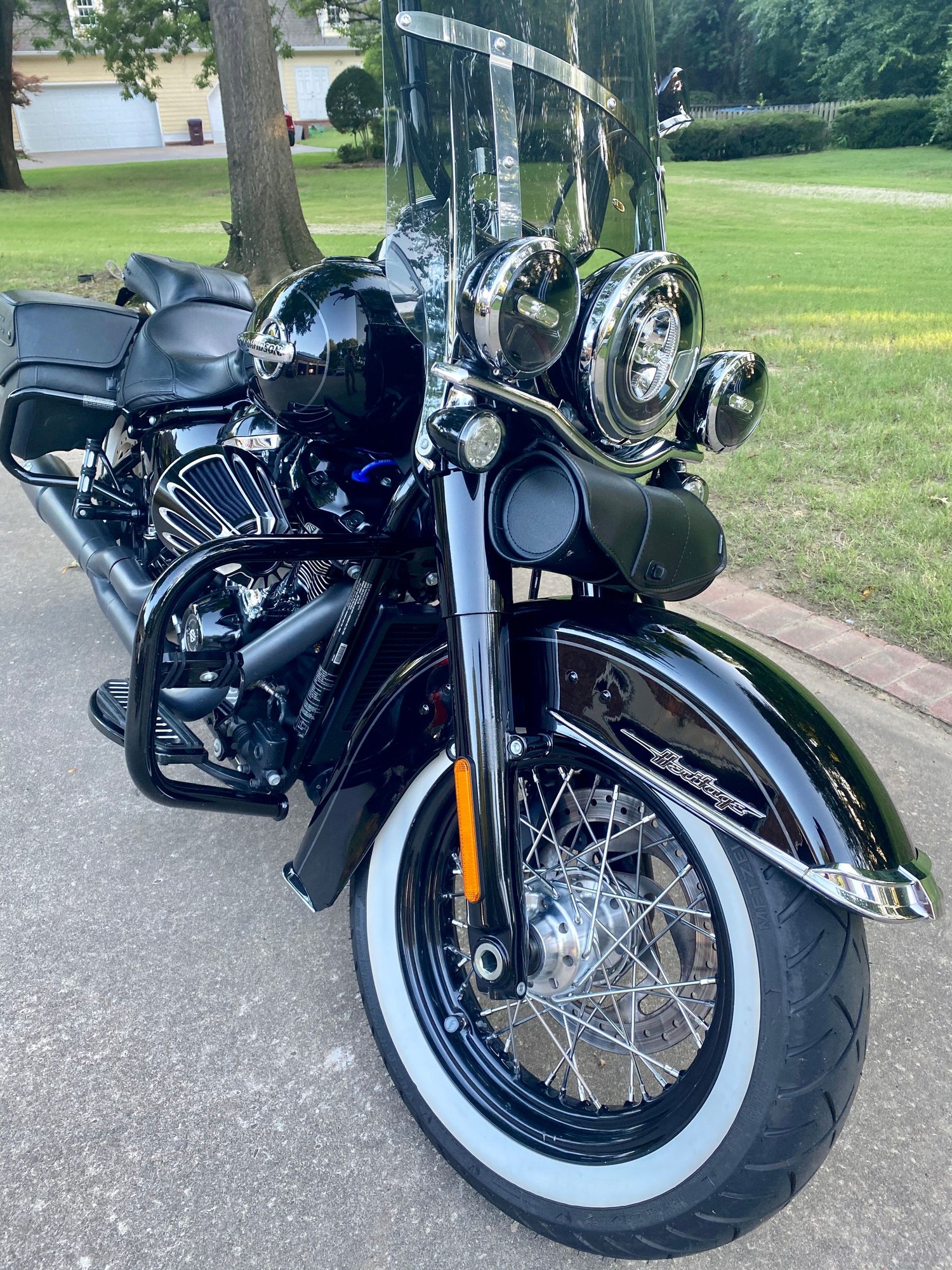

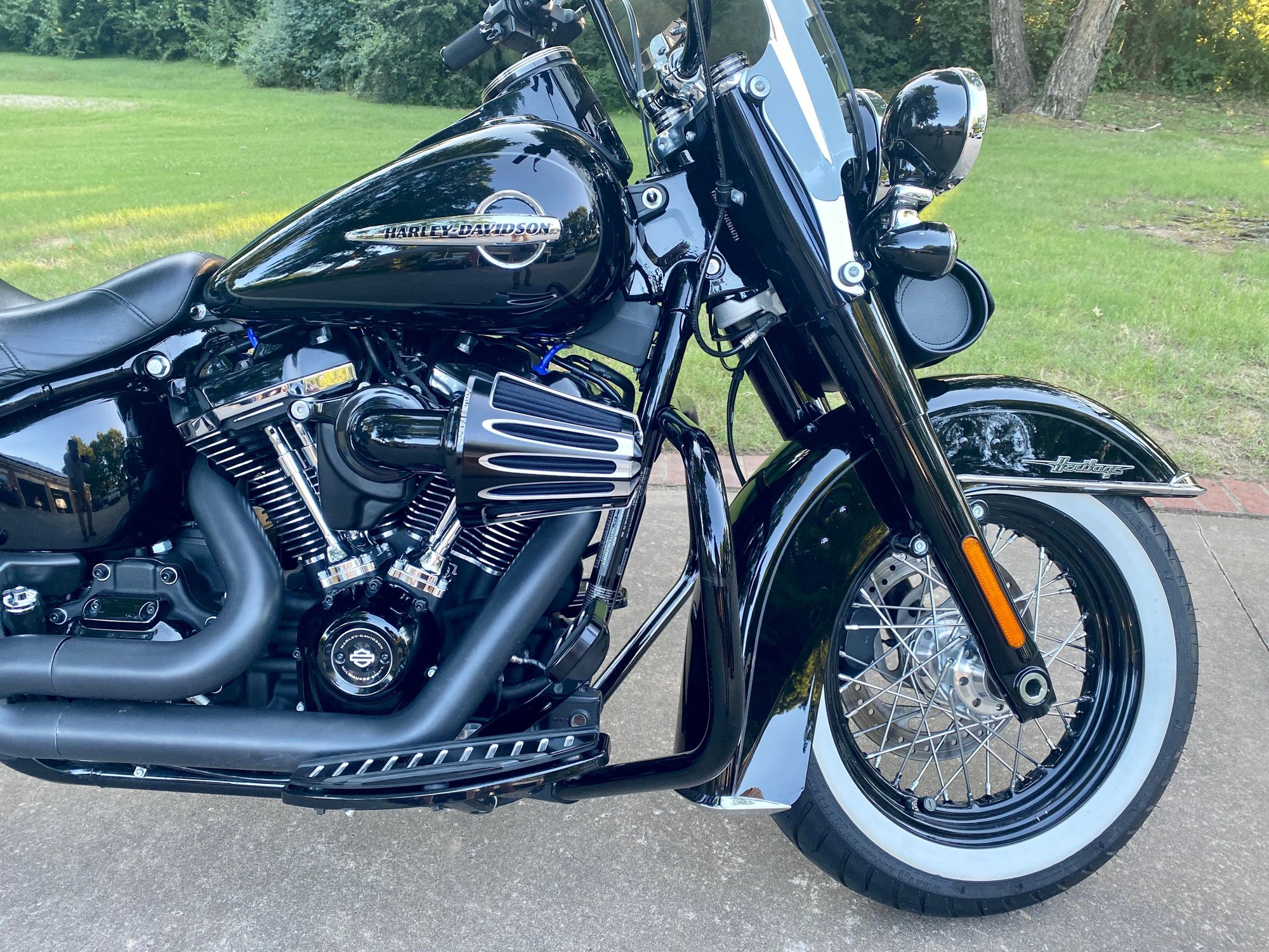

Default Finally took some pics...
