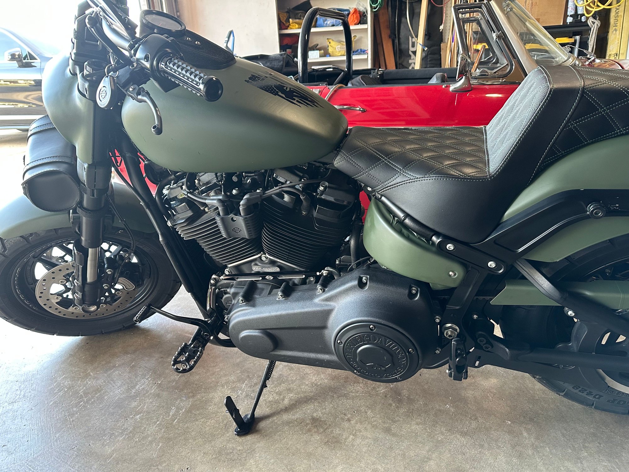

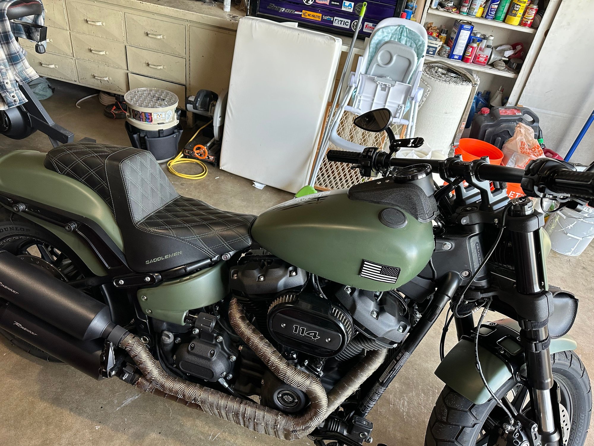

Originally Posted by Big Al 59
Nice bike, what are your floorboards ?
Thrashin Mini Floorboards

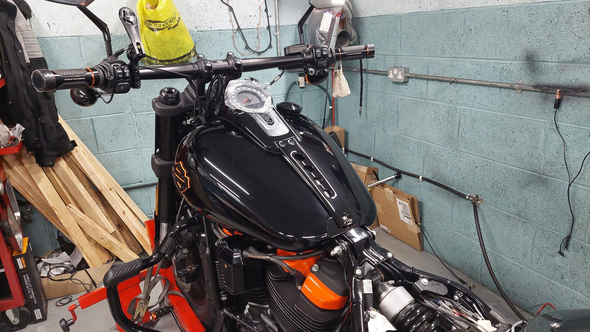

5 gallon tank on

I've been thinking about doing a tank swap, but worried about how much bigger the tank is physically. I can't find any info, do you mind measuring your tank to see the dimensions? The fat bob's tank is approximately 14.5" at the widest part, 6" at the seat, and about 7.5" tall. Hopefully anyone has some insight.

I can't measure it right now as its still at the dealers waiting on the seat to be modified.I can tell you that my HD 19 inch windshield will need to be modified as its touching on full lock.The fork clamp rubber grommet and the upper windshield 'bracket'(the piece that mounts to the clamp) will touch.So I can either get these modified if possible(should be possible) and continue using the HD windshield,buy a MS Road warrior or use no wind protection.I love my 19 inch windshield though.I get what feels like zero wind out riding.

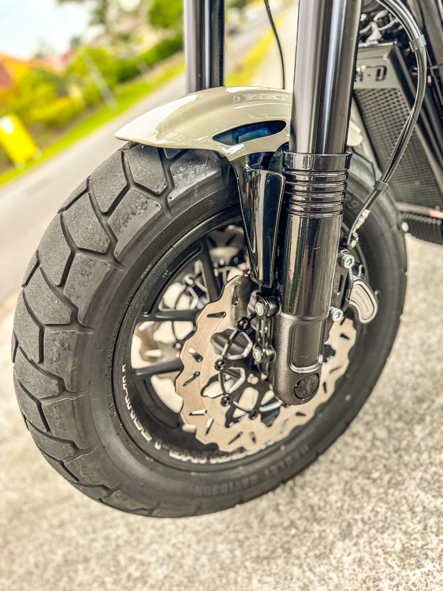

Put Galfer rotors on front and back for some extra stopping power, new pads as well.

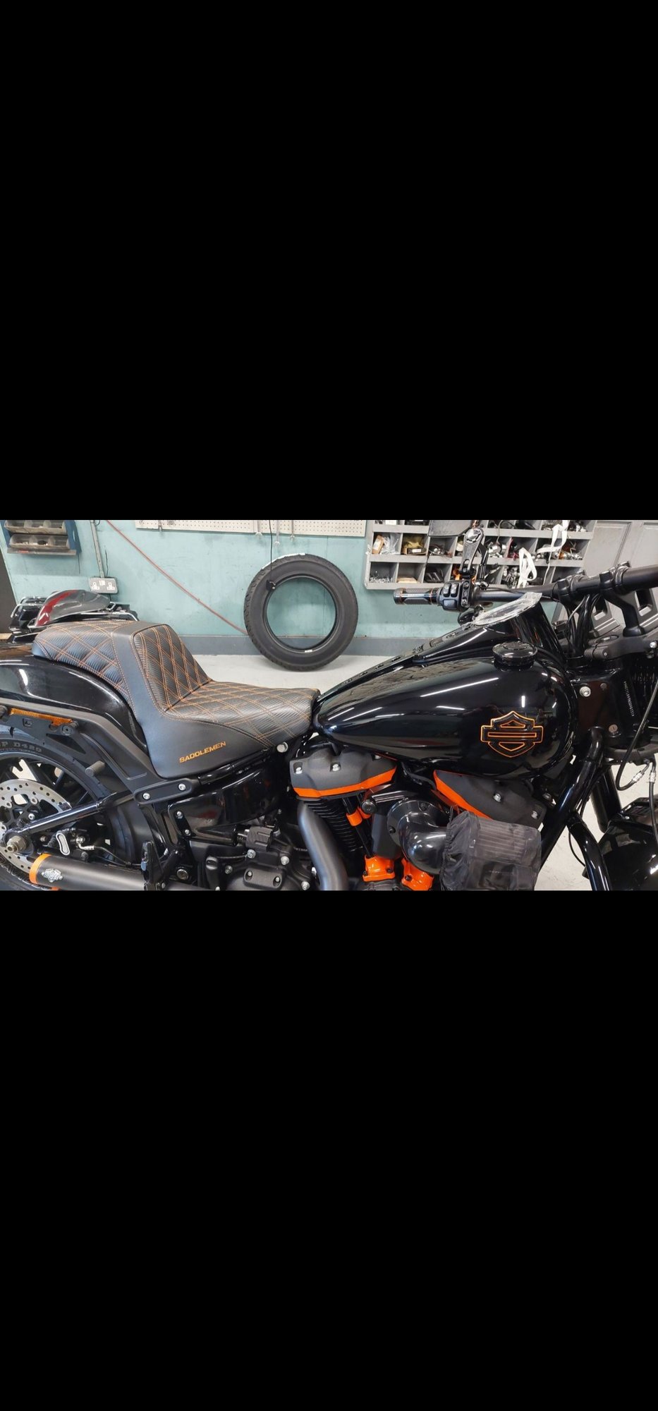

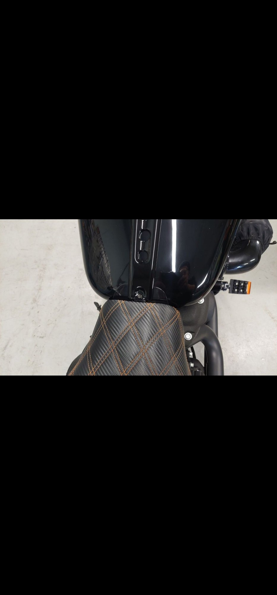

Ok I have my bike home.The Fat Boy,Sport Glide tank is approx 21.5 long,8.5-9 in height and approx 8.5 at the seat.The seat measure is difficult to interpret when one should measure the width though as it tapers down toward the seat.I needed my Saddlemen seat modified.

Nice! Complement it with some new tires. You can get much better grip and thus stopping power with avons cobras or metzeler cruistecs.
