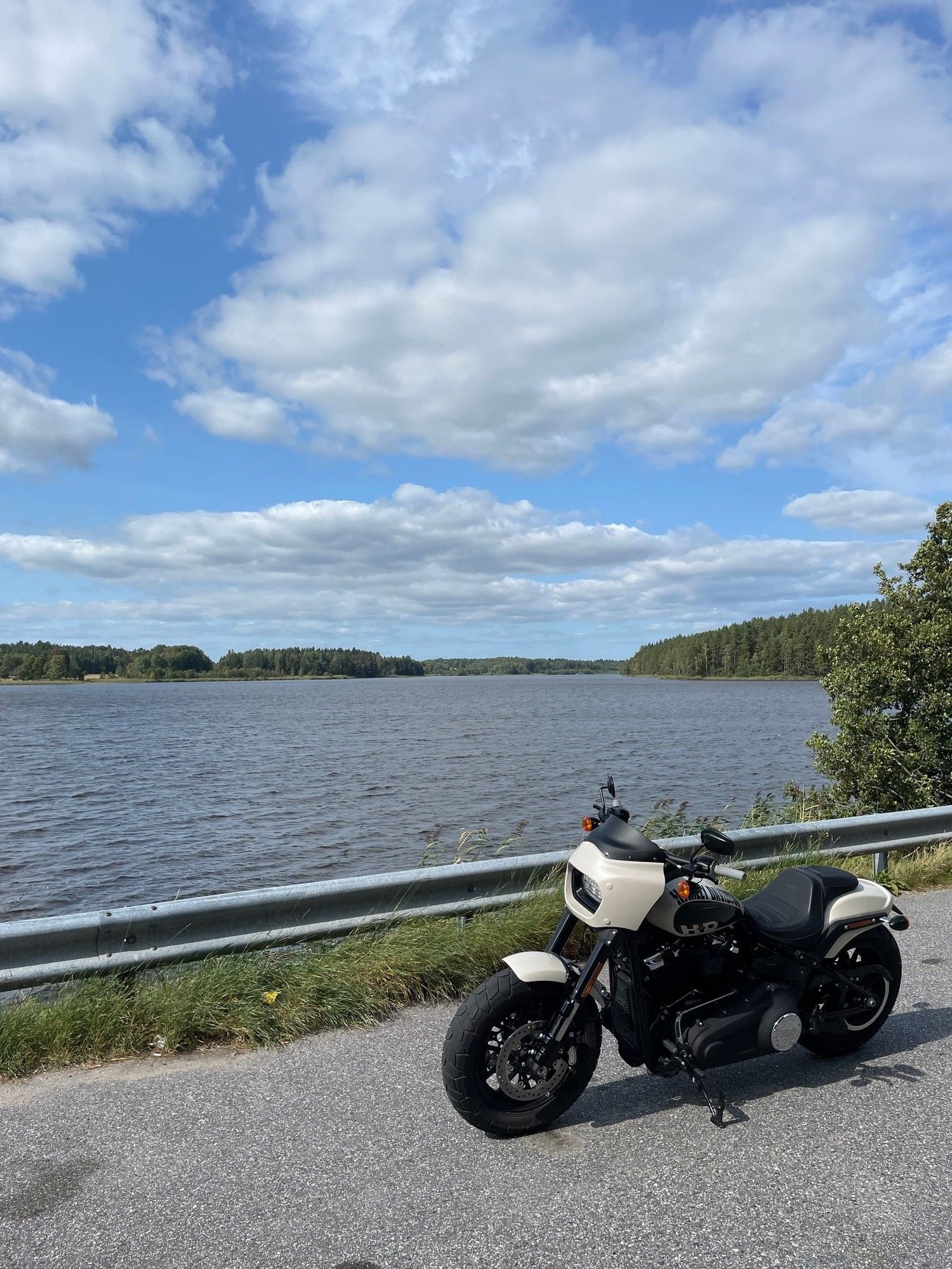

Just a puc to get this thread up on top
this fairing I like! What kind is it?
and also what is the size of the mini screen?
