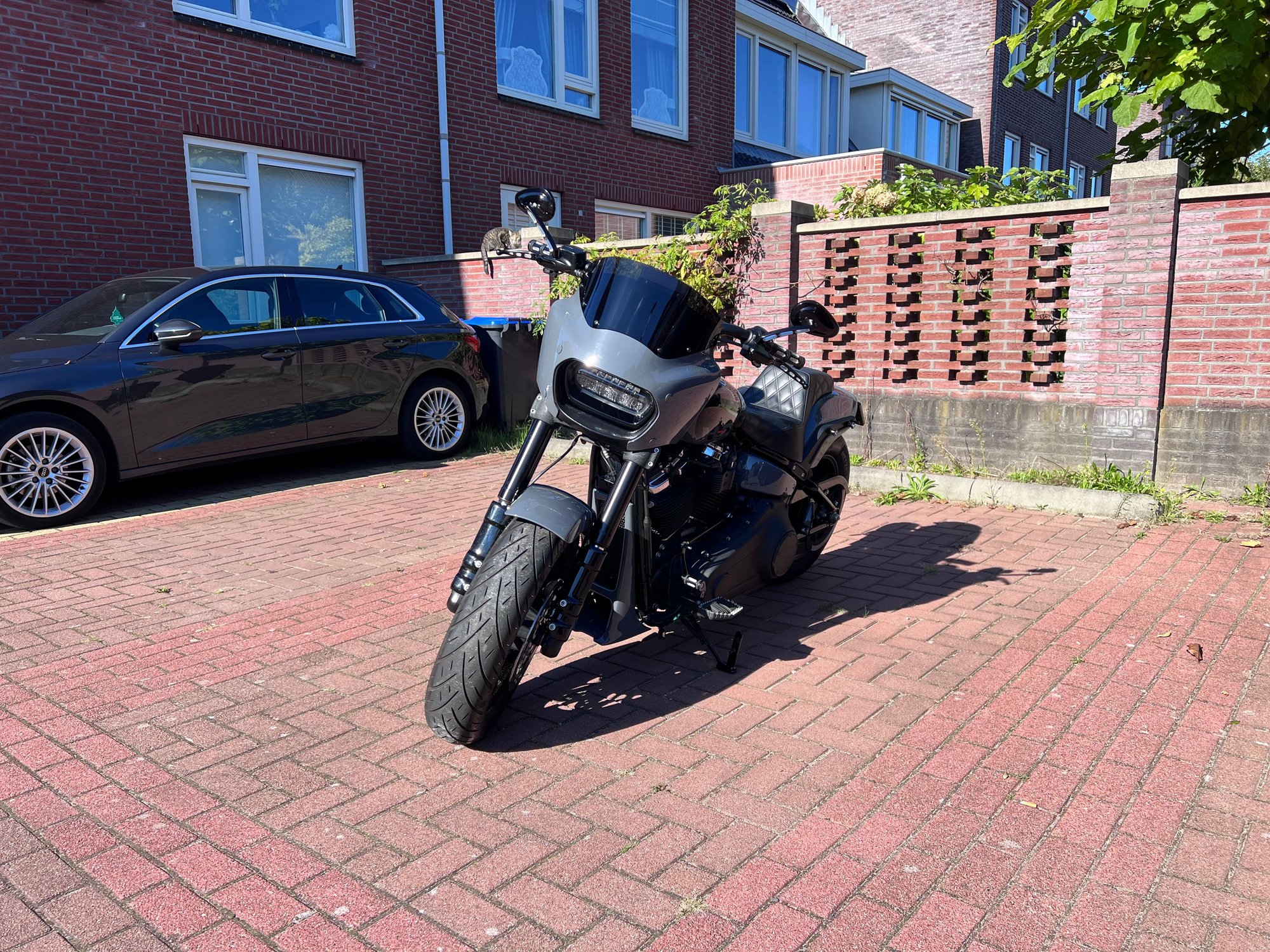

Default Memphis shades installed and CarPlay screen
Worked on the bike yesterday. Installed Memphis shades. I get them to the painter next week to put gunship grey over the high gloss black finish.
Needed 12V ignition switched outlet for my Carpuride CarPlay screen. HD has got an assembly for that.
you have to open the USB box under the tank and put a cable harness into that. To open the USB box you have to lift the tank. It was a lot of work. Does anyone know how to remove the tank without removing the tacho on the tank?
The default tape put on by Memphis Shades. This is butt ugly and the double sided tape is visible and prone to dirt and insects
Got a car door protection strip from Amazon which makes an very nice and clean look

There’s a grommet on the frame just in front of the tank that the tacho harness feeds through.
Remove the grommet and there’s another connector.
Disconnect that connector and the tank will come off with the tacho in place.

Yes! My Memphis Shades Road Warrior is back from the painter! Very happy with the results!
this one is with the 7” glass and the part behind de glass is still gloss black to accentuate the contrast.
