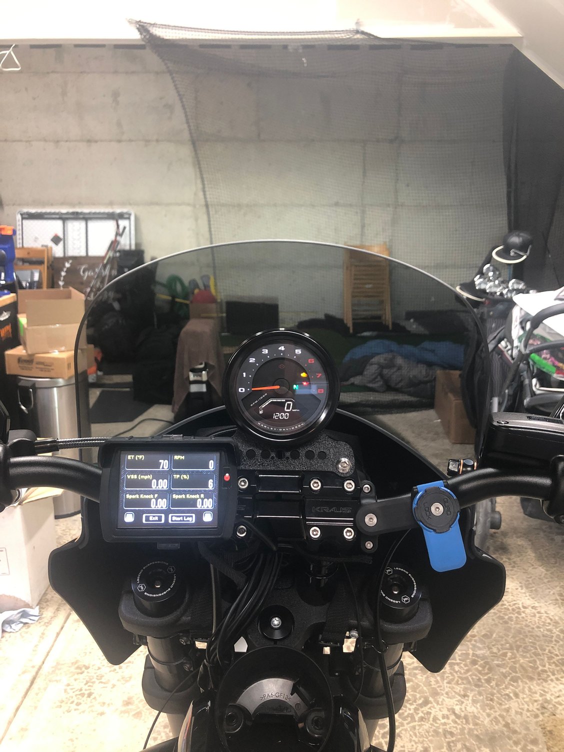

has anyone moved the speedo from tank on the new 2019 softail ?

Just curious what you did with the mount on the tank?

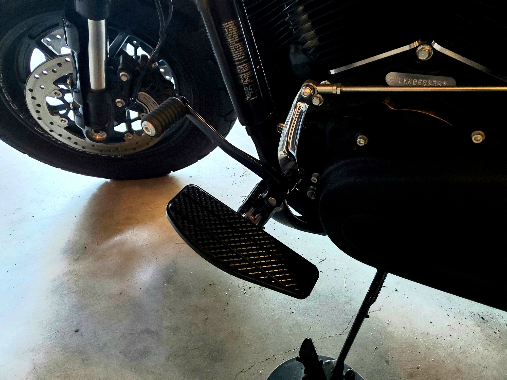

Installed the Thrashin Supply footboards today (got them for Christmas). I set them at a comfortable angle, and it seems like the brake pedal should be higher. I moved it as far as the stock components will let me. There are only 2 threads left at the back of the master cylinder post.
Anyone have a suggestion for another brake pedal that has a higher angle?

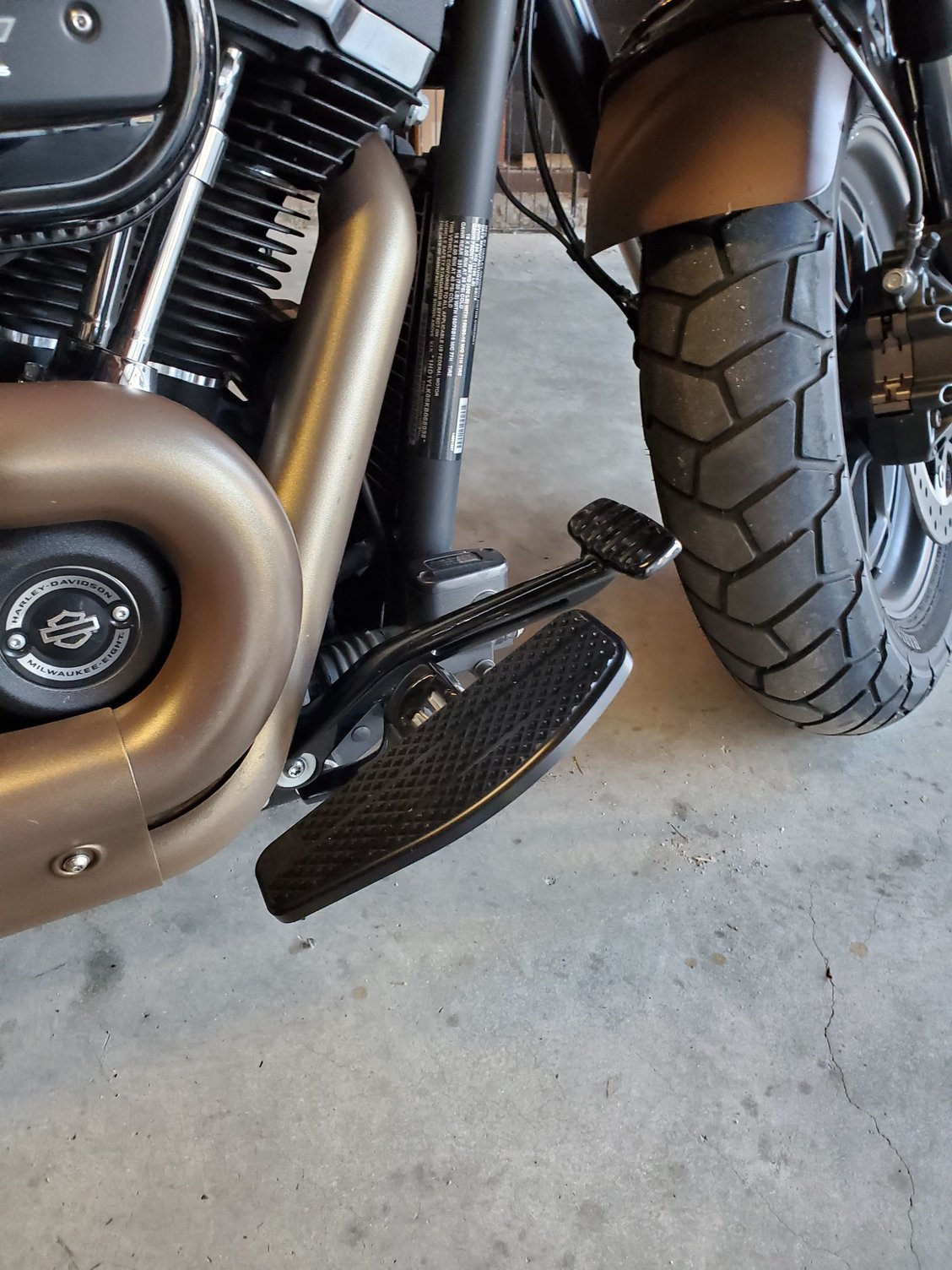

No suggestions, just saying -- I was in the exact same boat. My solution was to raise the pedal as high as possible (as you have done), then angle the footboard down until it provides just enough clearance for full engagement of the brake pedal.
Initially I wanted the footboard at a somewhat steeper angle, yes, but I got used to this compromise very quickly. I have put on probably 20,000 miles with these footboards and I find them very comfortable and a massive improvement over the footpegs.
