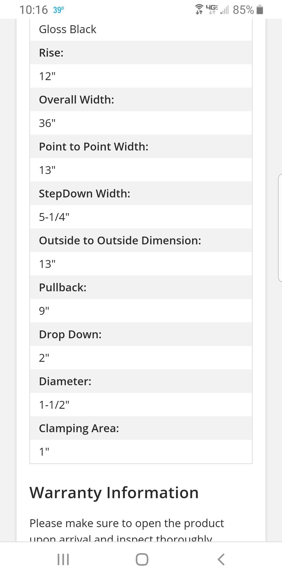

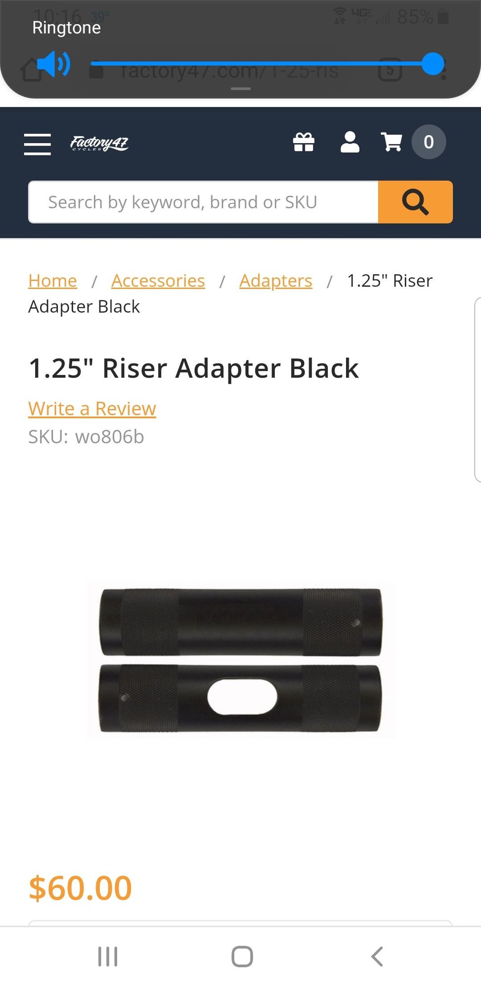

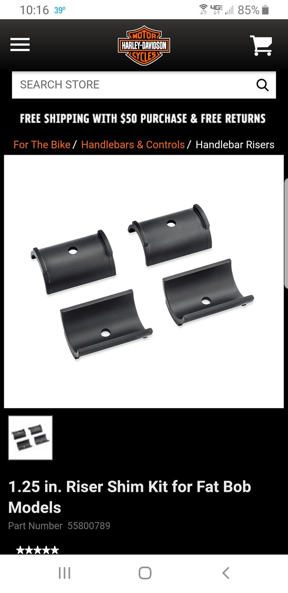

I wonder if they used Harley riser shims and the factory47 handlebar shim stacked together to make the 1" clamping area one the Malo bars work. You can see a small gap in the riser on the video.
Factory47 specs for Malo bars.

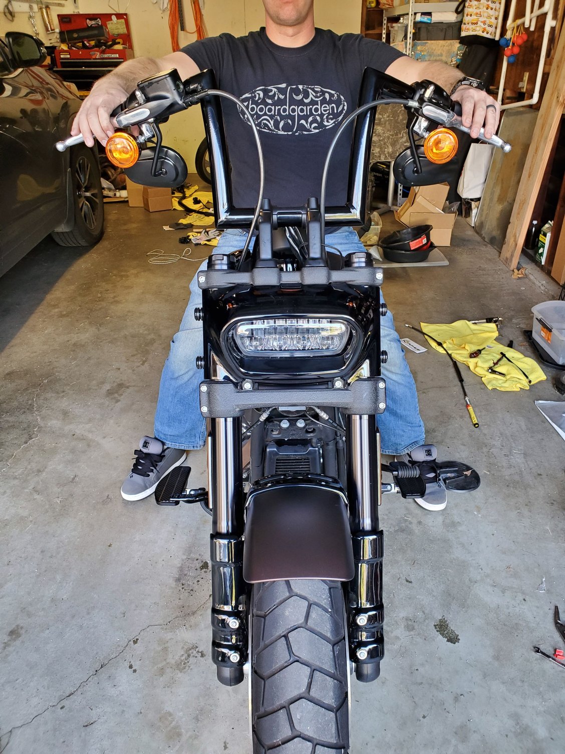

Finished my bar swap today (minus the ricks levers which have not arrived yet).
Todds cycle 10" strip bars in 1.5" diameter sitting on stock risers. All cables and connections were lengthened to make it work.

By no means am I an expert, but it doesn't look like the Todd's bars have any knurling in the clamping area. Did you have any concerns about this in the install, or have you had any issues with the bars moving in the riser. Again, this bar looks great on your bike and seeing yours and the malo bar on the video have got me thinking.

It was a thought. There is no knurling on the bars or on the risers. With the 1.5" clamping area having so much more contact surface area, I don't think it will be a problem. That being said, I have not pushed too ridiculously hard on the bars to check.

Thanks. I was really worried about them being too tall, and I even ordered 1.5" risers but so far have been happy with the added height and pullback of the stock risers. The fairing hides the risers, and I like that. It does not look bad without it, but it looks better with it.

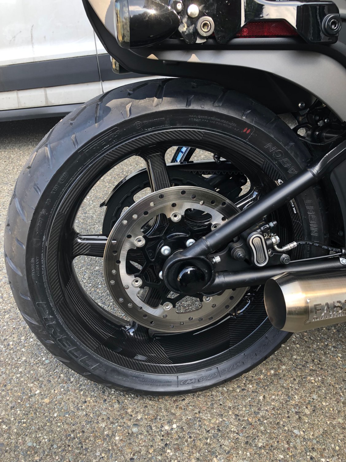

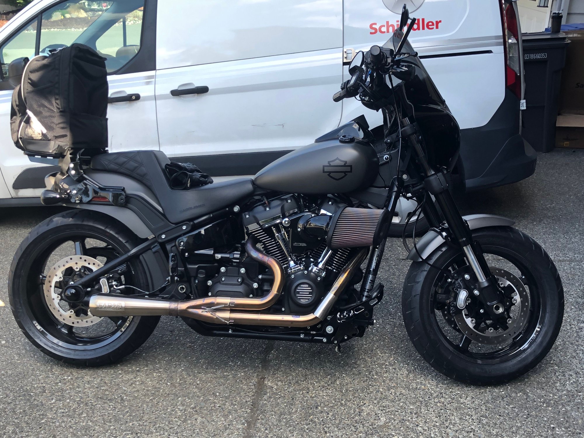

Got my wheels on finally and I was not expecting the carbon fiber to change the handle too much but wow it made a very noticeable diff. The gyroscopic effect at highway speed is pretty much gone. the bike just tips in and out like a dirt bike at 90mph. Also at slow speed I don’t feel the heavy front wheel like the stock wheel and tire setup.

I have ridden in the rain and pushed it really hard on the twisties in hot and cold weather and I absolutely love them. Far better than the stock tire. With the stock tire the front wanted to push/ wash in the turn and I feel none of that w these they just stick and go. I have used every inch of them and they stick right to the edge. Also they were perfectly balanced mounted on my bst carbon wheels I have zero weights which I was supper happy about.only issue I have had is that they were very greasy from when they were new I almost wrecked twice in the first 3 miles becasuse they were like riding on ice. But after that good to go.
These are the radials with a high speed rating.
rear-180/55R18 74w
Front- 140/75R17 67v
