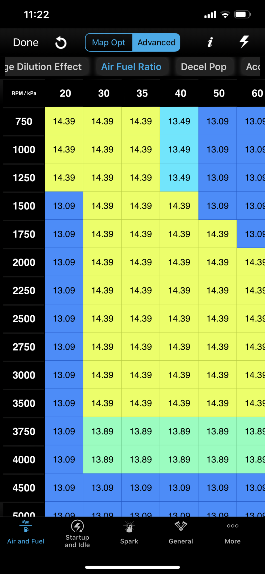

Originally Posted by Hulkss
Let's have a look at what V&H calls the Air Fuel Ratio table. Please do a screen grab of it and post it here. This table is the desired or “target” air/fuel ratio. The ECU uses this number to calculate how much fuel to spray.
This fuel table is what the EPA forces H-D to keep locked down.
I would really like to see how V&H fueling compares to H-D. Let's see the difference. I can easily do a comparison to the Street Tuner and post it. If it is interesting, we could compare some other tables too.
Here you go.......

EDIT Very cool. Looking forward to hearing about the air fuel ratio discussion EPA tune vs best tune.
