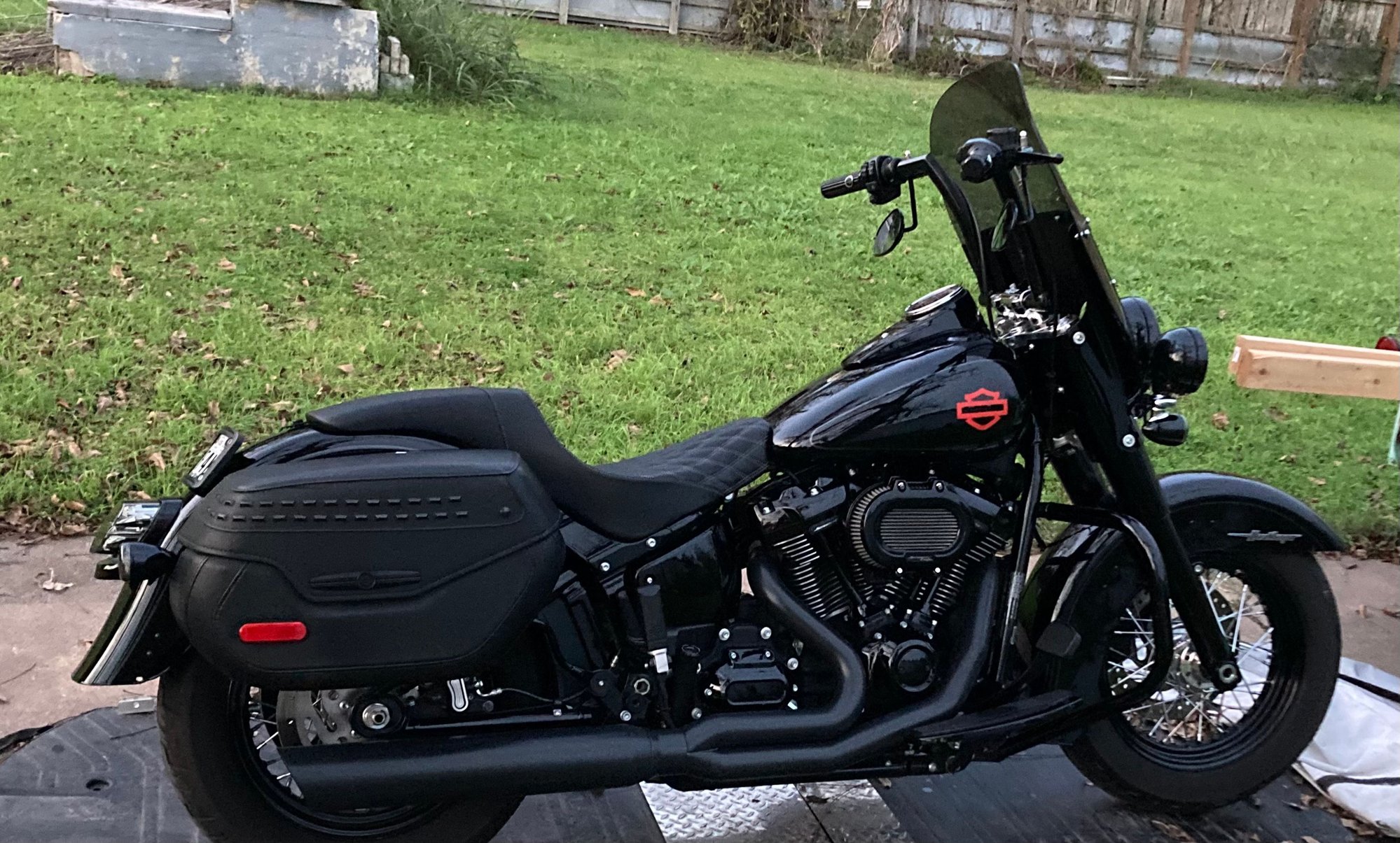

Just saw you were looking at Fat Bagger bars. Can’t be 100% certain until you install, but I would guess you would need wiring and TBW extensions. Should be able to make clutch and brake work, but may need to reroute slightly. Here is a pic of my bars to give an idea of the difference:

Your Heritage looks great. I'm 6' tall as well and am hoping the 12" bars will be the right fit. Not looking to go super tall, just want my arms to be positioned straight. I've measured the difference between where the stock ones are to where my arms naturally land if I'm not slouching, and it seems to be about 2-3".
