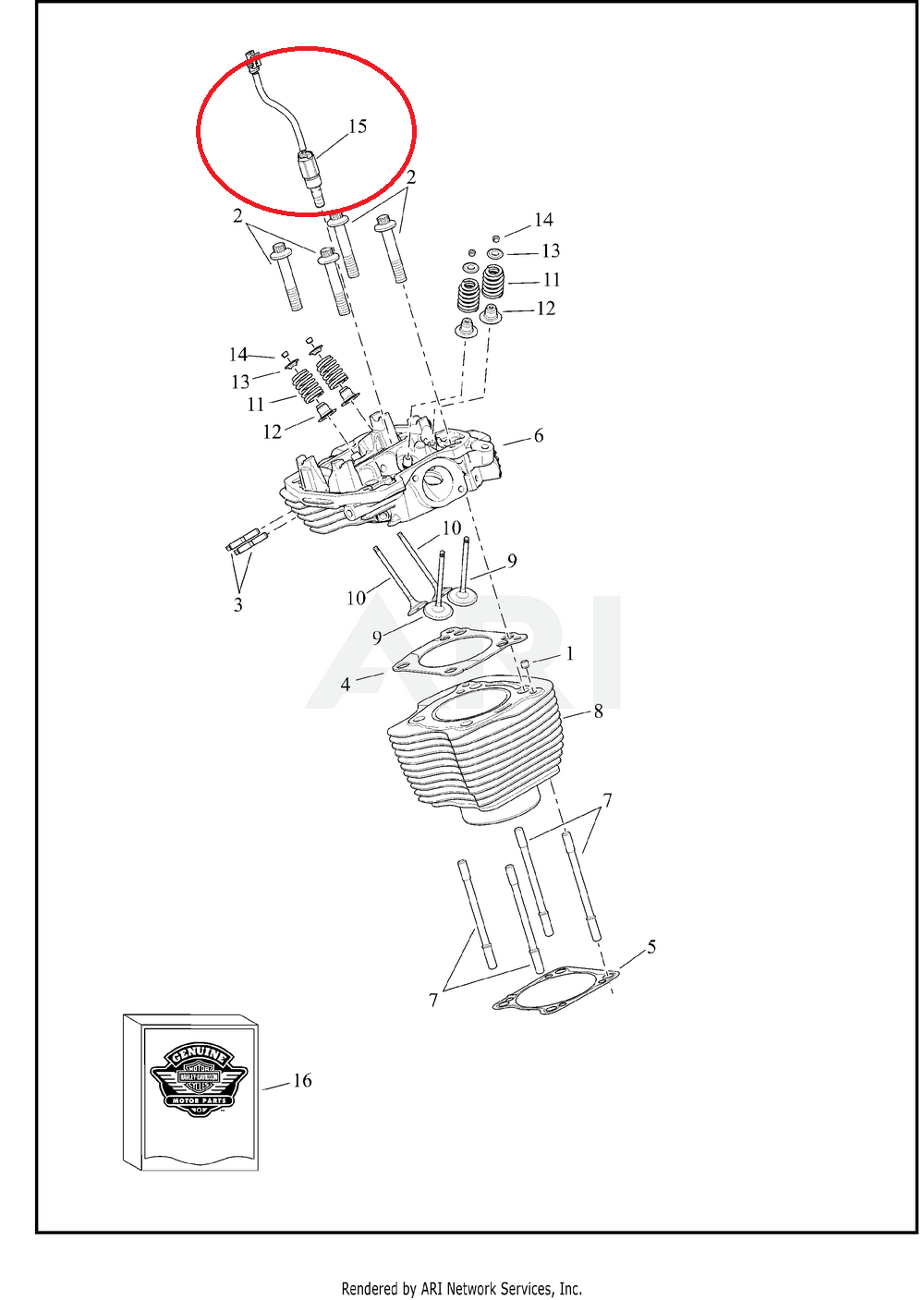

1. A battery can show good voltage both at rest and when charging. However, it is amperes that crank the starter over (Cold Cranking Amps, CCA) A load test will show how many CCA you have. (yes a pain to take the battery out).
2. ACR, see parts diagram below. Check connections and wiring to the ACR's
Ref:15
18400073B
PT CAMDR/VT MISC CMPNT,ACR VALVE | auto compression release (ACR)
