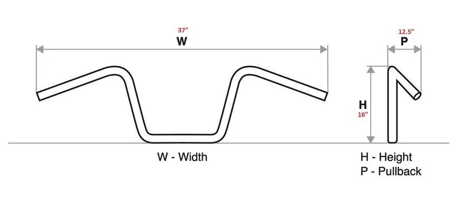

I hunted around the net for measurements/dimensions for the Wild 1 Chubby Classic 16" Ape Hangers (which I currently have fitted) and added the info. to their pic.
(Reference: From the Custom Chrome Europe site).
I got in touch with Wings Custom, who were extremely helpful, and got the dimensions for the King Curve Rhino 2" bars and added the info. to their pic.
