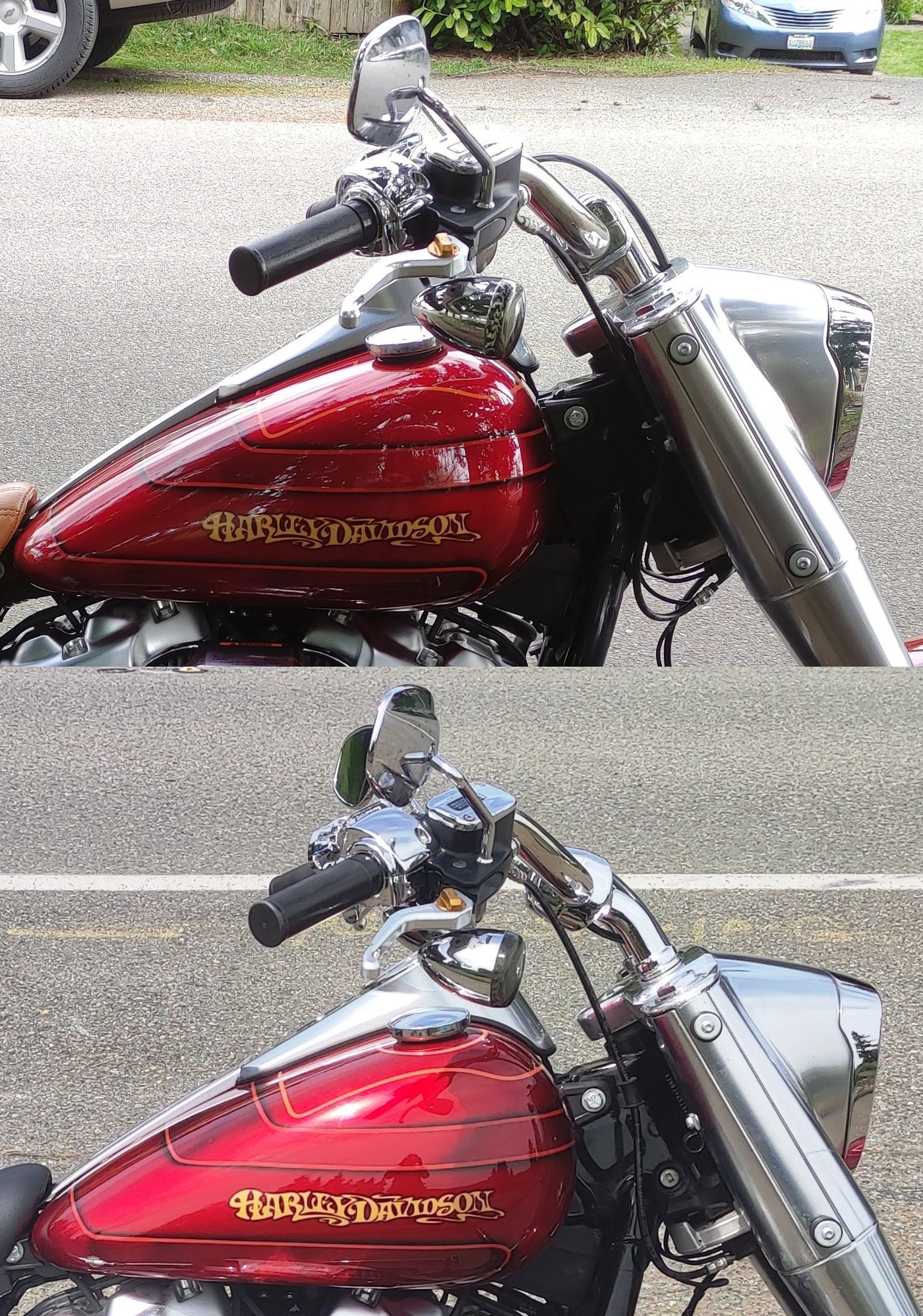

Old Sep 23, 2023 | 09:19 AM
Urban Gorilla's Avatar
Urban Gorilla
Joined: Oct 2022
Posts: 653
Likes: 510
From: United Kingdom
Thanks for all the replies and pics.
I suspect what has happened is that when the Chubby bars were fitted that the risers were changed at the same time to accommodate them (this was all done prior to my ownership)

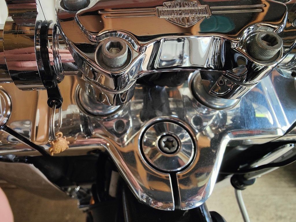

Old Sep 29, 2023 | 04:37 AM
