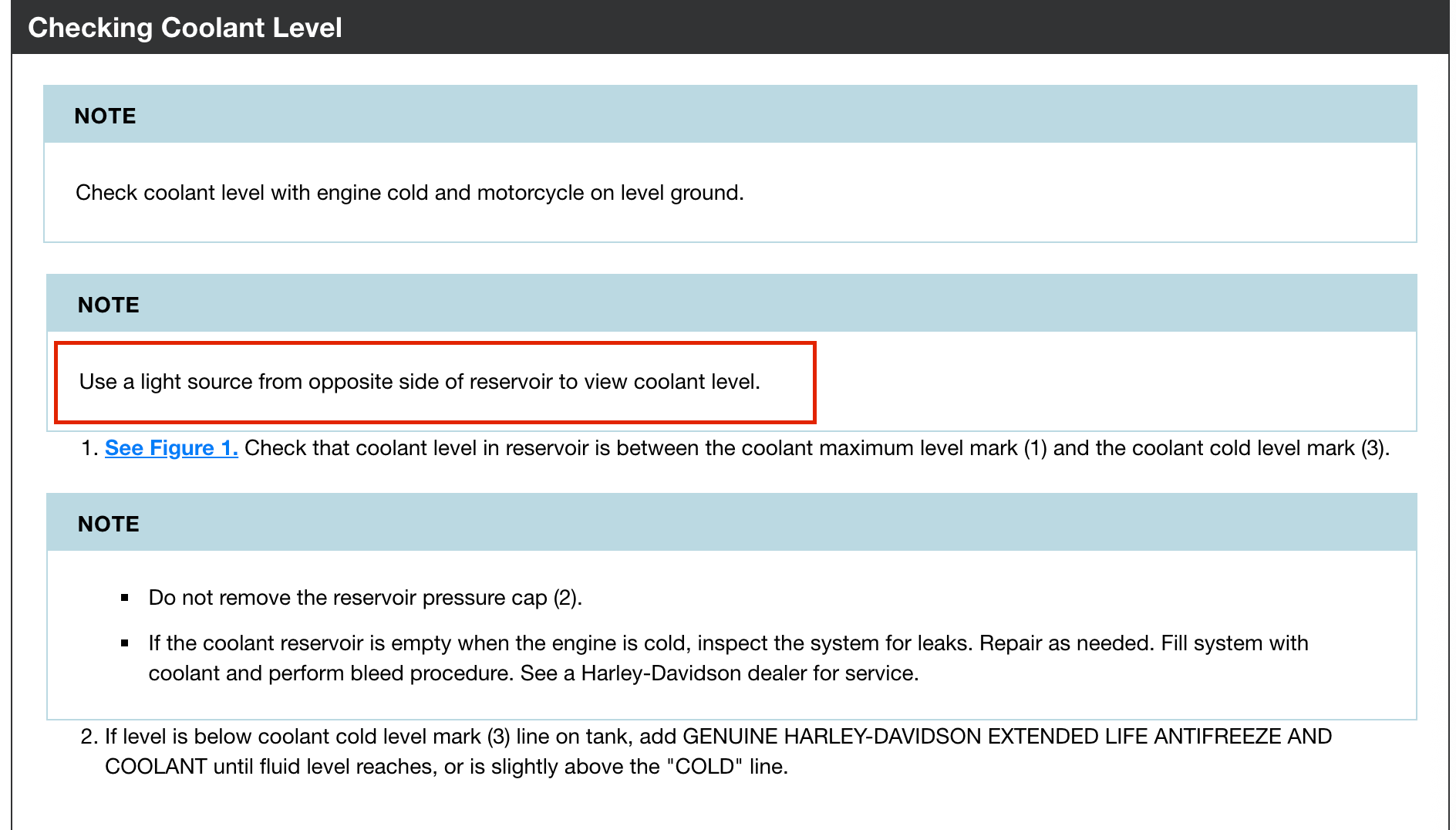

I have not even looked, but I know it's damn hard o see in the reservoir

davey, do you have the oem pink coolant in yours? Mine is the pink stuff that came in the bike and it’s really easy to see. Maybe not from standing up, but from kneeling down, it’s pretty visible

One word - flashlight
Just like the manual says
Exactly !

HERE is a service video showing the flashlight method on the reservoir of the dealer tech checking the fluid level. Also shows the way to check to see if your fans are working.
