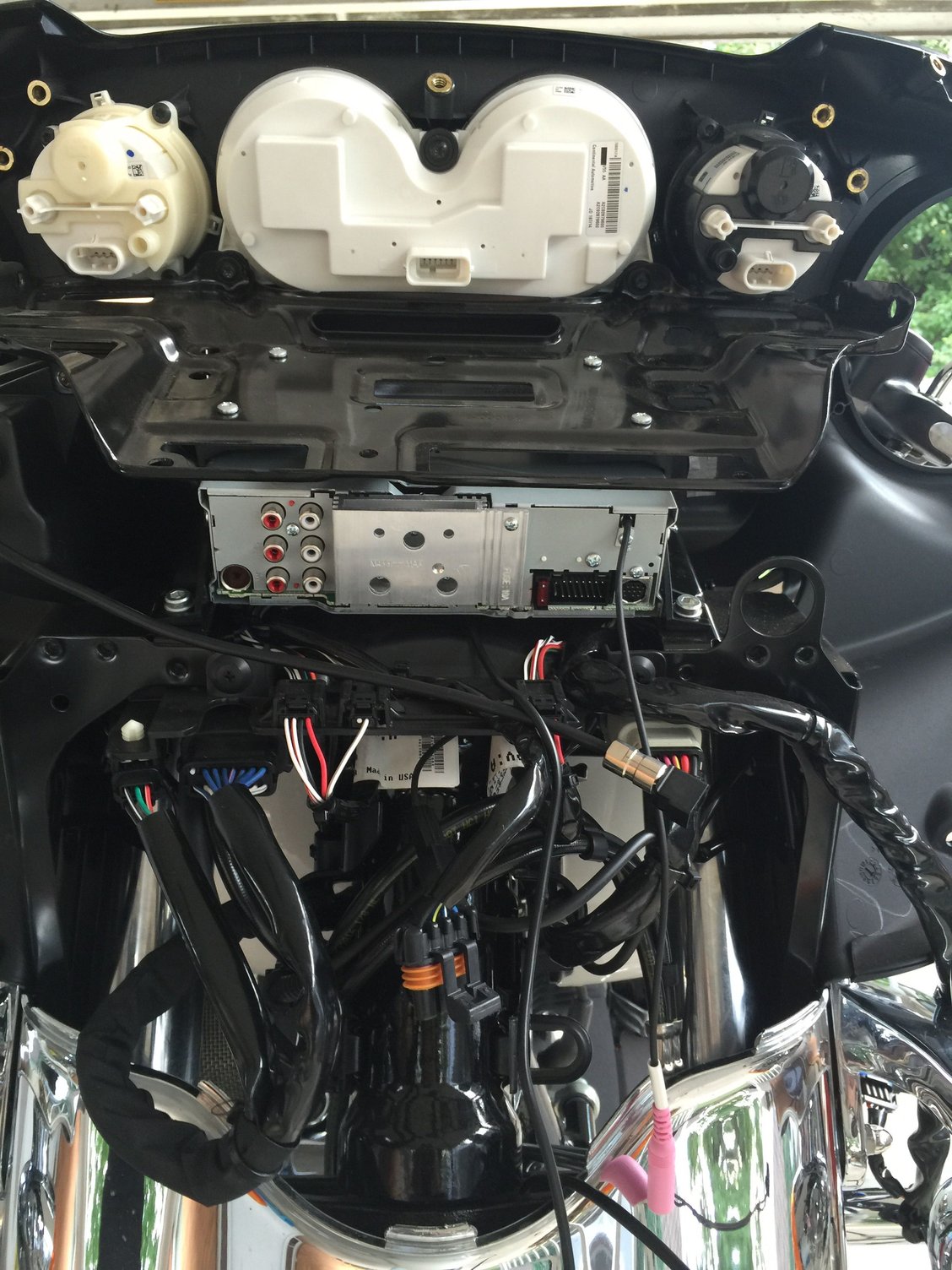

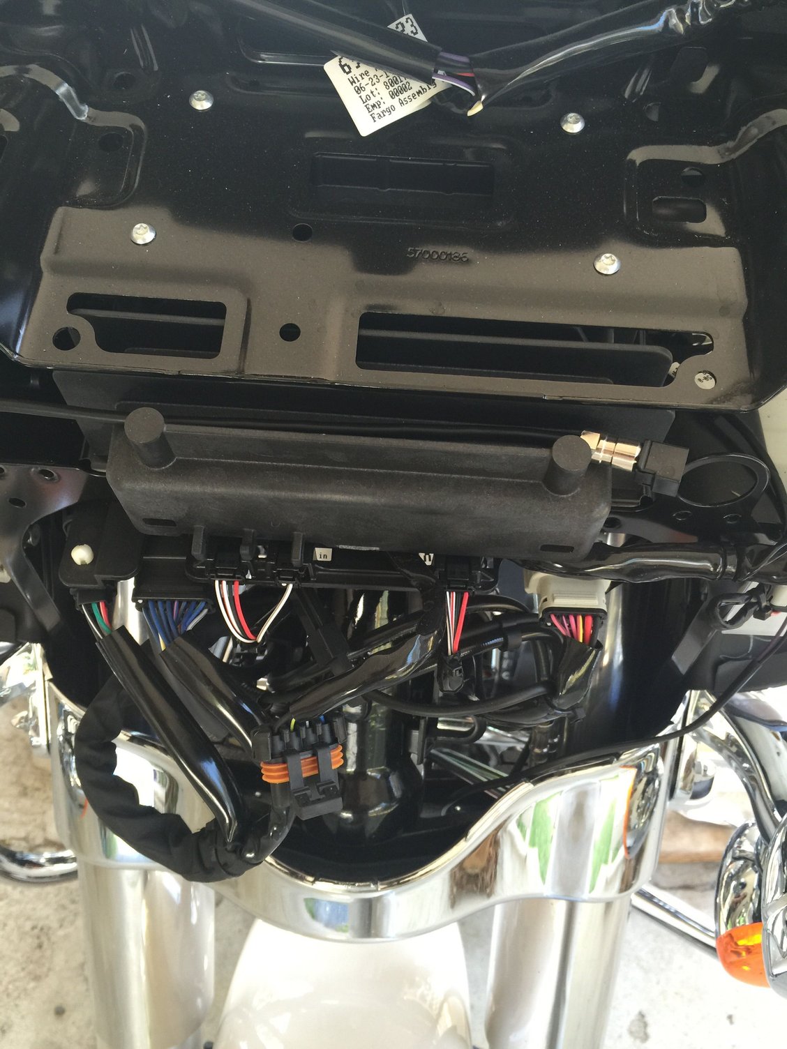

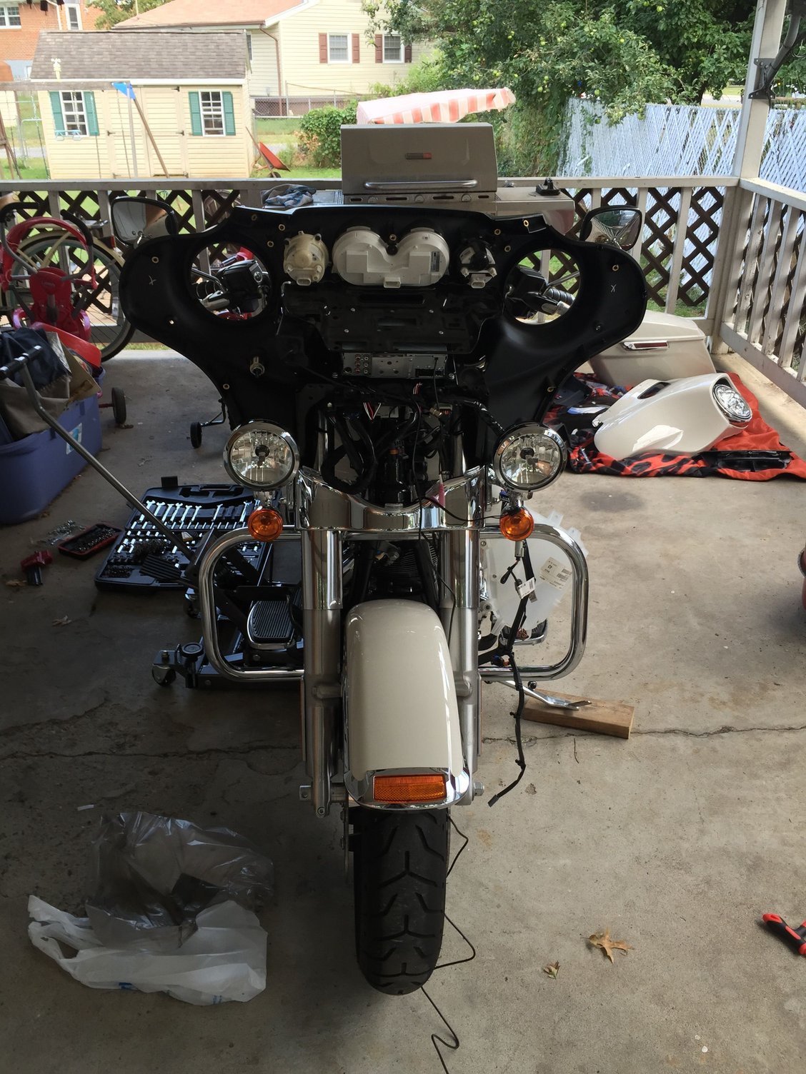

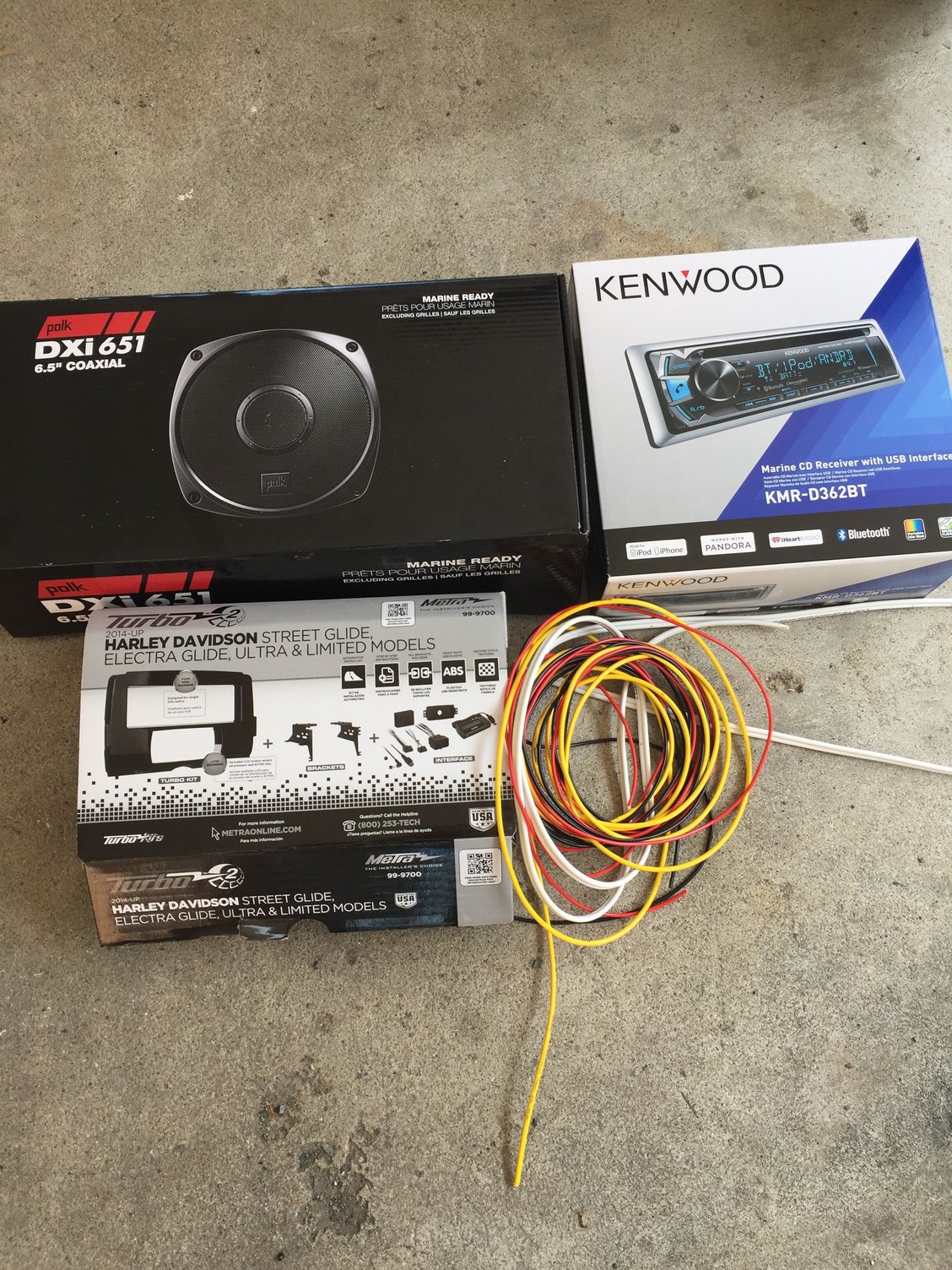

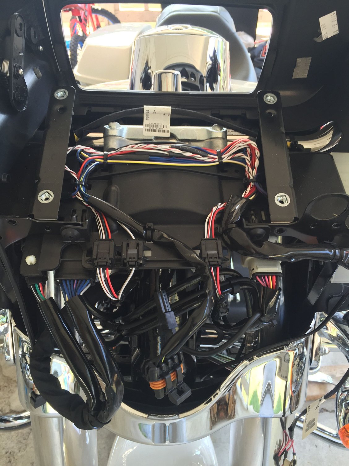

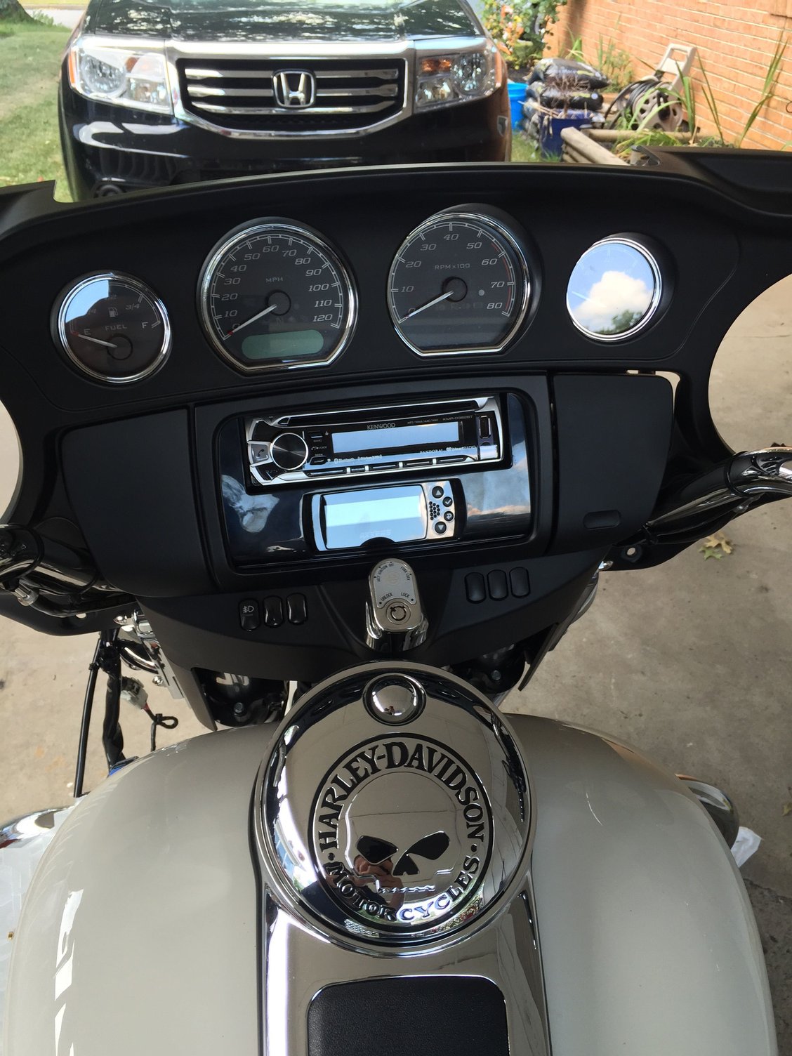

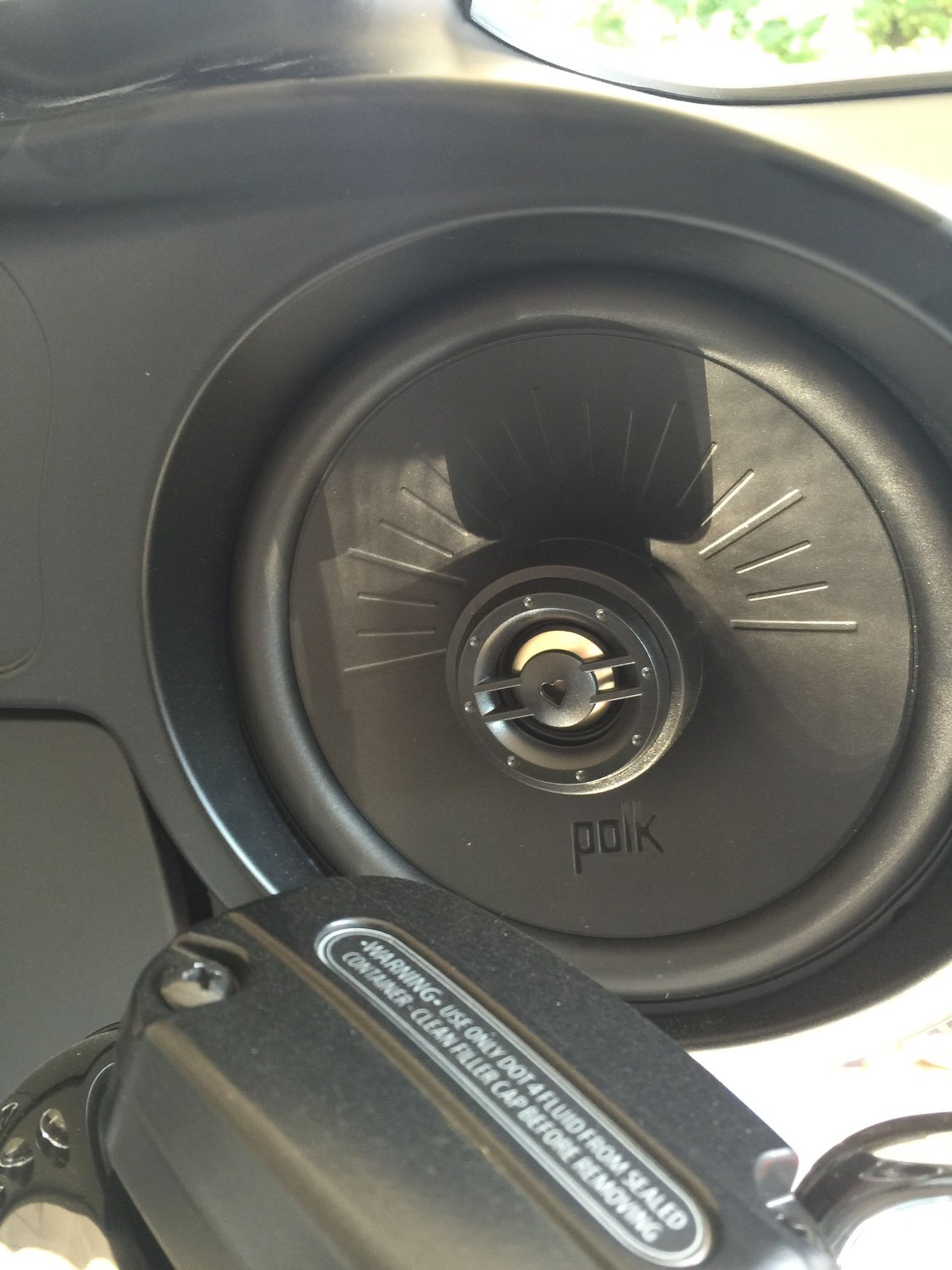

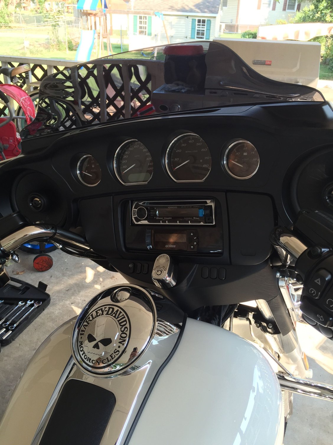

Hello, I finished the install. I used metes kit 99-9700, kenwood marine radio, and Polk DXi 6 1/2 speakers. I had to remove the factory speaker grills because the tweeters stuck out to far. This was all done on my 2015 Police Glide. So I had no wiring harness to use. I ran power to the Battery, negative to the ground and Acc to yellow/black wire in main harness. Total cost was $340 from crutchfield. Took about 4 hours total from start to finish. I dropped the ground wire but, so I spent some time searching for it lol.
Test ride was done on I 64 at 80mph. I had no problems hearing it and it was clear. I haven't had any problem with a CD skipping. My only problem was I don't have a FM antenna yet. No one has one in stock so it's on the way. Everything from the kit worked perfectly as stated in the instructions.
