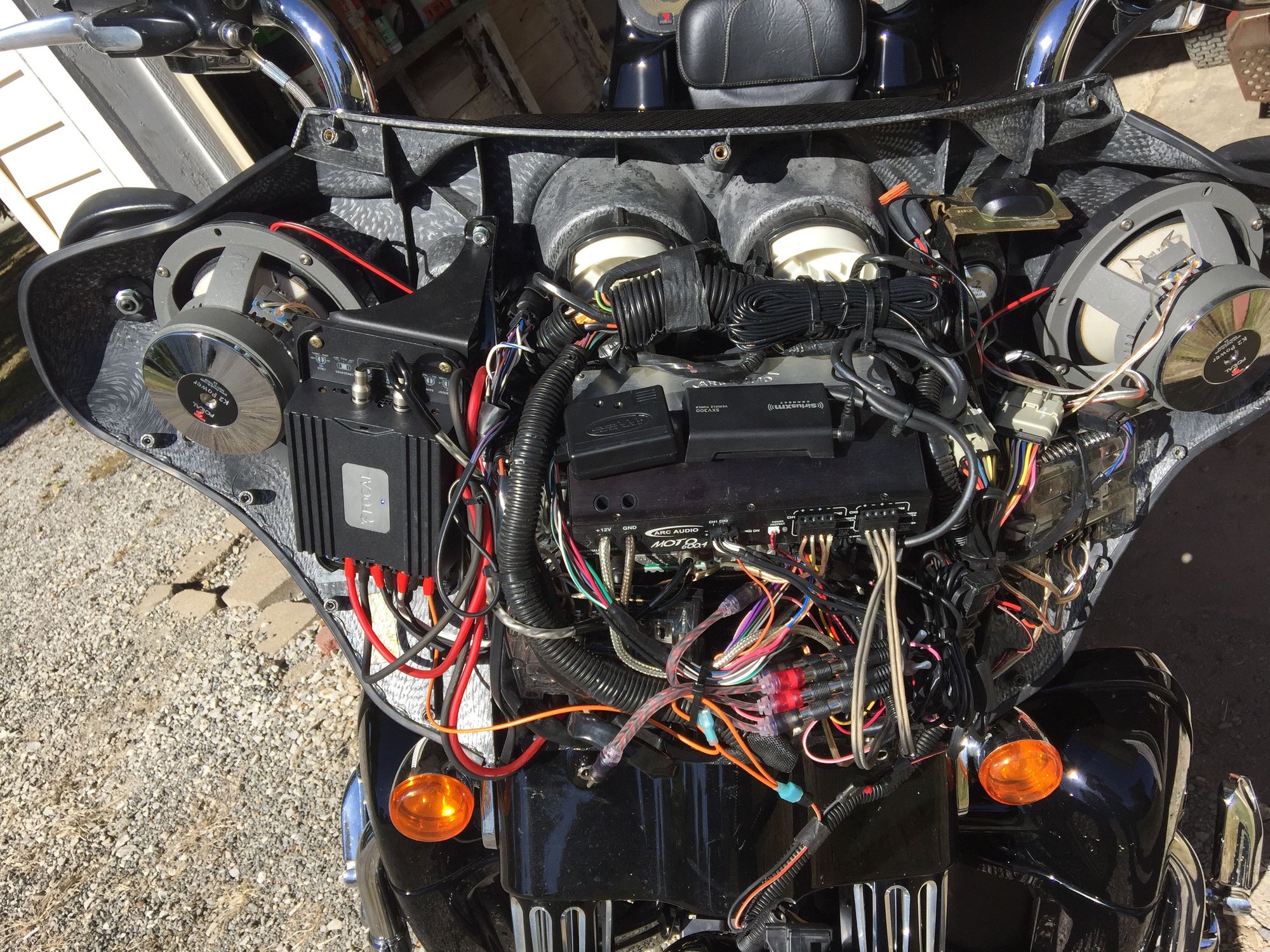

Mount it in the fairing, That way all you have to do is run speaker wires to the pack with quick connects if you remove it. You can fit 3 amps in the fairing.

From: Southern IL
This is where I have my second amp. Awesome mount, so much stronger than the fairing support that goes over to the speaker.

Nice mount, but not gonna fit with the 7.1s and their brackets. ('15 Limited Low)

From: Southern IL
These are 6.5" and there is still room for the 7.1
Won't fit like that on the Rushmore bikes.

From: Southern IL
Correct, It will not fit like this in the rushmore bikes.
