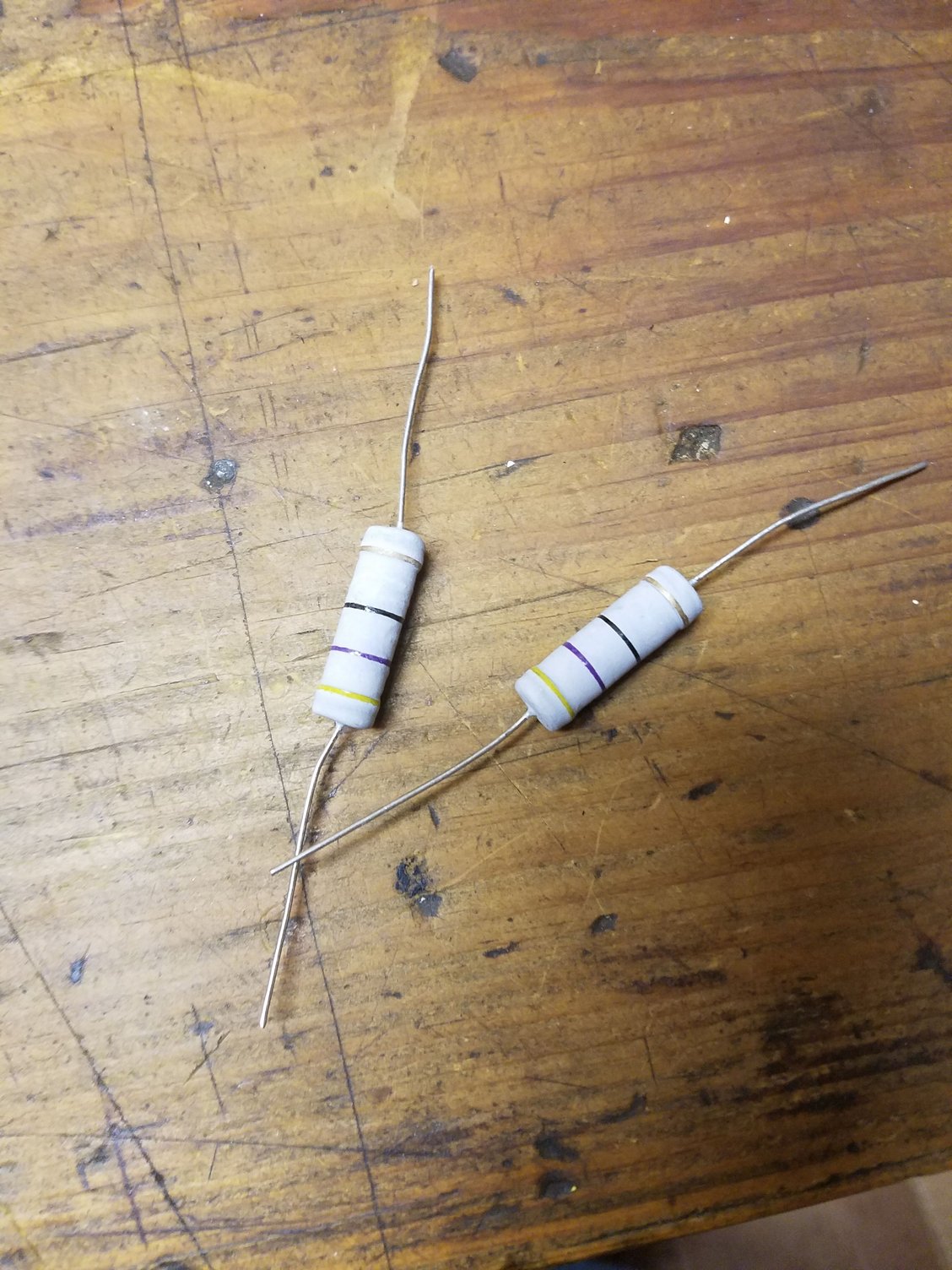

You need both RCA plugged in.
My guess on the resistor is so the radio sees a load if you are using high level inputs. If you are using line levelers you don't need it.

Ok, hmm. If you can post a picture of these compasitors. Not sure what's goin on.

Old Dec 24, 2016 | 11:13 AM

Ok I'm going to take some guesses here.
1. The gains are going that high up without showing red distortion because the LL input voltage is so low. It's called an "input" gain. The less the input the higher the gain. If it sounds good, set it by ear and forget about the stupid light.
2. I'm pretty sure I read a while back that the rushmore HU's require a load or the shut off. No load = the radio thinks no speakers are plugged in (speakers provide a load, an amp doesn't). So diamond is giving you resistors to provide a load to the radio in the even you were not using some type of converter to use RCA's. That's my guess, if I'm remembering that correctly.
