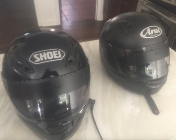

Helmets are Shoi and Arai 1100 an SignaQ

Two Helmets
Old Oct 25, 2017 | 11:41 AM
