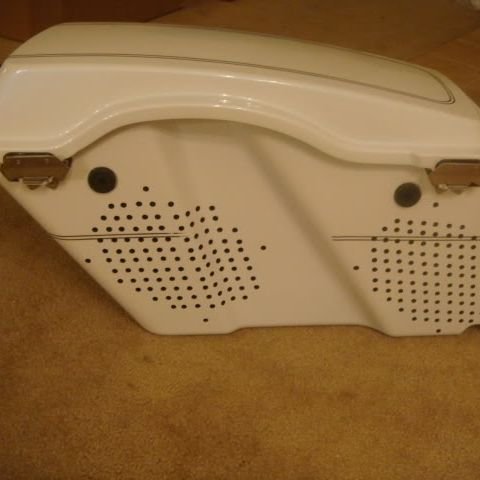

I don’t bike at the dealer for service. It ha a bunch off of holes drilled where the 6x9’s are at. I will get pics once I get the bike back. They are similar to holes like this

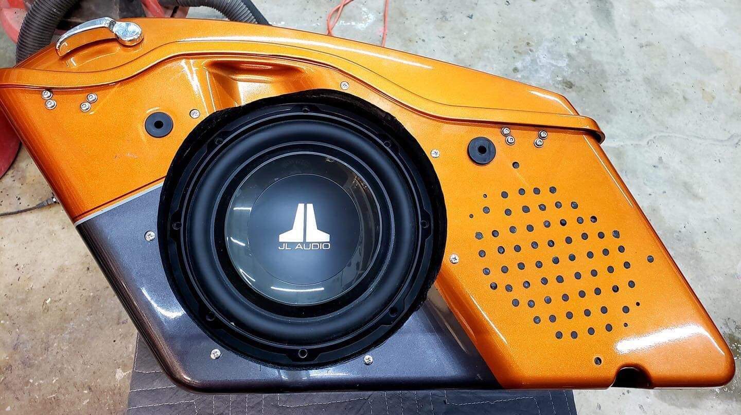

Jefe custom cycle. Not sure what he used to fill the 6x9 holes.

I had an AHB 8" ring kit innthe back of my bags and had to patch it in order to put 10s over the shock hump. The previously mentioned, tape off the bag is a must. Tape all of it off. You've got expensive paint on there, mask the entire bag. I taped mine, tripled up where the gaping hole was and then from the inside I started laying fiberglass mat and dabbed on resin. Repeat until the thickness matches the bag.
In your application, (if it were me), double tape the holes and make sure the tape is on there really well, lay the tape side flat on a workbench and paint a thick layer of resin down, lay a single sheet of glass mat and dab it down with remaining resin. Just make sure you're putting enough resin on the precoat and then on top of the mat to fill the holes. Let it harden up and see what you have. If it needs another layer of mat,,cut another piece and repeat. If not, put another coat of resin on top and get it nice and smooth.
I'm sure there's a million ways to do this, that's just how I've done it. You can also use RIT dye on your resin to try matching paint color (unfortunately with white bags, you cannot).

Thanks for the info those aren’t my bags just a picture from the google machine. I have electric orange and black bags
