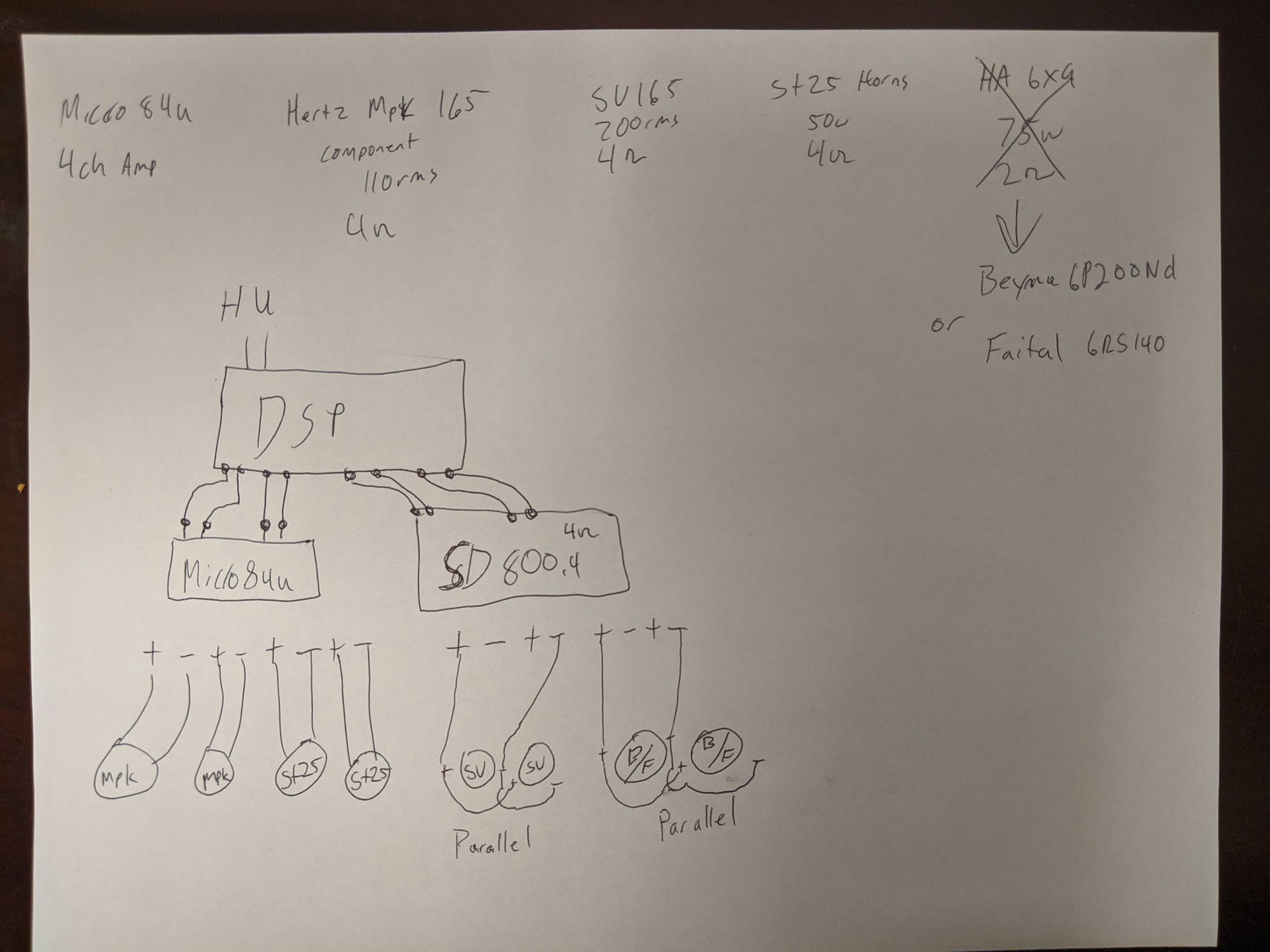

I know you're frustrated but there's a lot of truth to what everyone is saying. Here's a suggestion though.
Keep diamond amp use it for the mpk's and st25 horns. Get a soundigital 800.4 4ohm or similar spec amplifier and either Beyma 6p200nd or faital rs140 6.5s to replace you're 6x9s and make a adapter plate for them and horns for your lids. Use the sd800.4 to power new 6.5s and sv165 each pair in parallel. You will need to do some adjustments in your dsp but unfortunately I am not well versed with the dsr1. Here's a n example of how it would work... I know it's not pretty

I did some testing tonight after I got back from working on painting the bike and @InthewindMN you are 100% right, separating everything to individual channels definitely cleaned things up and seemed louder.
I disconnected everything, pulled the MPK junk tweeters and crossover out entirely then ran just the MPKs off channels 1 & 2 of the Micro84u and adjusted the tune on the DSR1. I was able to turn the amp all the way up and it never distorted (unlike before) which makes sense because the speakers can handle 110 watts and the amp is only pushing 90 watts per channel.
Then I put the SV 165s on channels 3 & 4, unplugged the MPKs and did the same thing. Again amp all the way up and the speakers never distorted, which again makes sense because they can handle 200 watts as @c_mancuyas8 graciously illustrated.
Just for the sake of trying, I then put the BT2250 on the Sub channels coming out of the DSR1. I left the ST25 horns in line since they have similar power specs (which is a disappointment as I was under the impression that the Hybrid Unity 6x9s wanted 150 watts), but that did NOT work. The BT2250 is presumably pushing way too much power and when I turned on the bike the 6x9s made a LOUD “pop” sound. So I disconnected the MPKs front channels 1 & 2 on the Micro84u and connected the 6x9s and ST25s in their place. I didn’t put the amp all the way up, since the 6x9s are rated lower than the 90 watts it pushes, but both the 6x9s and ST25s sounded very clear and louder than they had been.
So, the answer to optimizing the speakers I have is definitely a second amp, and the SD800.4S c_mancuyas8 mentioned seems to be a solid fit pushing 110 per channel which matches the MPKs perfectly. Leaves a little on the table for the SVs, but would probably be the smartest and most economical move. The Diamond Audio HXM800.4D is $200 more and only pushes 10 more watts per channel.

You could use a 2ohm 800.4 and parallel those 4ohm speakers. That would give them 200w each.
