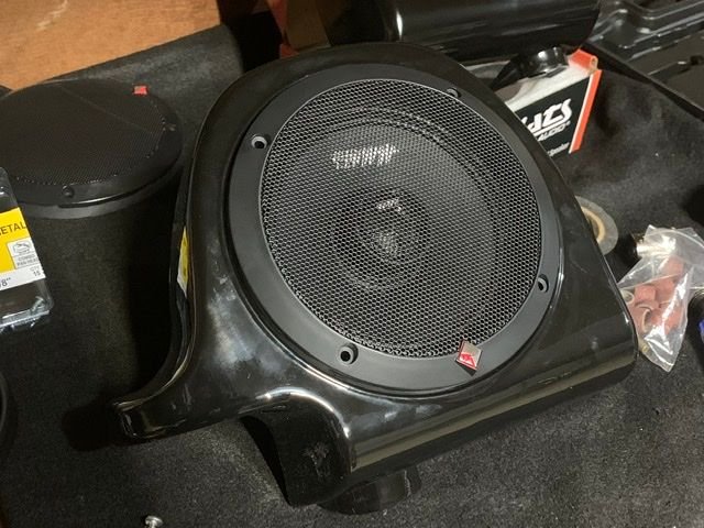

So this is on pause until i get the proper supplies, any suggestions for the Grill problem? The grill with my 6.5” MMATS doesn’t fit my advanblack lower speaker pods.

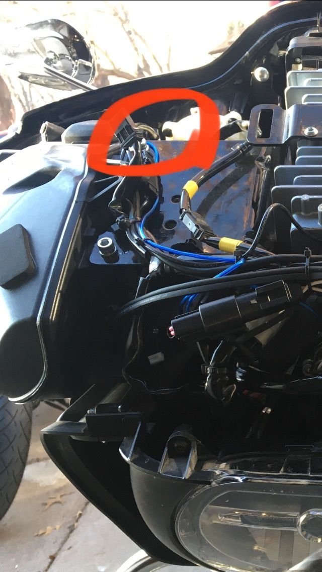

I’m really sorry for such noob questions, but where is the 12v, ground, and remote wires? There were no additional wires I. The stinger box
There’s a powered ignition source in a connector in the upper left of your fairing as you’re looking at it from the front. It should be a purple with blue stripe I believe. You can check it with a volt meter to be sure. Harley does make a connector for it to plug in if you choose. It’s about $10. You’re going to need a cable kit of some sort to run from your battery up the backbone under your tank to your fairing. Mine was an 8 gauge. There’s a plastic piece to pull off that you can tuck the wiring into.

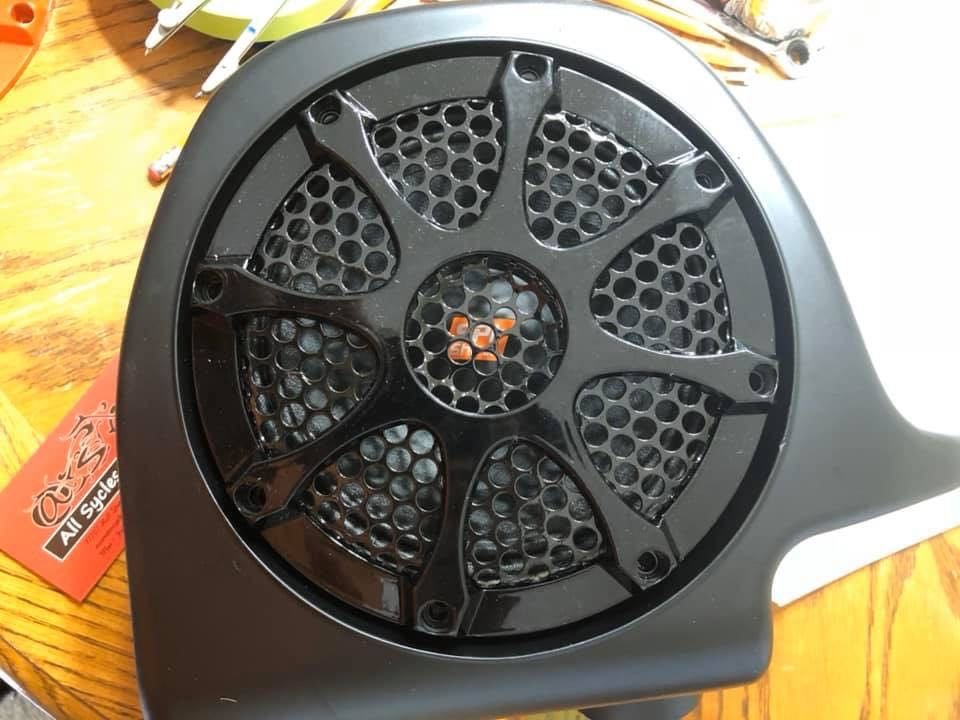

Had the same problem trying to find grills. Bought some Rockford grills for cheap on eBay. Still had to do a little sanding with a dremel to get them to drop in. Here’s what they look like with the Mmats...
Looks great! Thank you for sharing that. I bought a different one before I saw your response. I got hosed on the price but it is made for advanblack lowers.
