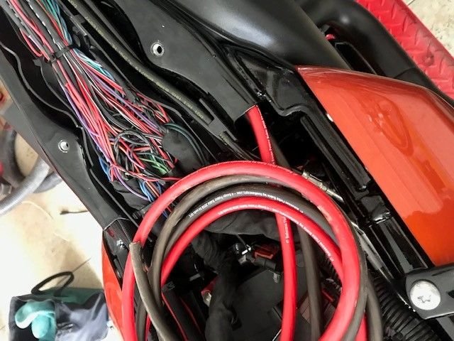

I managed to get 4 awg power and ground thru one side and 6 speaker wires on other side but don’t they potentially run together part of the way.?

It can be done!!

This is great information. I just have a few followup questions.
  1. Do you still need to pull off the gas tank to do it?
  2. Is there anything sharp that the wires might ride against when pulling them through?
  3. Did you all use fiberglass fish tape/rod? Is it easier to fish the wires from the seat/battery side forward? I took a quick look yesterday and didn't see the outlets up by the neck? Anyone have a photo?
  4. If I want to run the power down one side and the ground down the other, which side should I run the speaker wire?
Thank you.

You don't need to pull the tank. I had it off to remove the wires I had previously run in that tray.
There probably is sharp stuff in there. I pulled mine back out and put sheathing on them after the picture.
I took a piece of 12/2 household wire, used just one of the wires. Fished it from the front until it exited on the side I was on. Then wrapped new power/ground wire (one at a time) to the fish wire with black electric tape. Pushed new as I pulled the fish out. Slowly.
I ran power and ground on right side, speaker wires (6 sets) on left side. I chose that way since a fuse will go between the battery and cable so it can rest in front of the battery. For me just preference.

I will give it a go and wrap them before I pull them through in case there is anything jagged. Like you said, slowly.
