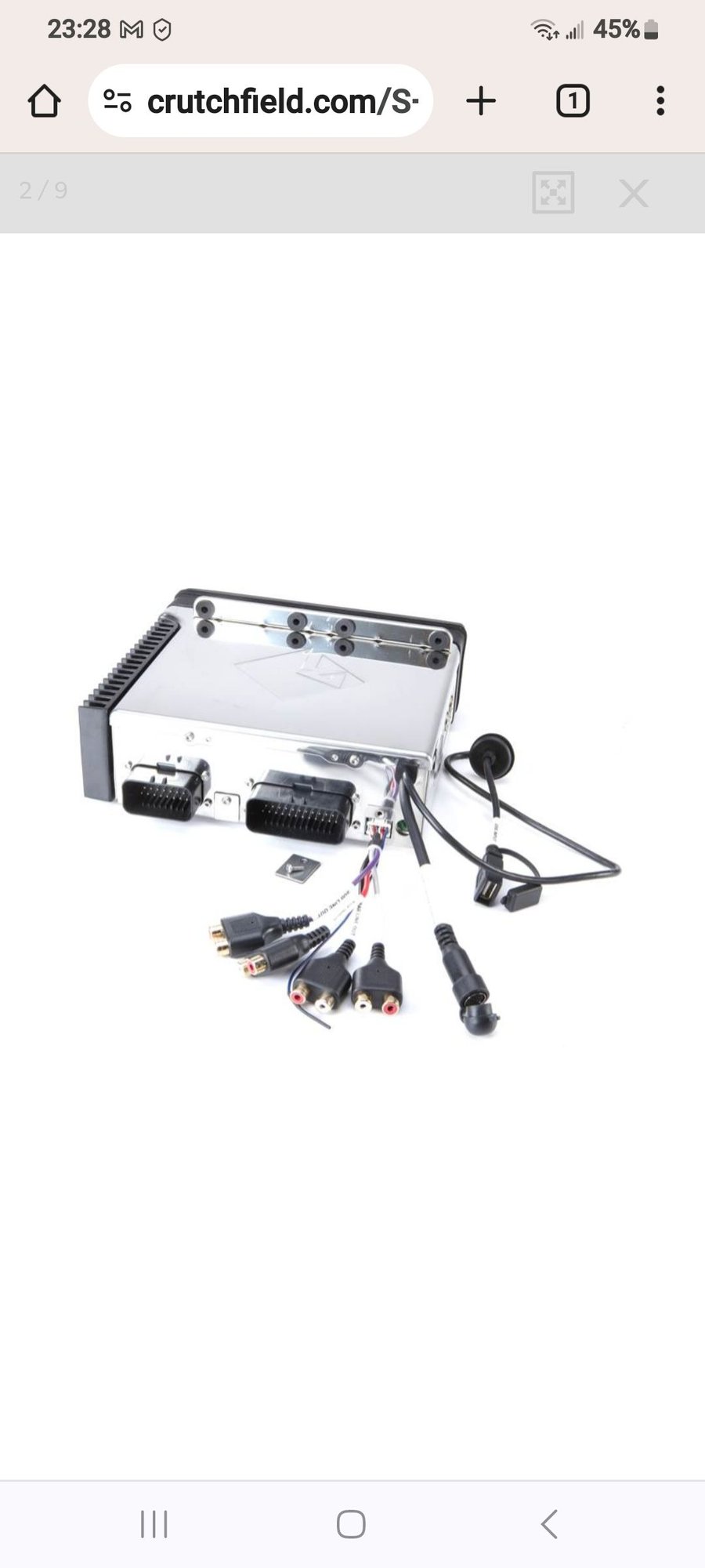

The headunit should have came with a plug with rca 's on one end.This plugs into the headunit behind a little plate you have to remove if I remember right. Then you can use rca's to connect to the amp. Without needing a line out converter.

Old Feb 6, 2024 | 02:23 AM

Originally Posted by madhunter60
Ok. I figured as much with the RCA’s.
Thank you!
