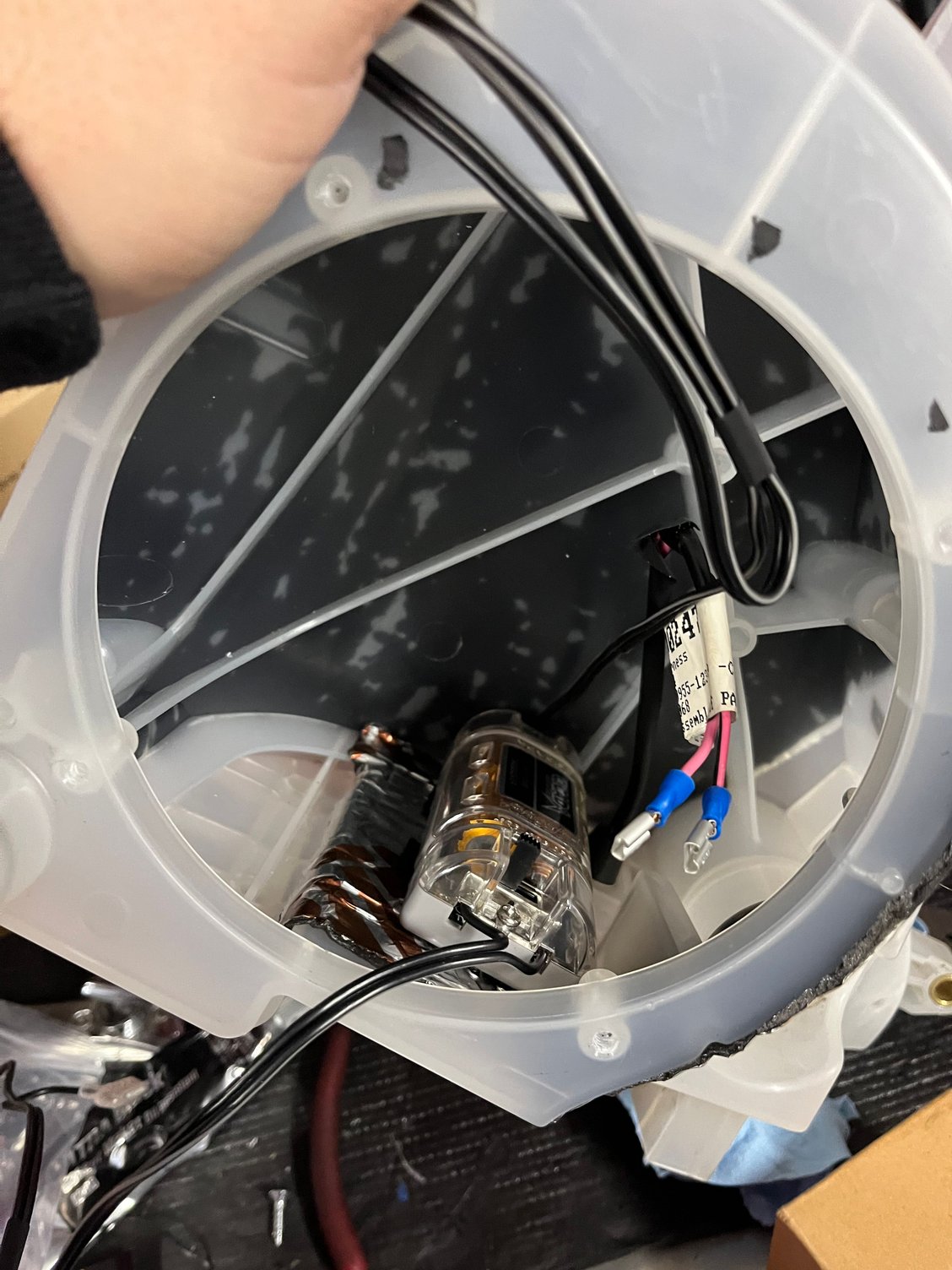

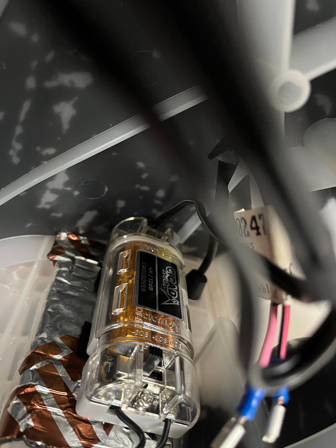

Changing out the fairing 6.5s to some cicada chx65 speakers and I’m not sure where to put the crossover they come with. Do I mount it sone how inside pod or mount them on the outside some how?

Yes, they're not that big. I forget, but I don't even remember using velcro. Though I may have.

I have used those speakers on numerous bikes and normally secure the crossovers inside the pods to keep the pods removal and install easier.

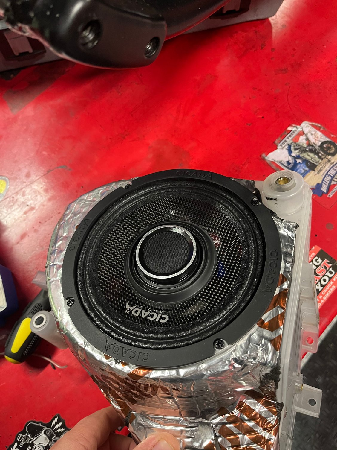

Ok. I was probably just over thinking it then. I got them mounted in the pods using Velcro, screws and/or zip ties.

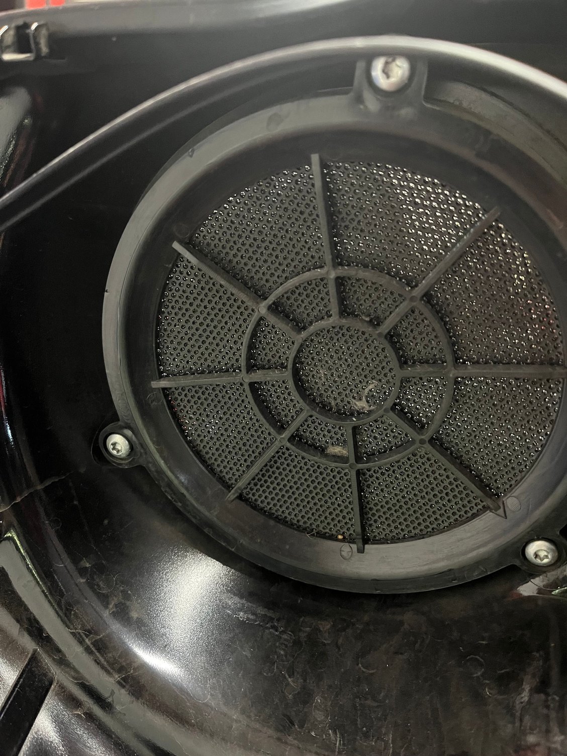

But found something when pulling the pods out. It looks like my speakers before were hitting the framing of the grill in the fairing (you can see witness marks on the speaker surrounds). Anyone seen this before? Will these cicadas have the same issue? Looks like the Focals have a larger rubber surround that sticks out from the mounting ring when compared to the Cicadas
You have the NEW style Cicada with the thin rubber gaskets and you will not have any issues with the speaker rubbing on the grill mounts/screws.
Now if you have the old CH65 version 1 there would be issues hitting.

Ok thanks. Whats the fix if using speakers that do hit the grill structure? I never thought the Focals would hit.

To answer the IF question to keep speakers/surrounds from hitting the grills is to mount the speakers on the inside of the pods if clearance allows or make sure to purchase a speaker that will work in that location.
