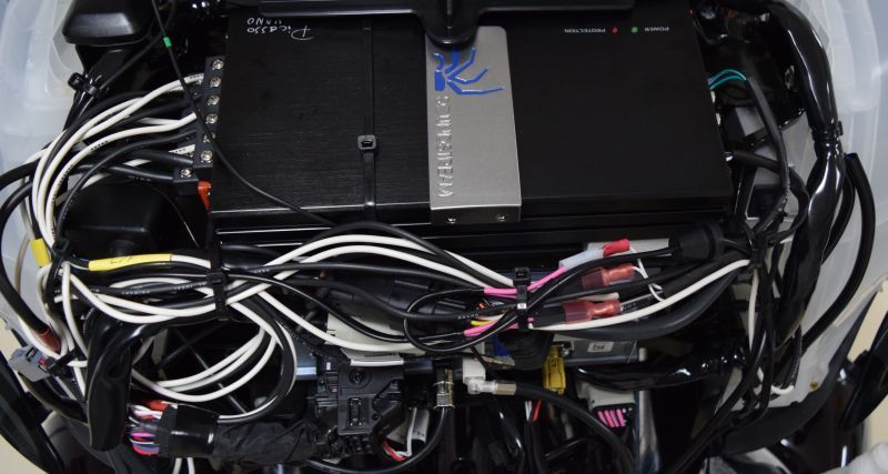

For the front, on the SS amp I used male disconnects. There are two differant sizes, if you cannot find the smaller size the larger ones can be cut or filed down to fit. Then crimp them on to the high input plug wires that came with the amp. The disconnects get plugged into the existing female speaker wire plugs that go to the speakers. No cutting of wires for the front. Then run 16g wire from the speakers to the amp output.
