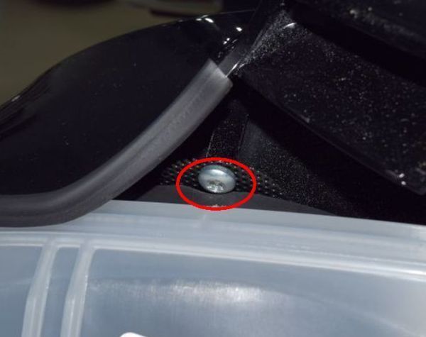

Originally Posted by Grich171
How did you get them to fit mounting them on the outside? pics?
Here are the Kappa's installed on the outside of the pods.
A pic of the notch filed to fit around the Boom grill screw.
And a pic of the Boom grill modified to so it would not come in contact with the Kappa tweeter.

I had clearance issues doing it that way , the Boom grill would be in contact with the outside spider of the speakers in the 12 O'clock position had I done that ? They were good at 6 O'clock though , I don't believe the fairing opening sits over the speaker centered , the HD one yes but not the Kappa.
The slightly smaller diameter OEM speaker cone & spider are just enough smaller to clear / center in the fairing opening.
I know lots of folks here have mounted the Kappa's the same as you and seem to be happy with the performance. I wonder how many are sitting on the speakers as it's pretty hard to tell looking though the grills ?
Is this a problem , I don't know but I mounted mine inside the pods because of this .
