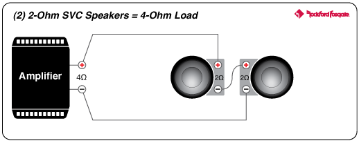

I was just on the RF website looking at the wiring charts. I'm installing the 2-Ohm Infinity Kappa's like a lot of folks here. I've been out of car audio for a long time so I'm not sure I'm reading things exactly right. So since the Kappa's are 2-Ohm speakers, is everyone wiring them up like this?

No sir that's not the way you want to wire this up.
what amp and how many speakers total?

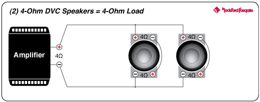

Yeah, I just realized what SVC and DVC stand for. The Kappas are DVC for Dual voice coil so the wiring is like this......

negative. :-)
how many speakers total and what amp please?

Oy.... RF PBR300X2 and the Infinity Kappas on a 14 SGS..... If you're a moderator please just delete these posts...... Thanks for all you do UN! And the pun.......

you'll simply connect R+ on amp output to right speaker +, R- on amp output to right speaker -.
then do the same for the left side
