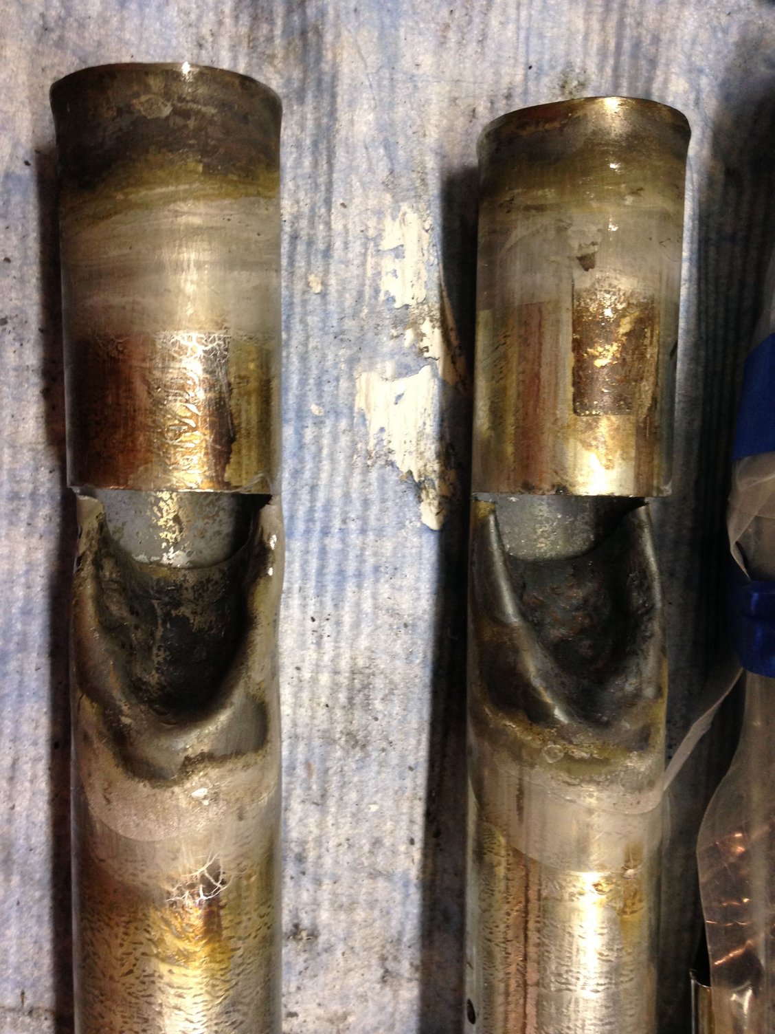

When I bought my scooter used, it had the baffles removed. Well it was too loud and the gas mileage sucked bad, "32 mpg" So I had the material, "electrical conduit." and went to making them.
These pics are version one. I've since opened all the holes to 3/8" and added about 10 more holes. Then opened the bypass flute to let about 40% of exhaust straight out.
They have a nice tone, and the mileage went to 43 mpg average.

I made straight through types using perforated metal but none like that. I not a believer in adding back pressure like that.

Cool, good to hear others have went out on a limb to be creative with air flow. I'm on the 4th generation with these. Every change equates to more air flow.
I have a high flow air filter, fuel injection and a tuner. This combo seems to be the ticket for now.
Have not tried the lolli pop system yet. would that be better than a conventional baffle?
When I hit 55-60 mph now, it quiets right down with power to pass.

No.
Cut 1/2 your scoop out and yours will work and sound better than any lollipop.
