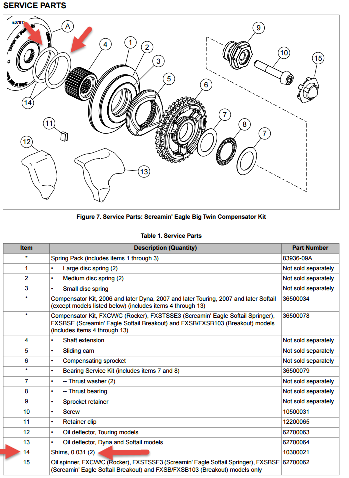

See the rotor there, there are two, thin steel spacers in that photo against the rotor, this photo is before I removed them during tear down. I kept them in a stack of all the compensator springs all in order and it's a good thing, cause I'll be damned if I can find mention or photo of them in my SM nor could parts or service at the HD shop find any mention of them anywhere.
I try to stick with the book and although I can't find them in the SM that's where they came from and that's where they went back
Suede, you just have to be in the know, y'know?

Excellent work Matt'lock, you've cracked this case!
Thanks for clearing that up
