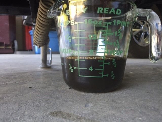

So I ran the bike for no more than 10 minutes to get to operating temps and pulled the case plug again this time with the bike straight up and pulled about 9oz of oil out. Not sure if it makes any difference but this was with no riding between the last check simply running the engine for 10 min.
I assume it's safe to say that one way or another the bike is Sumping. So back in I go. Picked up another set of cam chest o rings and gasket although I now realize I didn't get new exhaust gaskets (sucks since they were just replaced). No lifter magnets so lifters will have to come out too. I'll be a freaking push rod expert by the end of this.
I've never removed the oil pump from the cam plate before, what am I looking for to be the cause of my problem? O rings torn or mispositioned, what else?
Thanks as always
