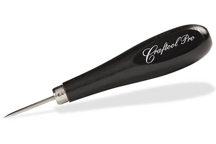

Ě forgot to mention, the tools you have for making your sewing holes are actually for leather lace, not thread. They will do but your holes will be oversized and could cause issues down the road.
You need a diamond stitching Awl and an over stitcher to mark your where your holes will be. More work involved but more rugged and a way better finish.
