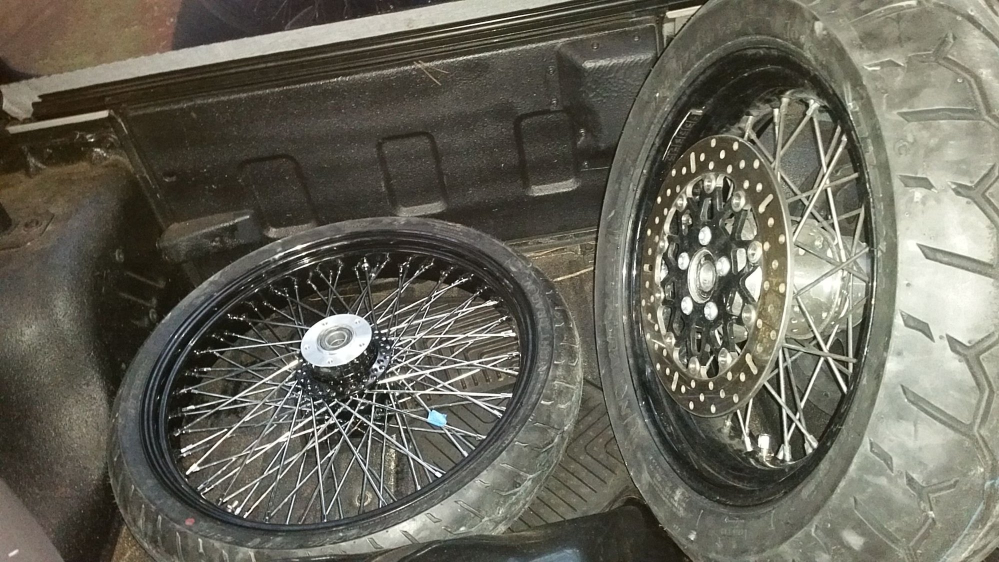

From: Tallahassee, Florida
Default removed tires...
tires removed
broken dreams... Rear, (180/60-17, Bias Ply, 17, Tubeless, 75, V $100 + shipping)

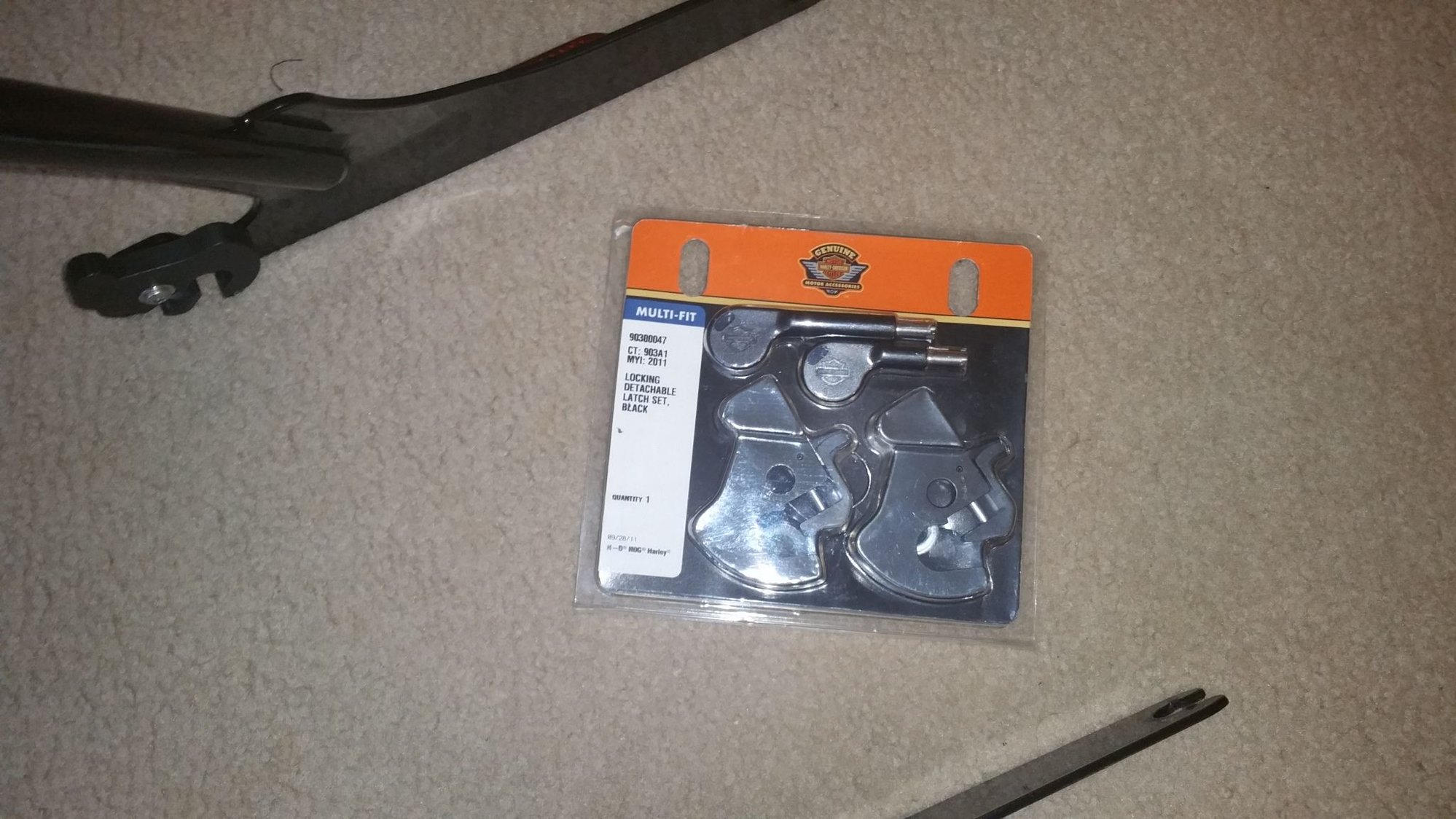

Default put the bike on the ground and added locking detachable hardware...
Put the old tire back on the rear (so sad)... and to the bike off the fear lift. going to take it out tomorrow.
wet from me washing off the various grease and nonsense i got all over it over the past weeks of work.
added the locking hardware to the detachable sissy bar that randomly appeared on the bike and i never mentioned.
Parts used: 90300086
Locking H-D Detachables Latch Kit- http://www.harley-davidson.com/store...-90300047#tabs
locked down...
