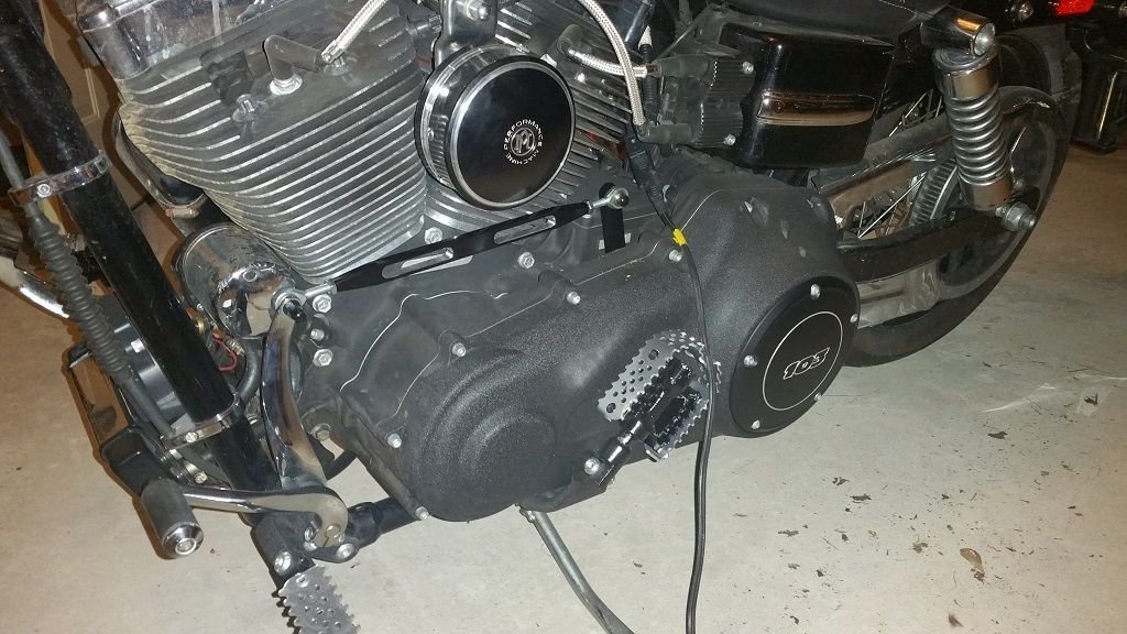

well, i went out to test out the gummy paint pedals. i will not be extending anything as long as these things are on my bike.... not sure how long i can tolerate them. the pdeals roll with my feet on shifting/braking activities. kind of weird and the were a few times where my foot almost got caught between the spinning pedal and the shifter/brake pedal. it's better to have nothing over my foot than to get caught in that mix.
they feel better than the pegs but, they scare the s*** out of me. will take time to get used to. almost need a heel toe shifter with these things.
time will tell... definitely not something someone learning to ride would want on their bike.
here you'll notice delayed/long shifts and fumbling:

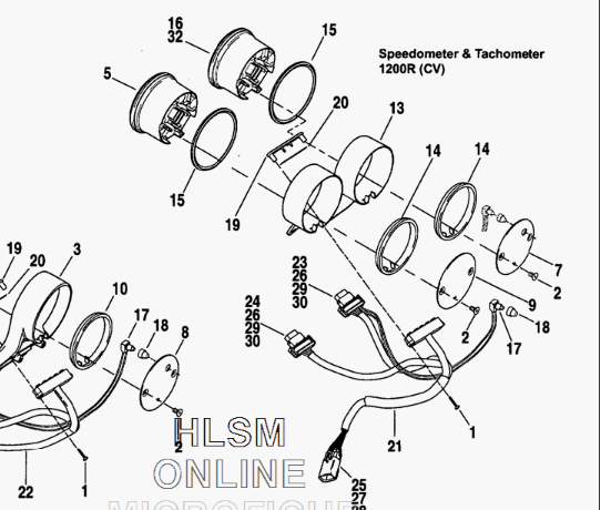

Default mickey mouse process engaged
I'm going forward with micky mouse set up. i think i've got the heavy hitters out of the way.
ordered:
  1. 67103-95 TACHOMETER COVER, BACK, CHROME x 2
  2. 67338-97 SPEEDO/TACH BRACKET x 1
  3. 692006-15 WIRE HARNESS,INSTRUMENT ASY x 1
  4. 74541-00 KIT,COVER,BEZEL GAUGE,INSTRUMENT x 1
  5. 670000-10 TACH,4/5500 RDLN,BLK/SS x 1
will be ordering front and rear cushinon/gaskets and screws... the just don't show on surdykes site... i'll get those from the dealer.
using the 2008 roadster as my source.
http://partsfinder.onlinemicrofiche....R%20ASSEMBLIES
crazy that the bracket, 67338-97, is so cheap. folks on ebay are trying to get 150+ for it. mysteries....
need a few parts that i'm not sure about.. starting a separate thread for visibility---> https://www.hdforums.com/forum/dyna-...l#post15579792

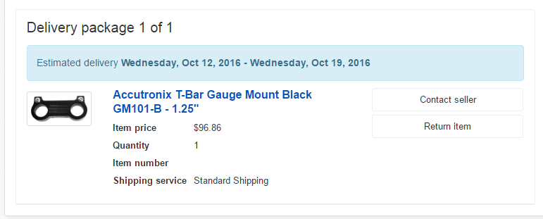

lucky dave Gauge Mount ditched in favor of Accutronix T-Bar Gauge Mount Black GM101-B - 1.25"
ordered-

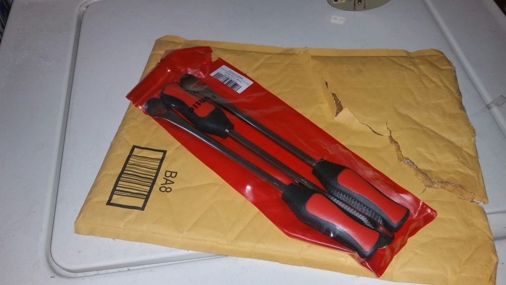

Prime spoons...

went in to the dealer and ordered the front and back cushions for the gauges and the screws
2 x 67344-97 (FR)
2 x 67345-97 (RR)
4 x 2361 screw

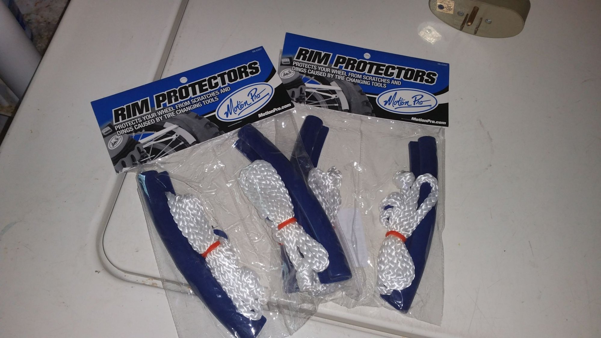

came home and found the rim guards...

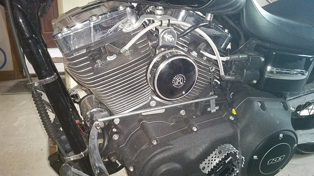

Added trim bits and fixed corrosion issue on forward shift linkage.

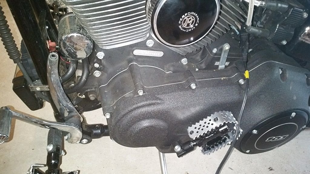

shift rod appears
before

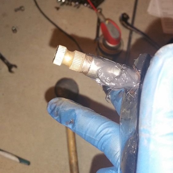

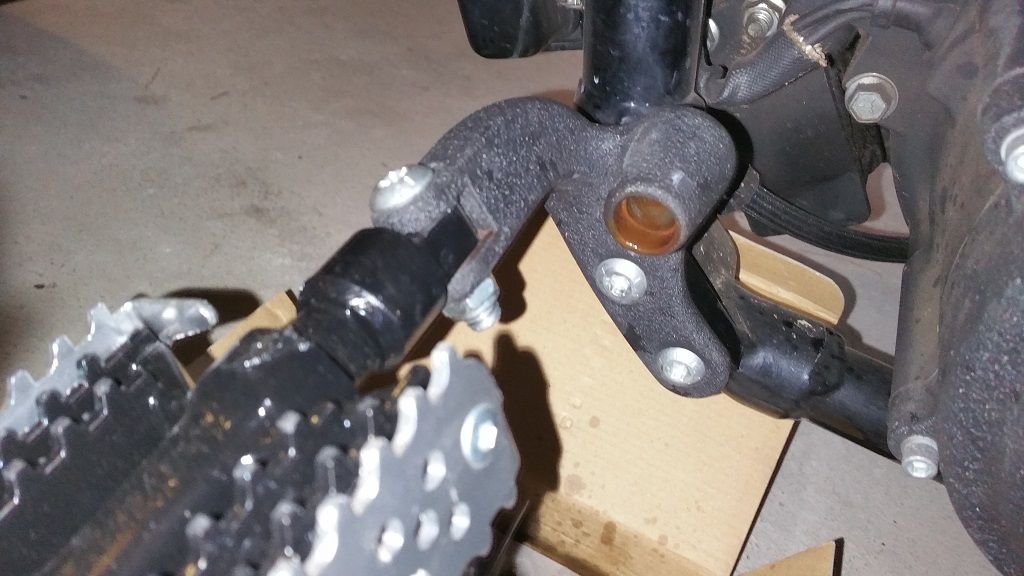

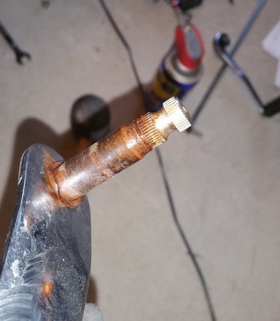

pulled front shift parts to investigate the corrosion that has been causing slow return on the shift peg.
the problem part 1:
sanded the rust and nastiness away and then polished.
the problem part 2:

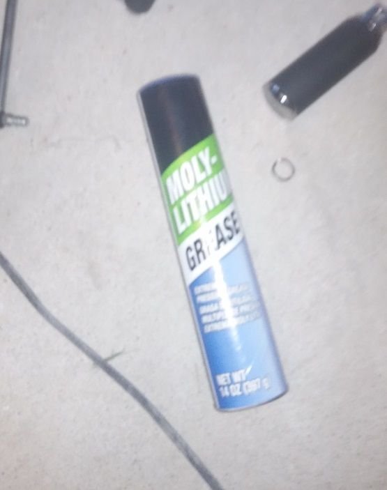

got in there with brake cleaner and a toothbrush. worked out.
non-cggorman approved extreme pressure grease.
slathered on the grease and put it all back together.
done, hd emblem facing engine on purpose (after)
