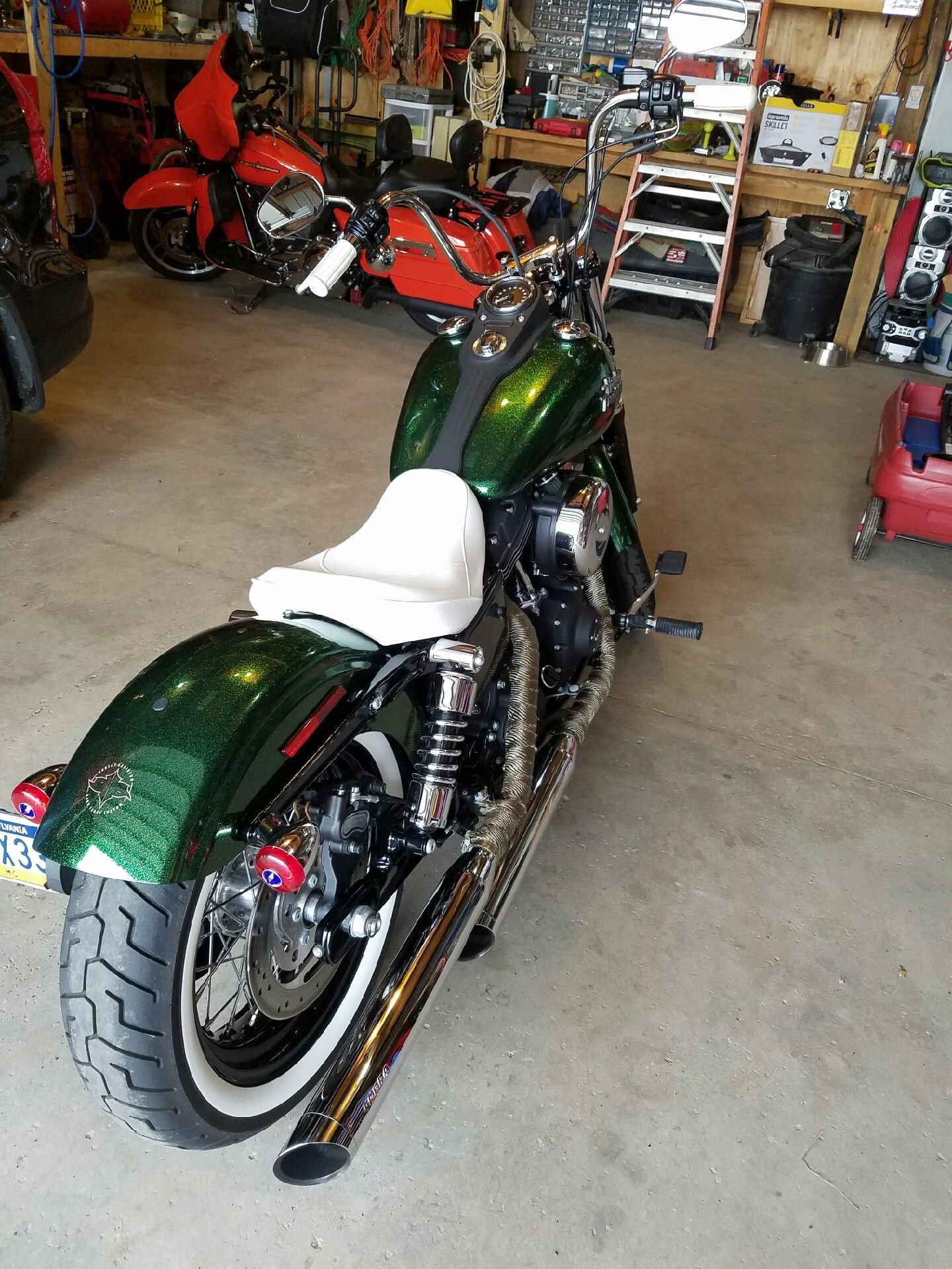

My son just got a 13 SB, has 925 miles on it. I rode it and I noticed it pops a lot more than I thought It should during shifts
It came with the header pipes wrapped in that heat cloth, I don't know if they are stock or after market. It also has Cobra mufflers on.
Dealer didn't know much about what the previous owner did to the bike
Any thoughts on the popping and how to eliminate the excessive heat coming off the header?

The popping is gonna happen if there is no map for fuel air ratio on the bikes computer. the pipes look stock to me (except for the mufflers). I have my aftermarket V&H pipes wrapped and i dont think its to hot... but if you do... get some heat shields for it. Also dosent look like a lot of stuff (aftermarket work) was done to the bike. no A/C, just pipes, new spark plug wires, fwd controls... seat and grips.. thats all I can see. Sharp Bike!!!!! looks great!

Yes the popping is because the mapping is of. No mapping can also result in running hot.
