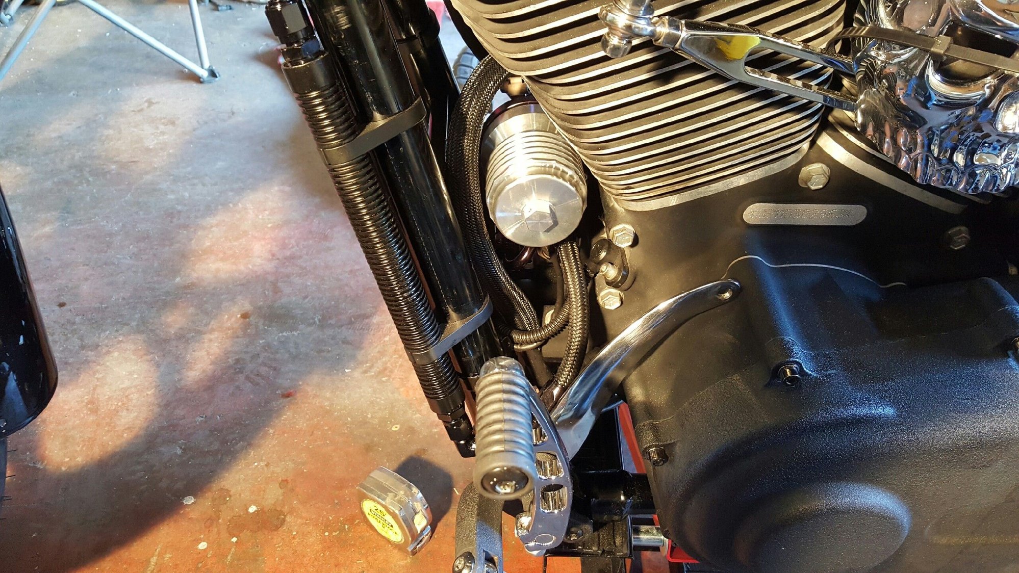

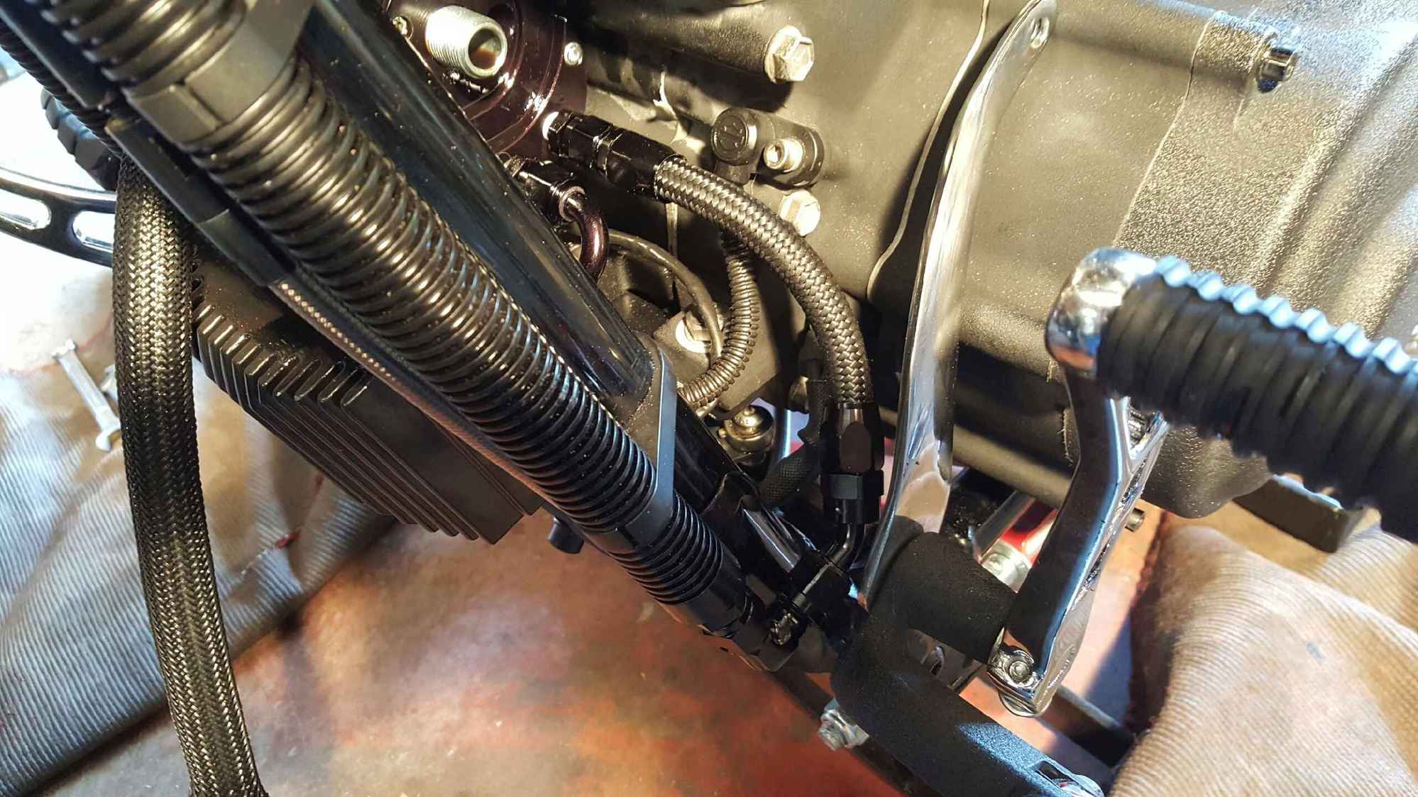

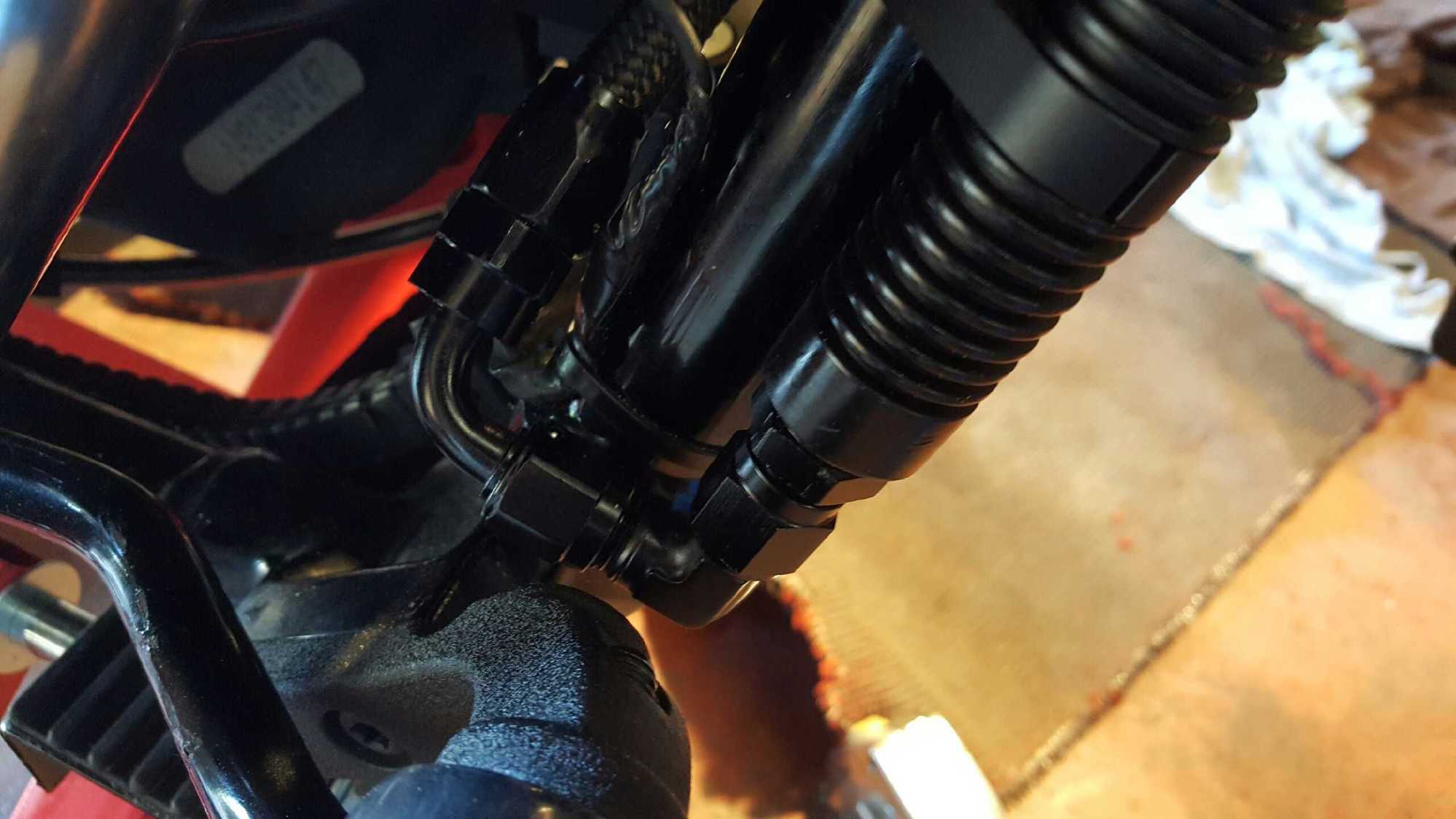

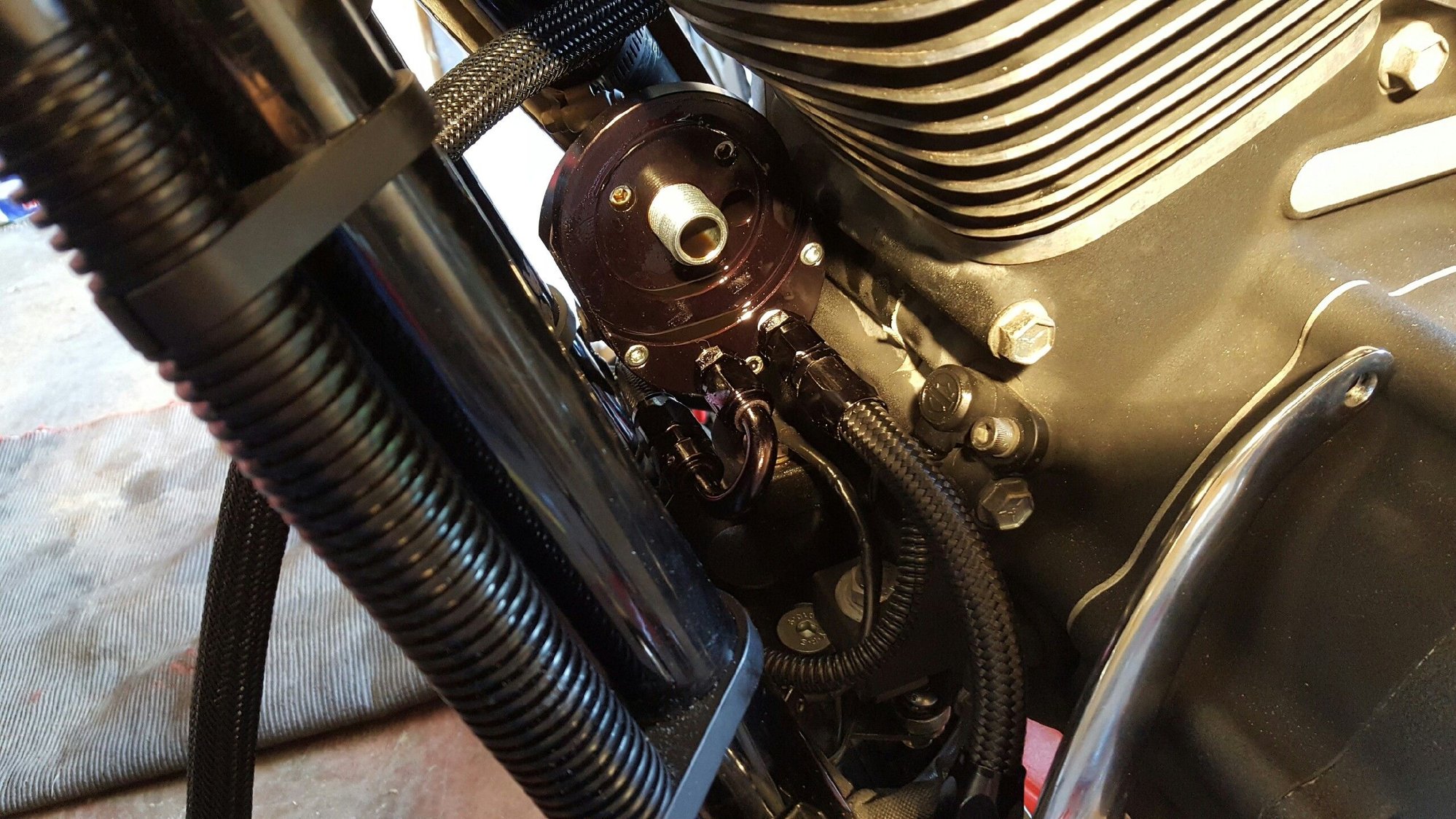

Here's some eye candy
Ghost
Left side return to the oil off set - plumbed
Second shot of the left side
Right side return to the oil offset - plumbed
Second shot of the right side
The complete system (final configuration)
Second shot of the complete system (final configuration)
Them last two PITA hoses need to complete the plumbing
Current configuration - ready for initial (baseline) Temp test
