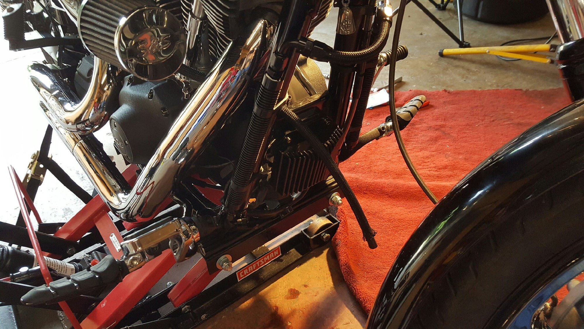

Why it necessary I moved the jack's cross member rearward
Initial view of the oil filter that's fixin to get the oil offset
Removed the shift linkage - now it can be accessed
Oil filter removed
Oil filter still removed

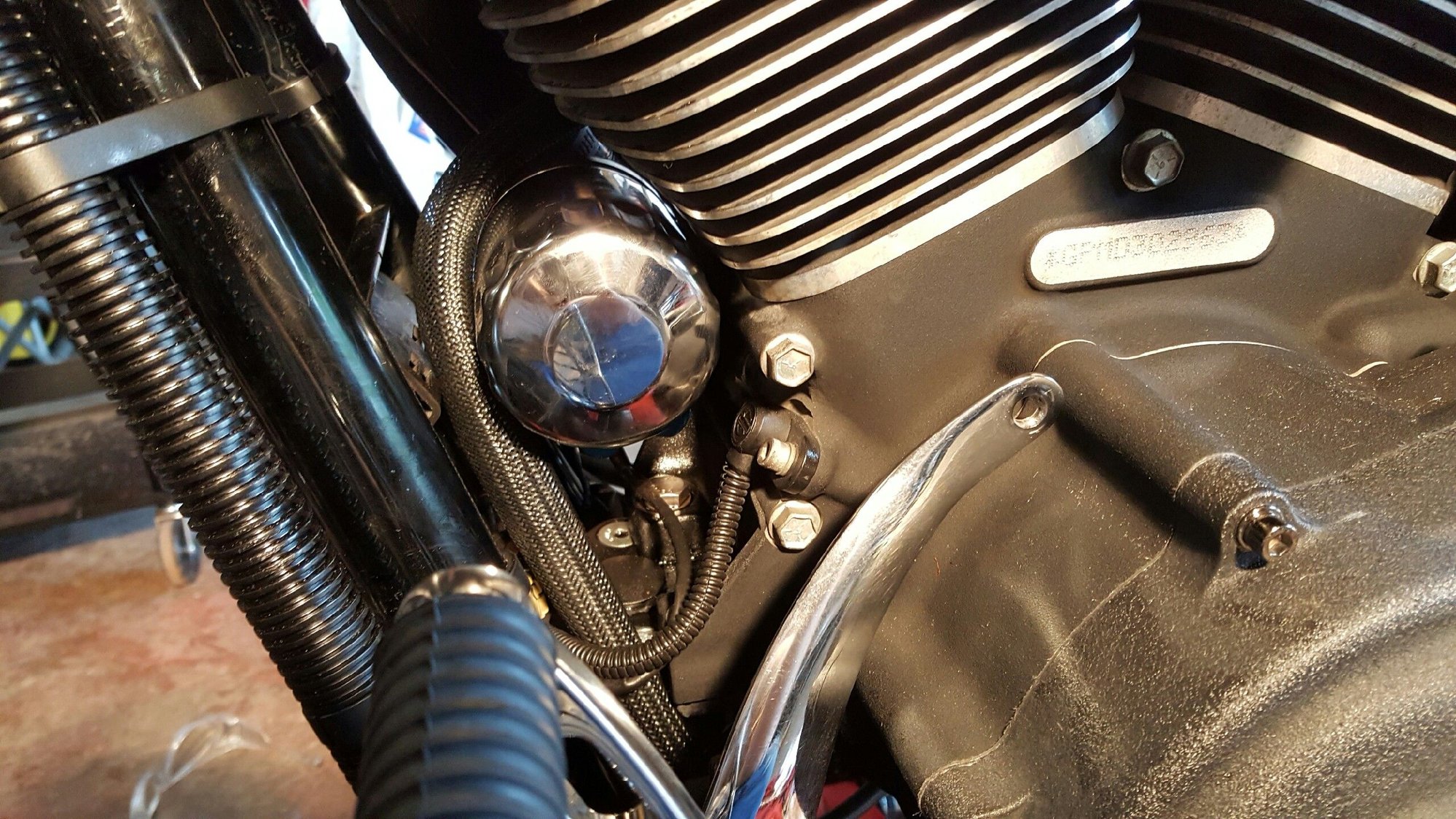

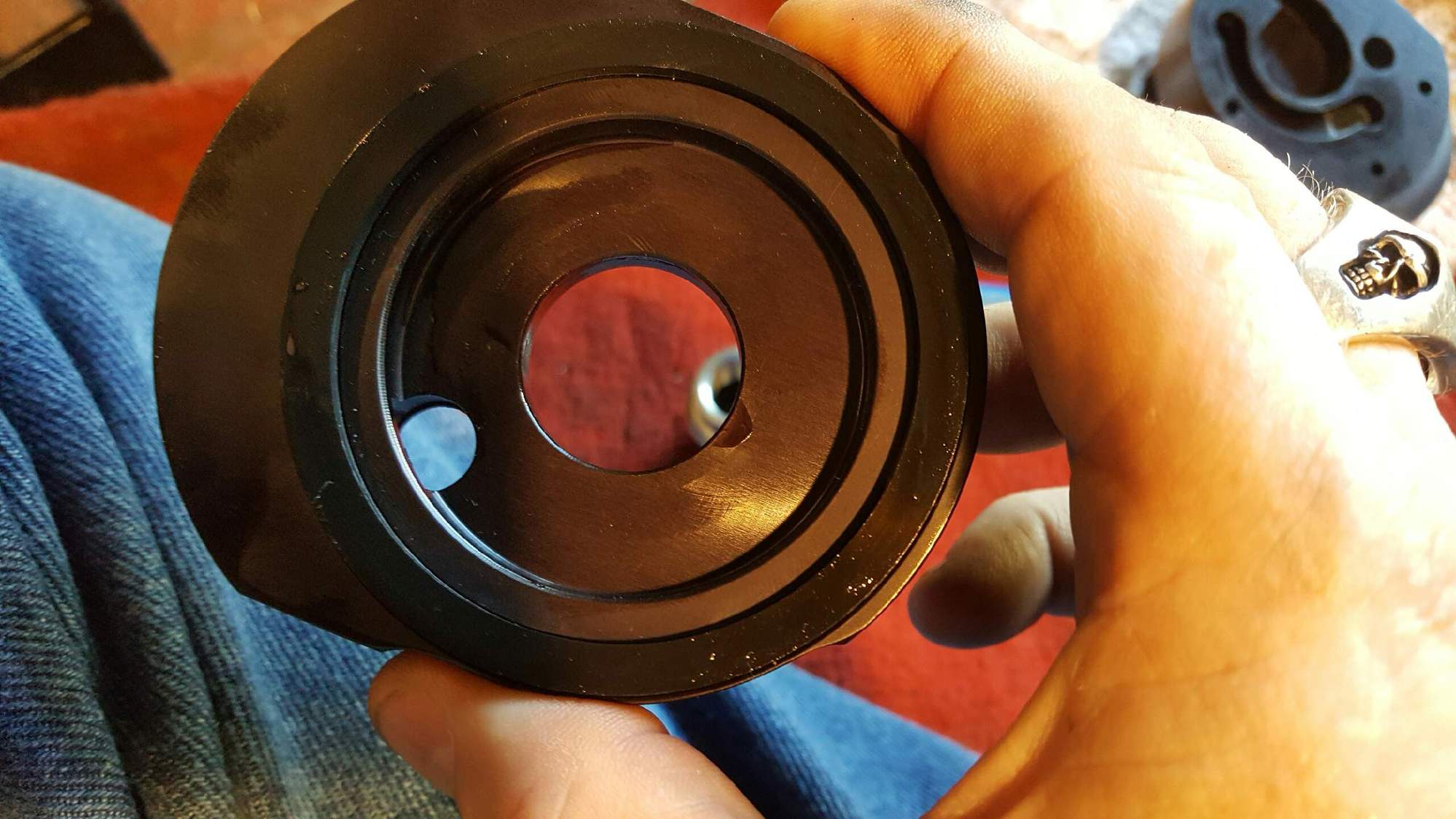

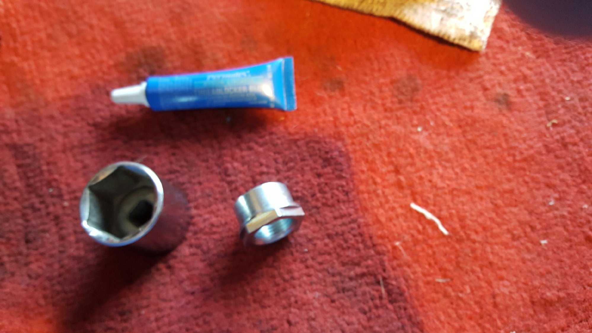

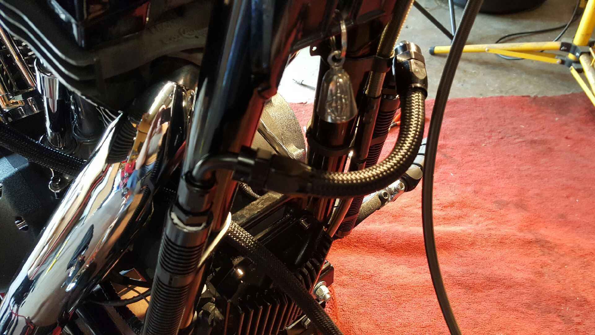

Installing the oil offset..., reinstalling the original filter..., capping the ANs..., then checking for leaks
Ghost
Blue locktight is your friend - This the 1" nut that secures the oil offset
Oiling the offset gasket - those are air bubbles.., not contaminants on the gasket
Off set installed and capped
Scooter is running in this shot - no leaks - quiet bitch ain't it

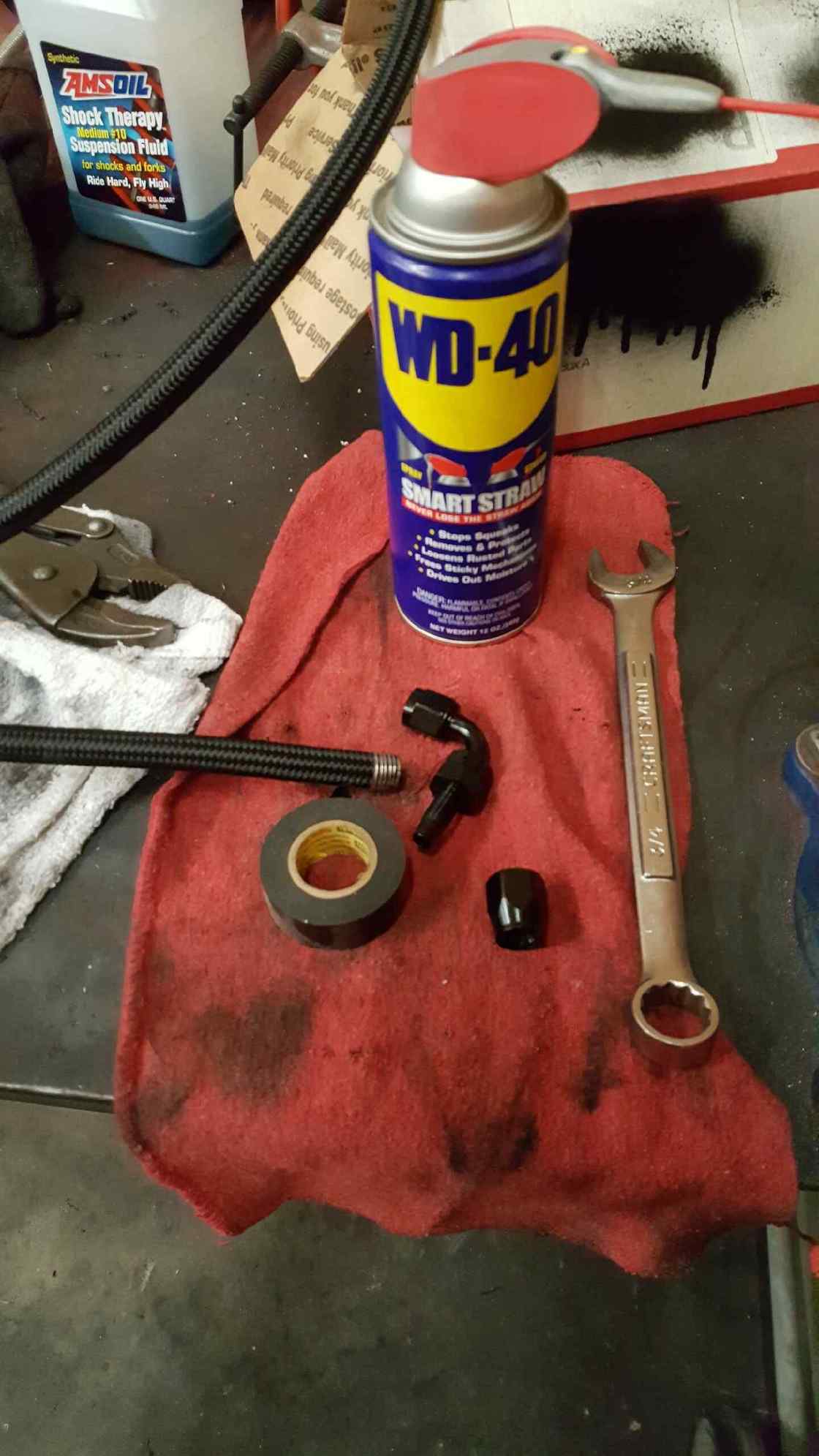

Building ANs
I've heard some say they're hard..., other say you must have special tools
BS - keep it simple - it is simple
Ghost

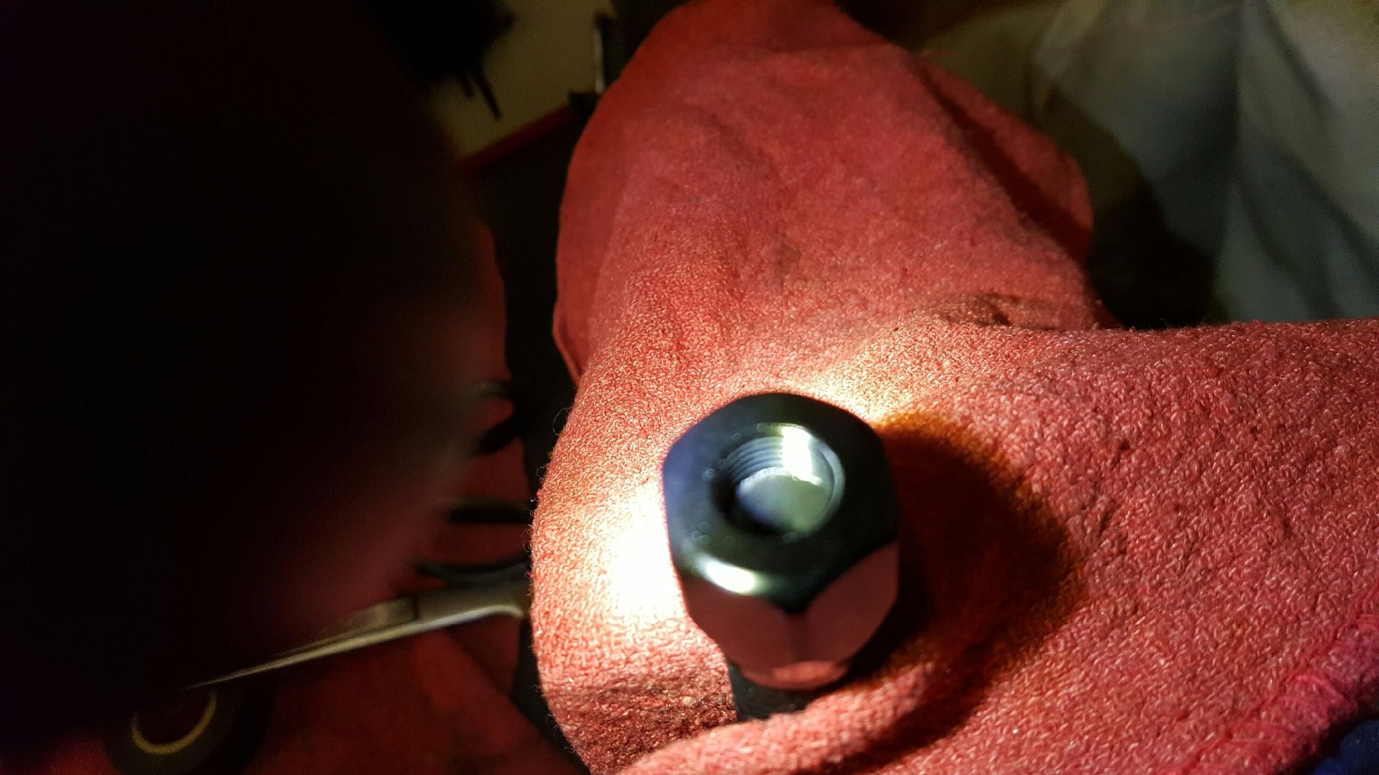

Tube end on the left..., Tube nut on the right

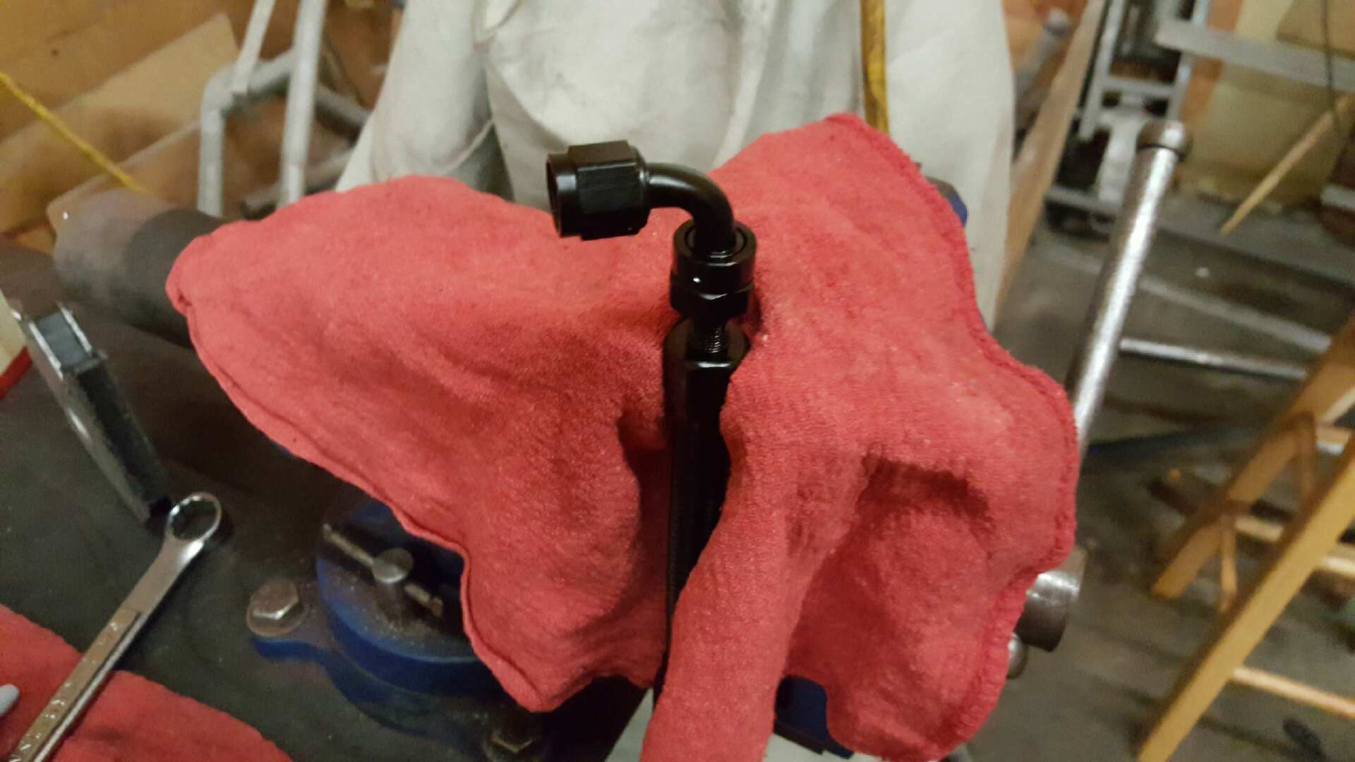

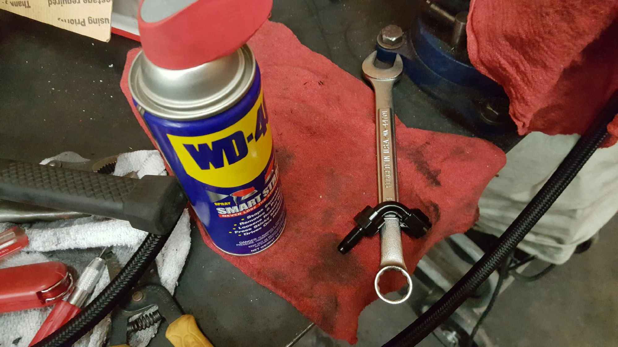

What's needed to make ANs (1) Sharp hacksaw (2) Electrical tape (3) WD40 - or silicone spray (4) Wrench (5) Bench vise..., or another wrench (6) Hose and connector
WD really is your friend
The hose nut screws onto the AN hose until fully seated - use WD40 to help make it easier to get the hose fully seated
Important note:
Once the hose is fully seated into the hose nut - never twist the hose nut again while assembling
Doing so will F up the integrity of the connection

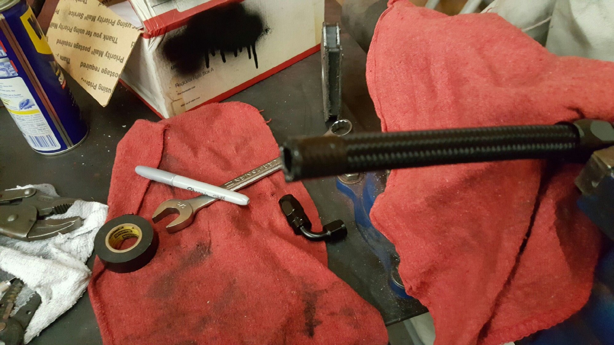

ANs cont.
Ghost
Inserted hose end..., into hose nut..., after hose fully seated into hose nut
Hold the hose nut stationary - while tightening hose end into hose nut - spray WD40 onto hose end..., to help it seat into hose / hose nut
One end completed - measuring / marking in preparation to make other end - for proper length - mark hose where the hose nut meets the hose end

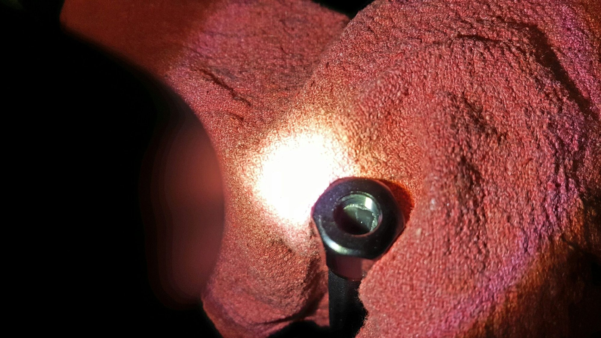

Use electrical tape - and tightly wrap on each side of the line to cut - tape keeps the shield from unraveling and becoming an unmanagable rats nest - that cannot be inserted into the hose end..., it also keeps wire secure and not sticking your finger - which hurts like hell
Notice how neat this just cut end - is

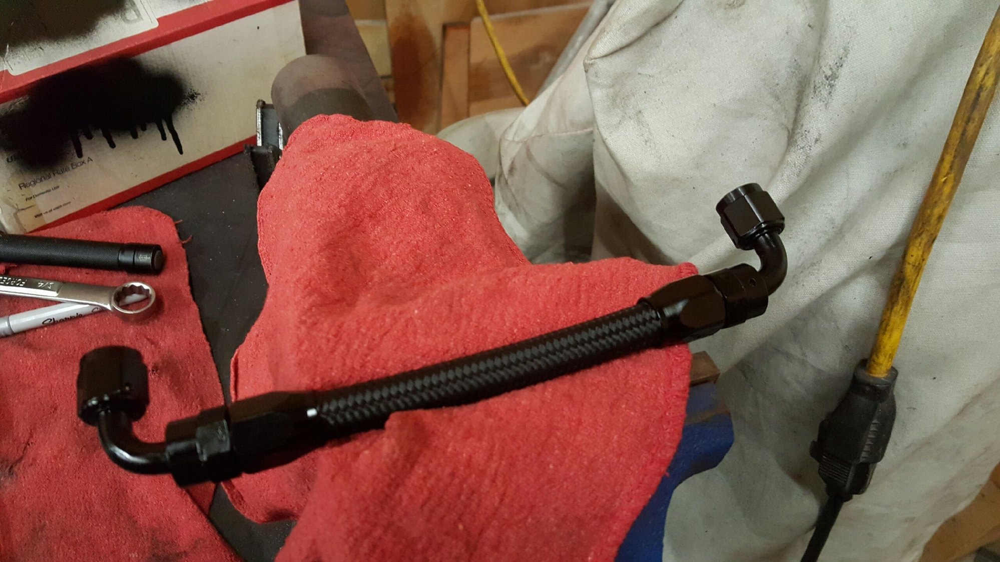

Ghost
Fully inserted hose into hose end - for the other end just cut
Tighten the hose end like before - one completed AN hose

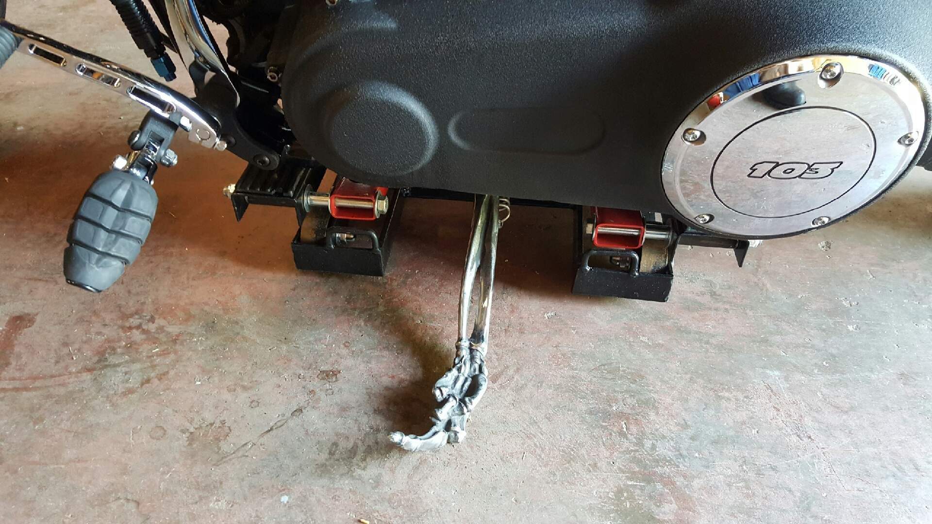

Damn - the hose is the correct length - how the hell did that happen

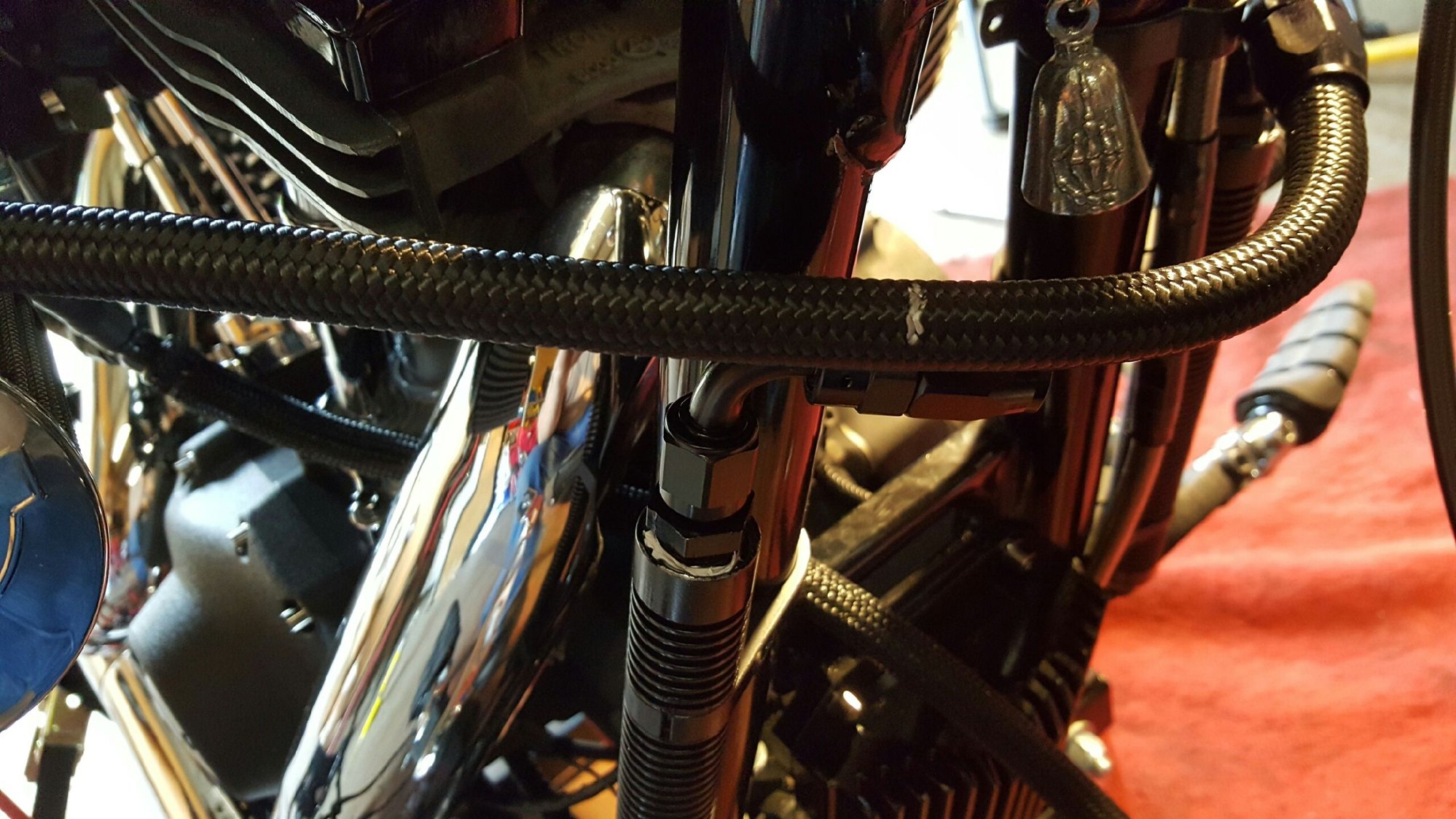

Top X connect hose is installed - and clutch cable re-installed

Originally Posted by Ghost_13
Is your front fender going to hit that hose when you hit a big bump?

The vertical tubes blend in much more than I thought they would.
Looking forward to reading your results and appreciate the effort taken in your approach.
