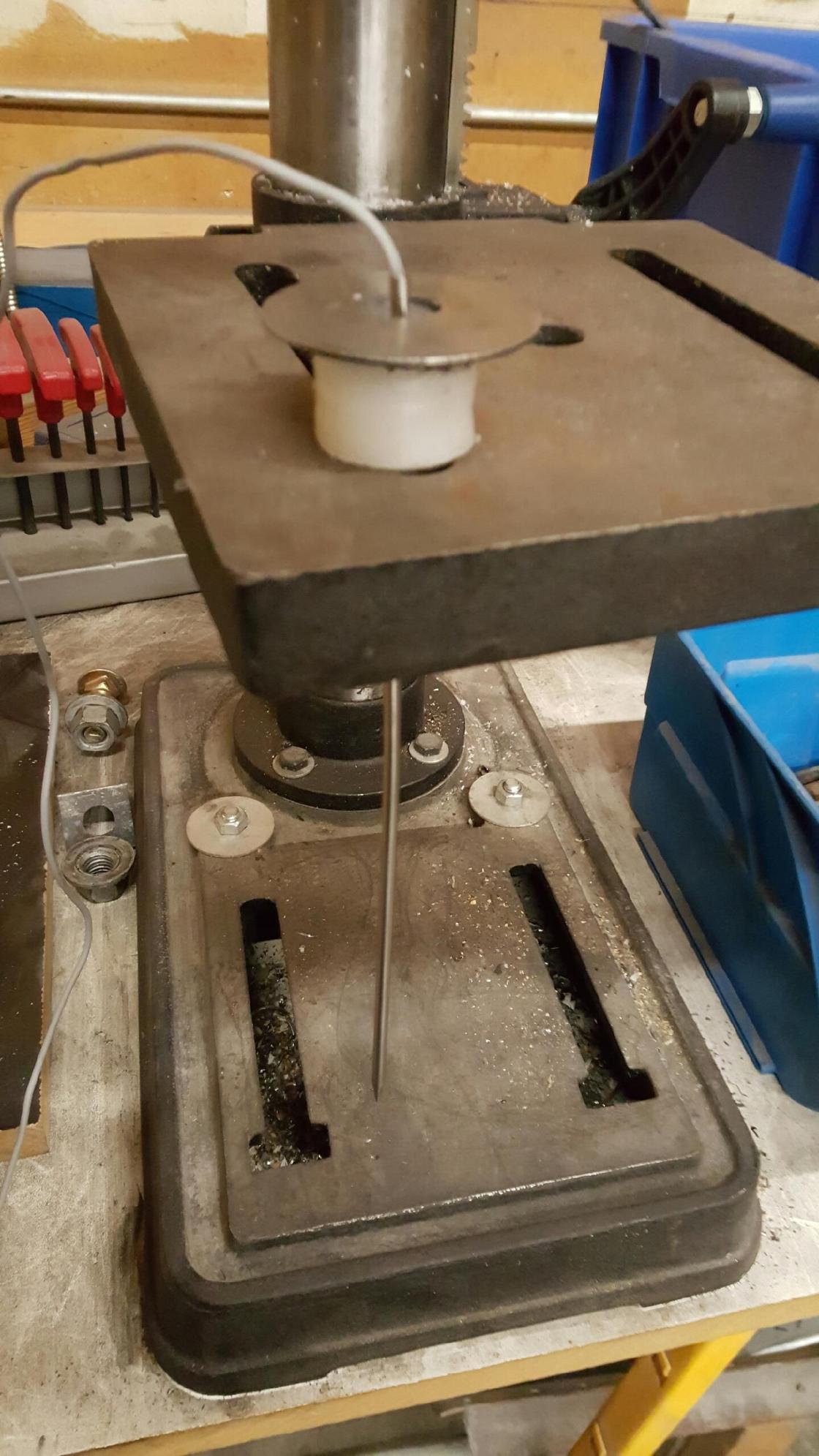

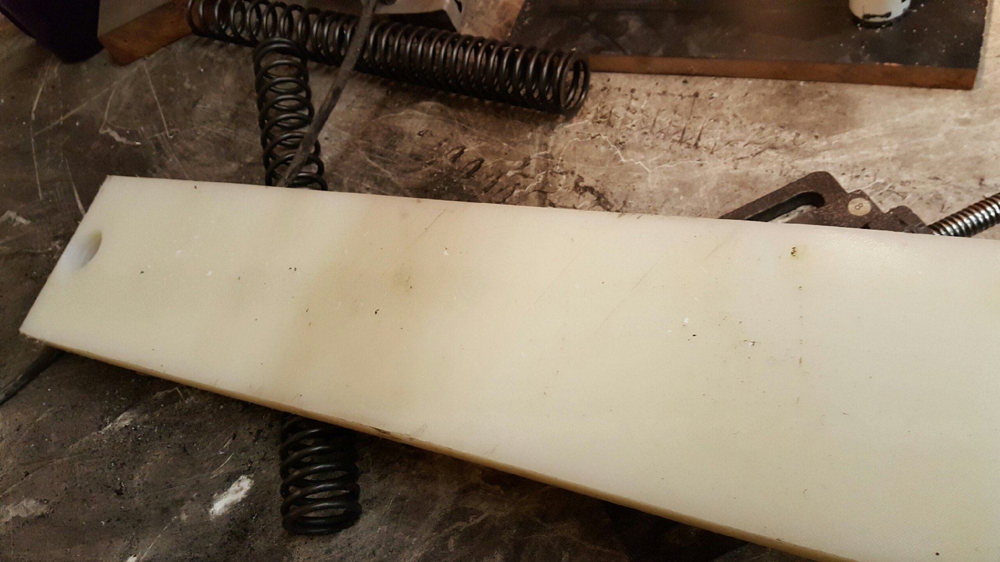

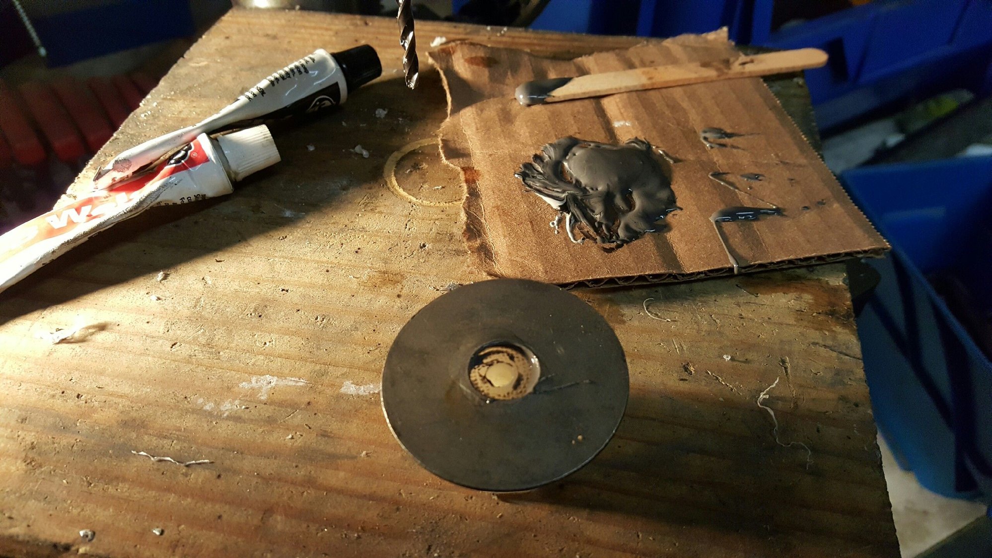

Making an oil fill plug for the temp probe
Questions - fire away
Ghost
Cutting board - or what's left of one
jb weld still curing

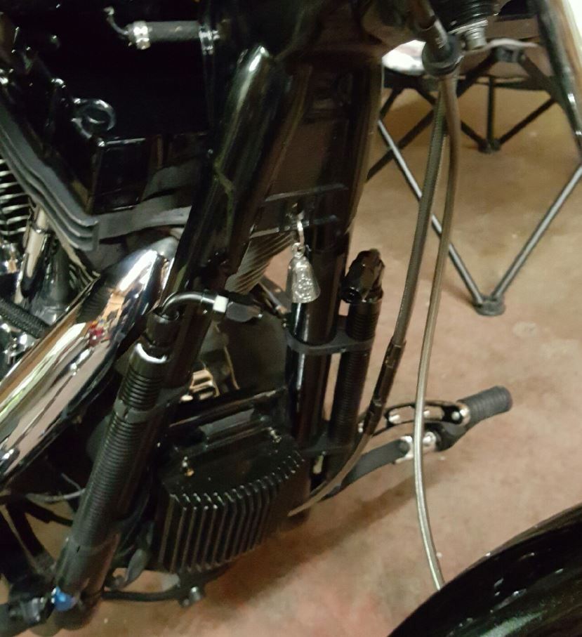

Toyed w/ tube mounting - straight forward on the down tubes.., 45' out..., or 90' out
Think I've decided going w/ 45'
Tomorrow - install the oil offset and build AN hoses - pics to follow

Might be interesting to tie some streamers to the forks or frame and see where the air goes to help determine location.
I do like the 45 for appearance.
Are you running the tubes oil flow in parallel or series?
Series
Oil exits the Offset - enters one tub's end - traverses the tube - exits - enter the other tube - traverses it - exits - returns to the oil offset
Ghost

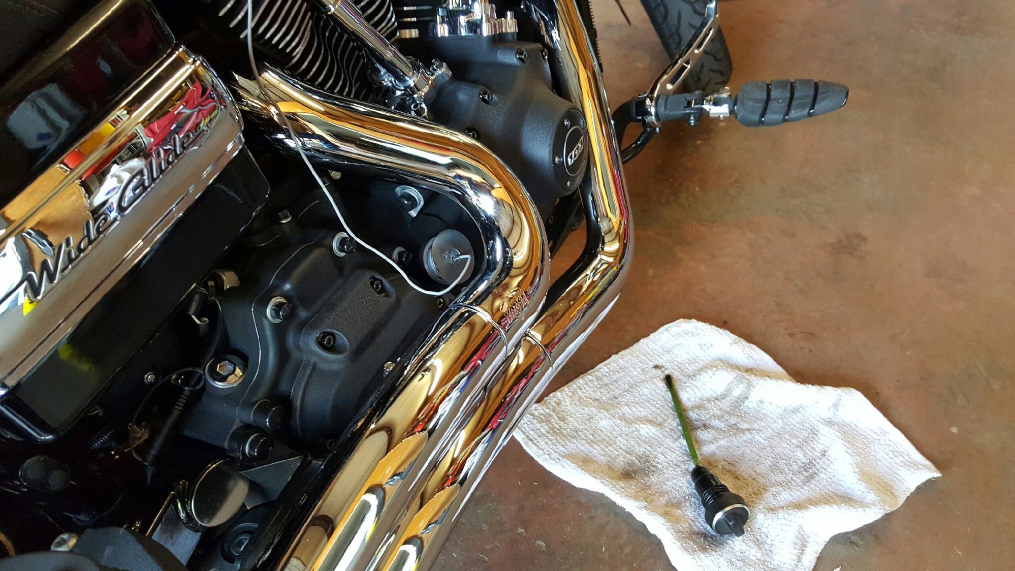

Oil fill plug works
Ghost
