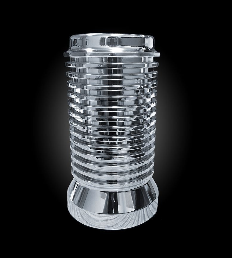

Ghost, look what I found...
Extended length oil filter. About twice the surface area of the standard washable...
It's a little insanely priced at $350, but if you want every little bit of oil cooling, there you go...
Plus you get an extra half pint of oil volume in the system! And probably that much less parasitic drag on the oil filter due to the large surface area of the filter.

Oh sure, go ahead and post that image Got a link? My wicked little brain is already trying to figure out how to get that beast to work with my oil filter relocation and the +3" extended shift rod

For you, of course...
http://www.cyclesolutionsonline.com/S69C.htm
There a mid sized one too!

The ******* Micronic Oil Filter S69
Oh damn! Now that's some marketing winning

The ONE thing I don't particularly like is the lack of a wrenching point on the bottom. Got to use their adapter to remove. I may stick with the DK customs version, which as I understand is the same K&P element in different housing. No special tool needed for removal. Unless its a standard filter wrench. Hmmm....
EDIT: Just called K&P - It's a standard wrench size, just not for a Harley. 68mm x 14 flats. Available at parts stores though. Thats always good in case it disappears.
That's what I noticed as well; I like the 17mm machined on hex on the billet housing of my PCS4C; the PCS4C is identical to the DK offering and they both use the K&P stainless steel mesh filter element. I did a bit of measuring and I'd have one hell of a time fitting that beastie
