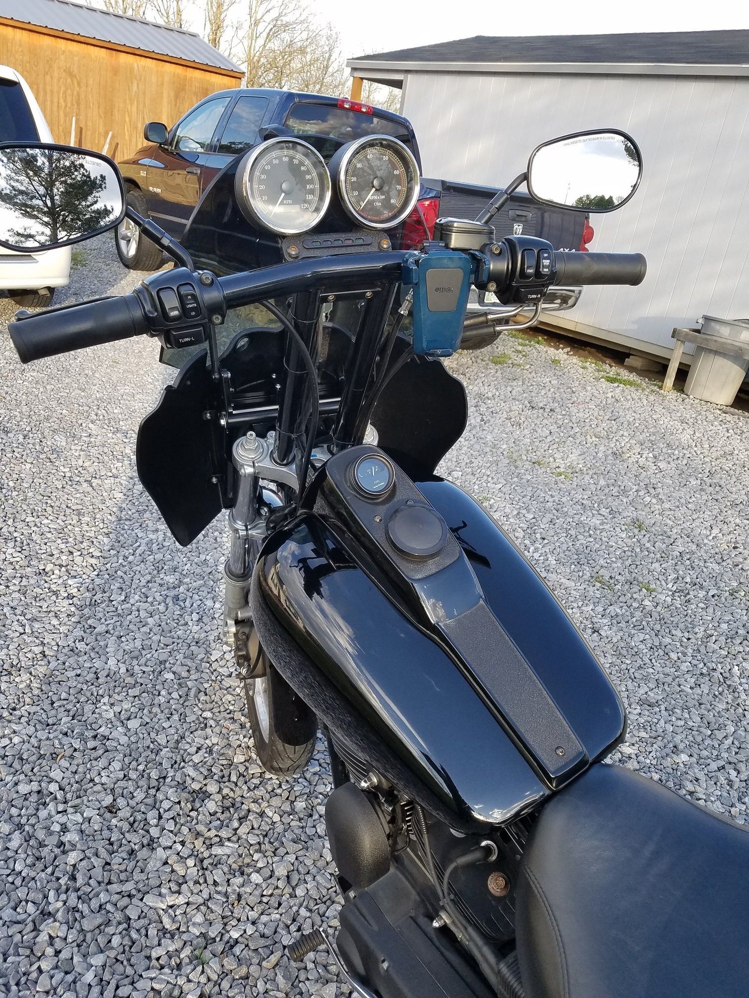

Food for thought here...
I built an FXDXT style based on an '01 FXDWG frame specifically to get the extra rake of the wide glide frame.
The rake makes the bike a little less "flickable" but it greatly improves the highway speed stability.
The bike handles magnificently in the twisties and is rock steady on the highway.
I have ridden this bike many miles at 100+ MPH and have never had even a hint of a wobble.

greezy
do you notice any difference spacing your shield out like that?
Old Jul 1, 2017 | 07:44 AM
Greezey Rider's Avatar
Greezey Rider
Joined: Apr 2014
Posts: 6,322
Likes: 2,500
From: Tennessee
Originally Posted by hell hound
greezy
It's not on spacers, it's a DevFab repop with the OEM style gearbox.
I have run it both ways and I prefer the setting you see in the pics....Pretty much eliminates any buffeting.
I'm thinking of getting a windshield with a recurve, just to see if it makes a difference.
