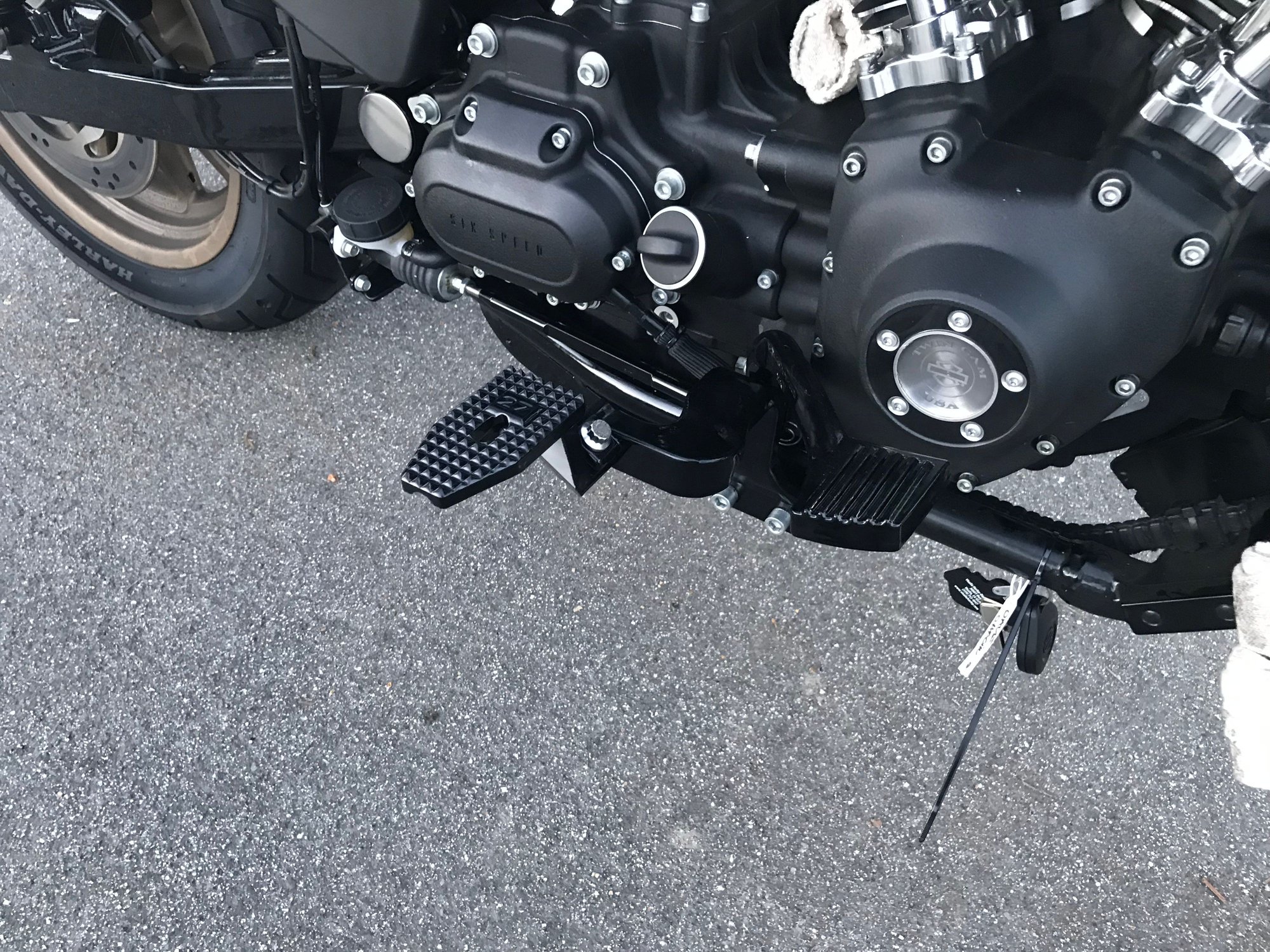

This was a ton of work to get this all good. The 10" Kraus risers went in the mill about 10 times to get the Big Al's Cycle Low-Low Bar to fit correctly. Kraus just came out with the gauge adapter. While I'm not using them, I did not want to see a bunch of holes in the gauge mount, so I found a clean idiot light bar. Some of the pieces are obsolete. The switches on the clutch side are for separately manually turning off the headlights and rear license plate lights.

With the combined 1/2" rise on Bayland mounts and 1 1/2" rise on the 27 Cycles pegs, it will take a lot of lean angle to grind these puppies.

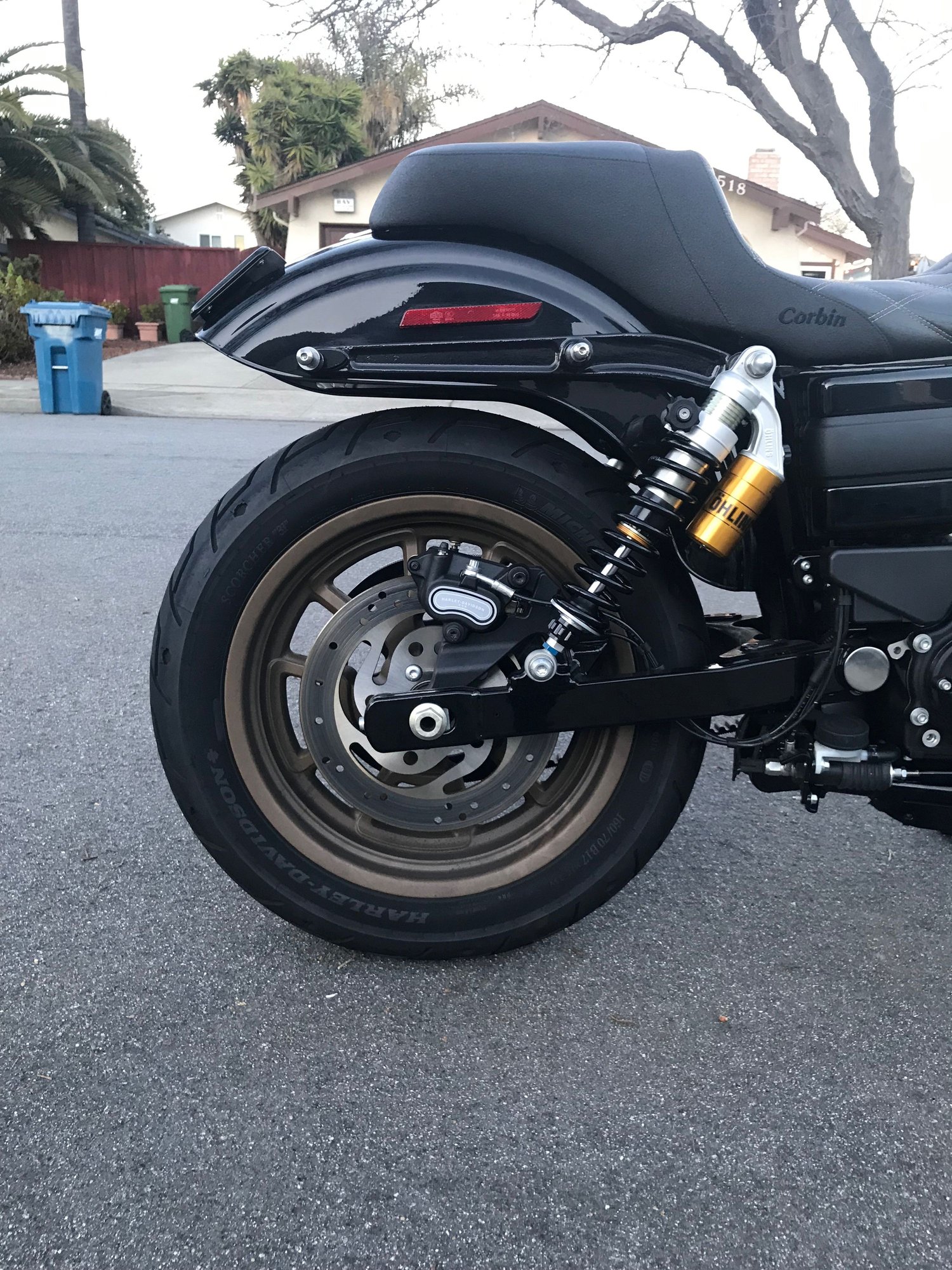

Oh yeah, THE GAP!!! This is complements of Howard's 14" shocks.

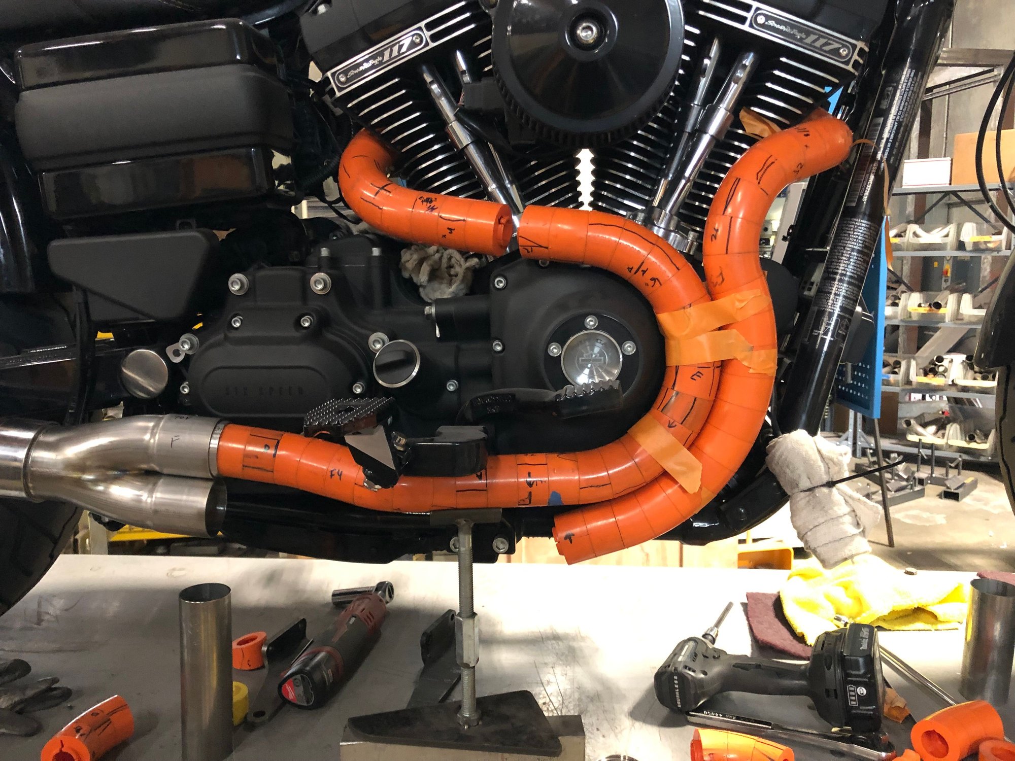

Teaser pic of the designing of the exhaust. Should be finished by end of next week.

Just curious if you have installed the rear Sputhe stabilizer yet?
I am going to do the install on my bike this weekend which also has 14” shocks, but I am just worried after I did a “mock up” and noticed how tight the wire loom is between the swingarm and the bracket.
Worse case true track actually sells a bracket that drops down and is designed for bikes with taller shocks but I don’t really want to go that route if I don’t need to.
Old Mar 8, 2019 | 06:49 AM
  #40
misfitJason's Avatar
misfitJason
Joined: Dec 2010
Posts: 6,849
Likes: 1,389
From: Florida
I have the longer bracket for the true track. It doesn't drop down. It is just longer. My 13 1/2 inch shocks make the bracket hit the swingarm almost when the bike is on the lift and no weight
