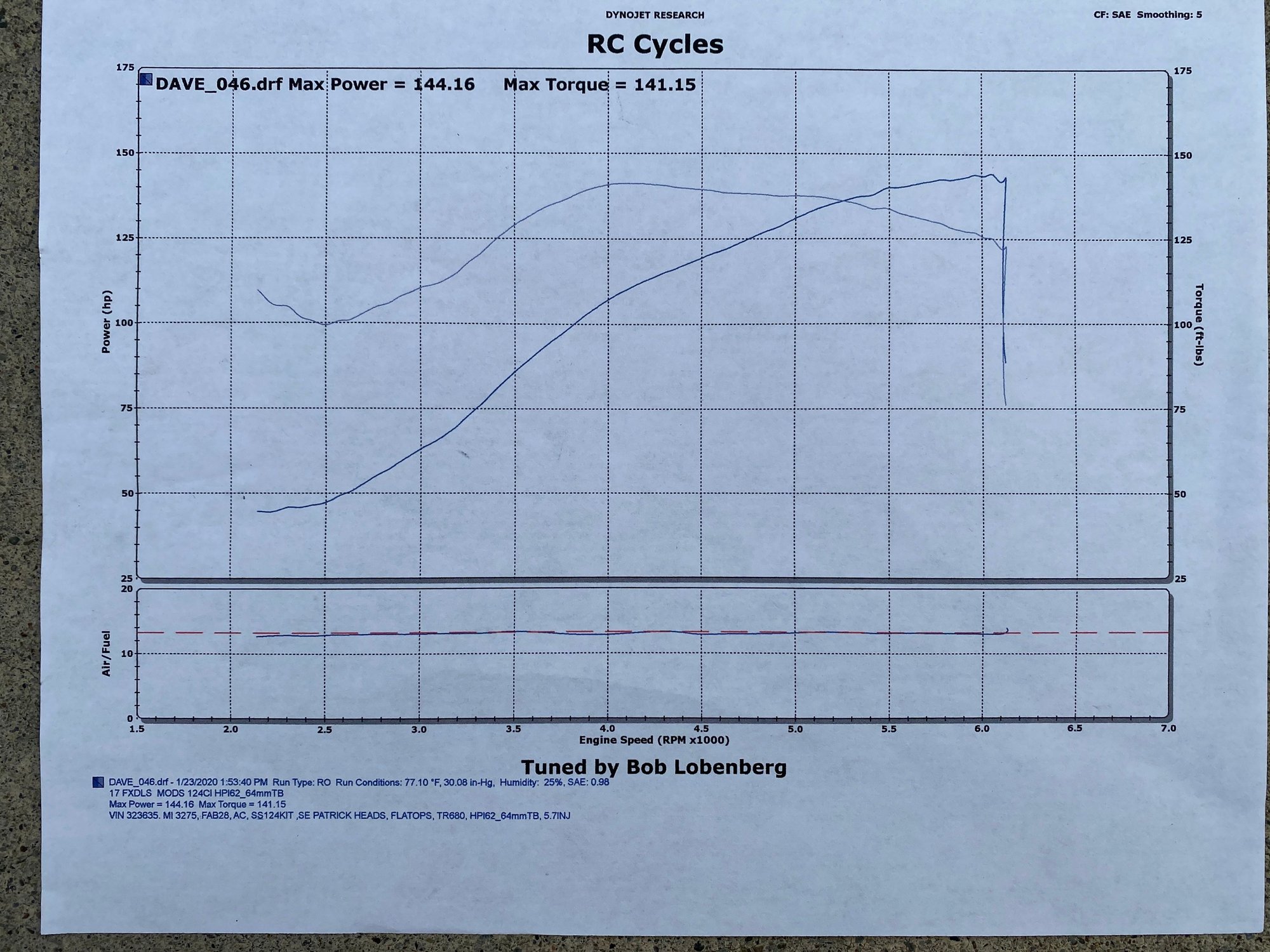

Got the motor dyne'ed:
For Mud, list of components:
3" K&N filter
S&S Stealth Air Cleaner Assembly
HPI 64mm Intake
5.7 Injectors
Patrick Racing Full Porting of 110 Castings
S&S 4.125" Cylinders
S&S Flat top pistons
S&S Race Shop 4.625" Flywheel Assembly balanced and assembled at S&S
T-man 680 PS-1 Cam
S&S Premium Lifters
Timken Conversion
TTS Tuner
Fab 28 Custom Exhaust with 1-7/8 to 2" Primary tubes
Custom Screamin' Eagle 124 cylinder head badges that add 5 hp
Before Fab 28 did the exhaust, I had a V-Rod Thunderheader muffler modified and was going to have Fab 28 incorporate it into their exhaust. After Fab 28 showed me how light their muffler was, I went with theirs. RC Cycles is used to seeing over 150/150 with the above components, and they are thinking the Fab 28 muffler is killing some power. In about a week, they are going to slip on the modified Thunderheader muffler to see if the motor picks up in power. If it does, I'm going to see if Fab 28 can make a custom muffler that mimics the Thunderheader muffler, but lighter.

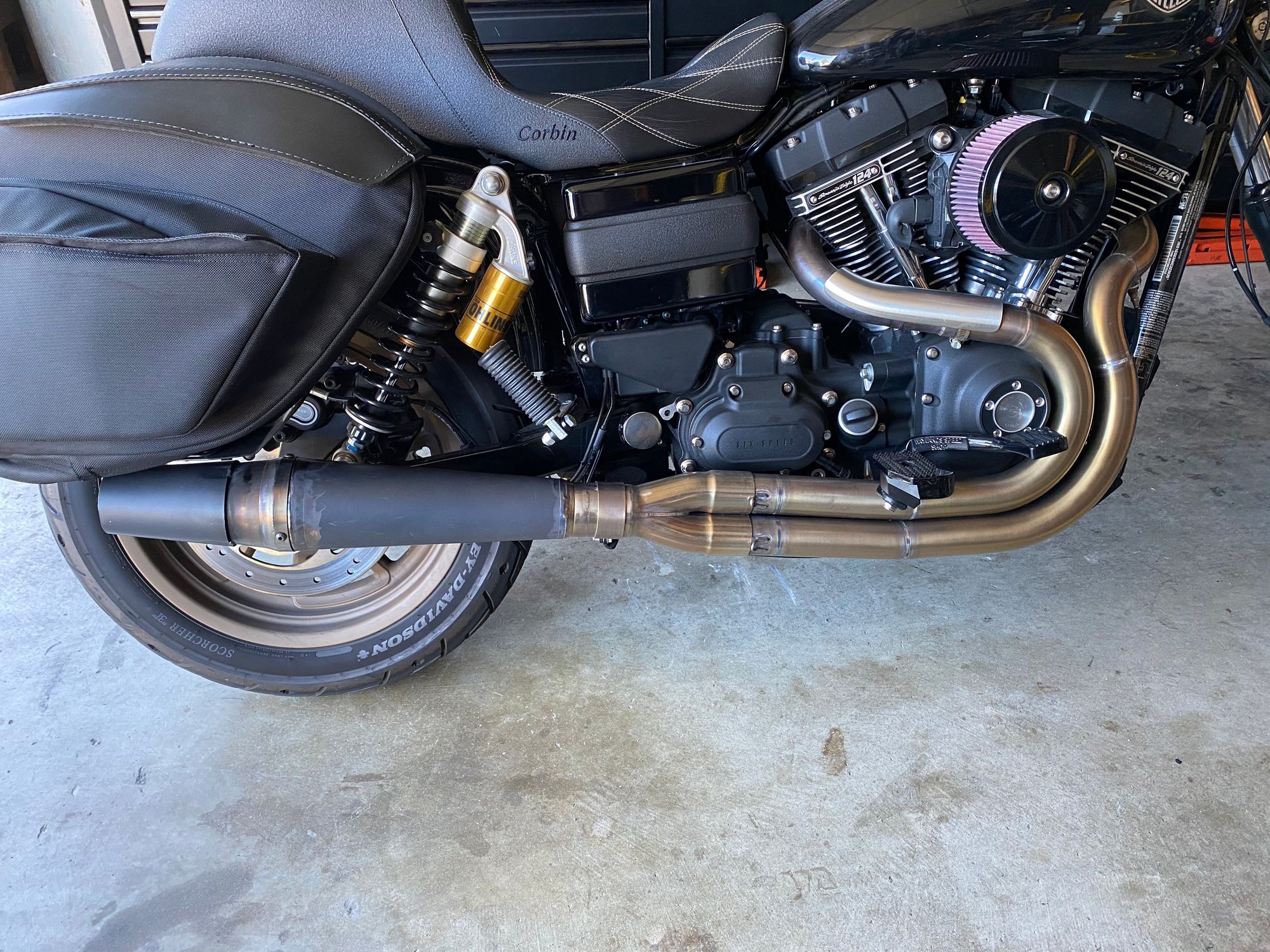

Picked up the bike today:

The good news: The modified V-Rod Thunderheader muffler took away the big dip. I can definitely feel the difference riding the bike. The bike is comfortable cruising now between 2,500 and 3,500 rpm. Before, I can only describe it as surging, like it wanted to cruise at minimum 4,000 rpm. It also took away the "getting on the cam" feeling. The power is more linear now. Looks like the old-school Thunderheader muffler is still king compared to the smaller mufflers, albeit heavier. Also note the starting rpm, for a 144 hp monster, it has a ton of torque at the low low end.
The bad news: The exhaust was originally built for the 117, and now it is too small for the 124. The 1-7/8 to 2" primaries are holding the horsepower and torque down. Looks like another exhaust down the line.
